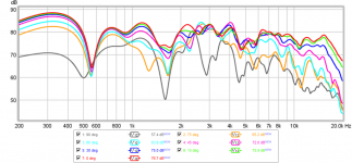

To remind you of what a K-aperture can do for polar response, take a look at the data from the XKi (5dB variation over 45 deg off axis up to 10kHz):

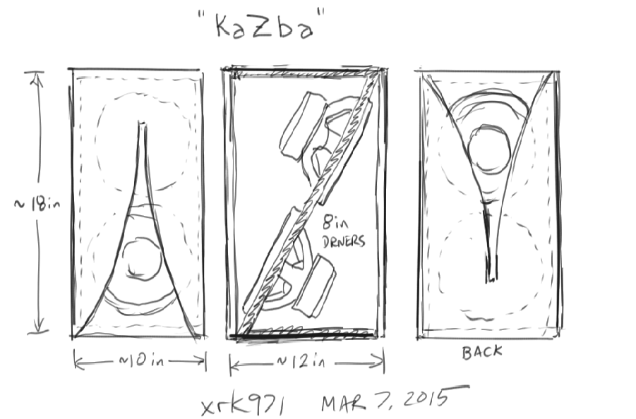

So here is the general concept of the Karlson-aperture Z-baffle dipole, or KaZba Dipole. The Z configuration provides a couple of advantages: angles the driver relative to the K-aperture to reduce resonances, makes the structure stiffer with a big inherent brace, allows the mounting of a second driver in push-pull to reduce 2nd order suspension hysteresis harmonic distortion, and just plain looks cool.
So this can be implemented with a pair of full range drivers of any size really, but since we want some semblence of real bass, I am going for 8in drivers. I will be using woofers for the prototype - I am picking some relatively low cost units and so found these buyout 8in units from PE (5 mm xmax, 88dB, 8ohms, is not bad and moderate Qts and $10 ea - the price is right) http://www.parts-express.com/wfr800gs-8-poly-cone-rubber-surround-woofer-8-ohm--299-343. To this, I will add a whammy of an upper end dipole - where it makes all the difference: a Heil ESS AMT. The Heil AMT is a world-class tweeter that is almost full range, able to go as low as 600Hz. I will probably cross at about 750Hz in a 2-way. The KaZba, hopefully, will provide a nice wide bandwidth and smooth response up to well past 1kHz and be an excellent match. The woofers will be driven in parallel so sensitivity should be about 94dB at 2.83v.
![470112d1425731040-rockin-kazba-dipole-k-aperture-z-baffle-dipole-kazba-sketch1.png](https://www.diyaudio.com/forums/attachments/full-range/470112d1425731040-rockin-kazba-dipole-k-aperture-z-baffle-dipole-kazba-sketch1.png)

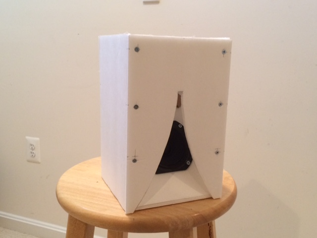

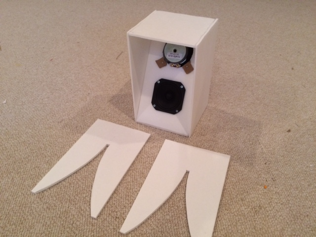

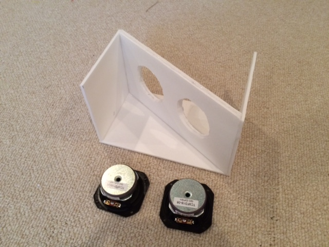

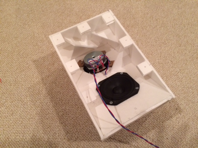

Before making a big one for the dual 8 inchers, I am building a small prototype in FC for the TC9FD, called the mini KaZba. This will not have any bass as it is scaled way small, but will give me some practice in the construction and also to model it in Akabak so that I can optimize the chamber volumes and Karlson aperture cross sectional areas for optimum performance.
There is a lot of air pressure - need to double up layers as it is rattling now...
Added bracing and some stuffing
I added lots of little 90deg corner angles to brace the walls and reduce rattling and vibrations. I also doubled up the K-aperture with two sheets of FC glued together. This worked pretty well, and then added some fiberglass stuffing behind the magnets of the drivers to help absorb some chamber reflections.

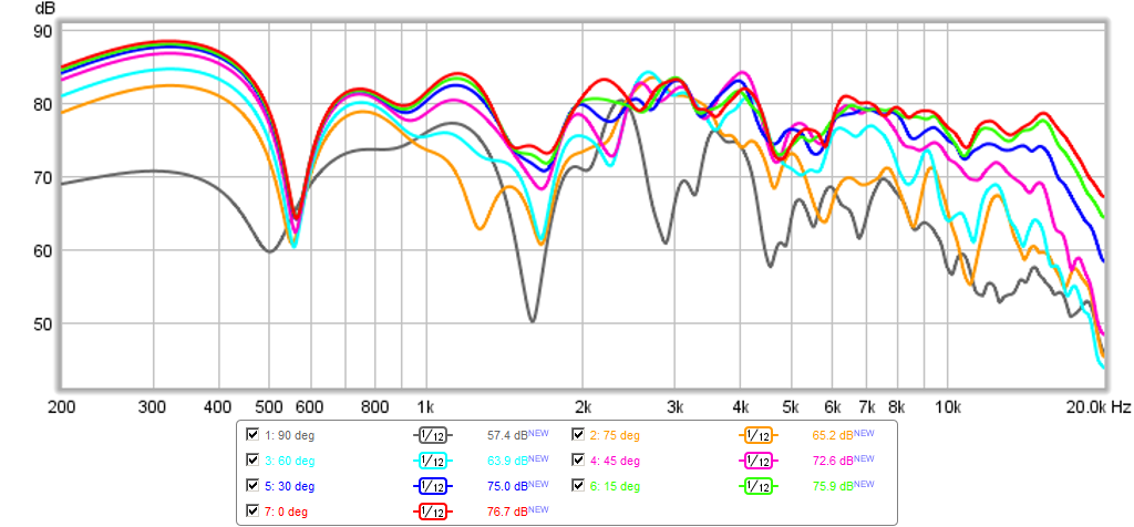

How does the dipole work? In a dipole box this small, there is not enough of a baffle distance to get any bass - there is some but it starts falling off below 200Hz. The K-aperture combined with the chamber reflections and some of the bracing is creating a lot of dips in the response. I took some polar data and the box seems to be doing its thing, frequency dips, notwithstanding. What is there, is following what I expected for the polar response from a K: uniform over 5dB up to 45 deg off axis up to about 10kHz. The dipole effect can be seen with a fairly uniform 20dB attenuation at 90deg off axis. The data shown is at 0.5m with a gate of 1ms before and 4ms after for a resolution of 200Hz and stuff above 400Hz is good.

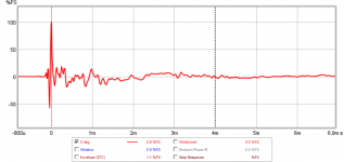

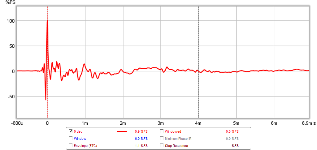

Here is the impulse response from the 0 deg case:

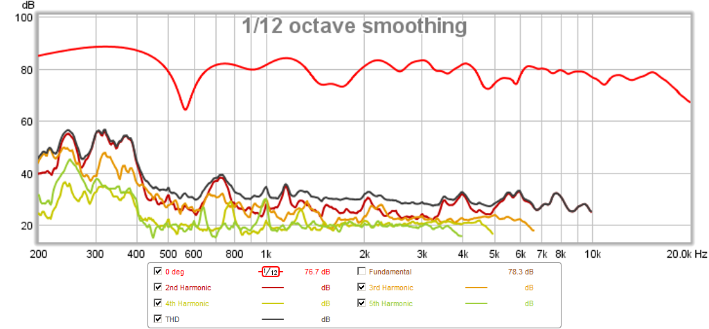

Here is the harmonic distortion from the 0 deg case:
This quick FC study is giving me some good lessons learned for the real build with the 8in drivers. I tried listening to this speaker, and it sounds surprisingly good with the some female vocals and jazz despite the several deep notches in the response. What is good is the uniformity of the sound as I walk around the room, or behind it. Just directly to the side, the response is very low as expected.
![470277d1425798133-rockin-kazba-dipole-k-aperture-z-baffle-dipole-kazba-tcc9fd-polar.png](https://www.diyaudio.com/forums/attachments/full-range/470277d1425798133-rockin-kazba-dipole-k-aperture-z-baffle-dipole-kazba-tcc9fd-polar.png)
![470279d1425798133-rockin-kazba-dipole-k-aperture-z-baffle-dipole-kazba-tcc9fd-hd.png](https://www.diyaudio.com/forums/attachments/full-range/470279d1425798133-rockin-kazba-dipole-k-aperture-z-baffle-dipole-kazba-tcc9fd-hd.png)
Very different than 0.53x K'nator which has lots of bass down to 50Hz. This is. Dipole so that is to be expected. The front cavity dips seem to be be worse than K'nator as that box was bigger and drivers were smaller relative to K aperture area. I never made the dual Vifa KaZba with intention of thinking it can compete with sound of K'nator. It really was a quick proto build for me to get some experience with potential issues when making the large one with dual 8in drivers.
