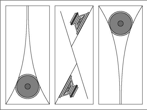

What about orienting the dual 18in facing each other in push pull sort of like typical slot loading setup (allows narrow front profile) and having K aperture facing front for where slot would normally be? Backside could also go through similar K aperture from a manifold box.
Thanks for pointing me out to Freddi's earlier thread on K dipole and Ron E's very similar design. His does not have the Z so can't be called a KaZba 😀. It was Freddi who gave me the idea and inspiration for the K dipole as well.
I never built a proof of concept, but I'll call conceptual "prior art" on this one. 😉 Probably have a few more nutso sketches in my old Imageshack account.

Nice work IG! Yours is actually a vented OB with the rear chamber on one going into a vented chamber on the other side. Interesting - should have more bass, I think.
I must have been thinking along these lines when I drew this up. Probably was for FF125K and did not require too large a Vb nor low a Fb. I never fleshed out the concept more.
Yeah, we discussed this concept on several occasions on Gregg Baker's (eeehaah) old forum. At least a couple people have tried various K/OB hybrids, AFAIK.
What I am most curious about is would there be any excursion reduction compared to a equivalently sized unfolded OB, or another folded type like an H baffle.

I was thinking a single 15", in sort of a shallow Klam. There wouldn't be 2nd harmonic cancellation of the double driver dipole, but nevertheless I think it'd be worth a try sometime. Never got around to it myself. This was in part inspired by Magnetar's 'Rosie'. Here was my idea posted a few years ago:
Ah, more interesting ideas are popping up 😀
Greg's shallow Klam makes me think, how the orientation of the baffle's slant (related to aperture) influence the sound?
I mean, in a (normal) Karlson, the baffle's slant makes the shallowest point (of the cavity) pointing at the widest part of the aperture. In a Klam, it's the opposite -- the deepest point of cavity is in line with the biggest opening.
And, how do we define the path length for the resonance of 1/4 lambda? Or is this the wrong question?

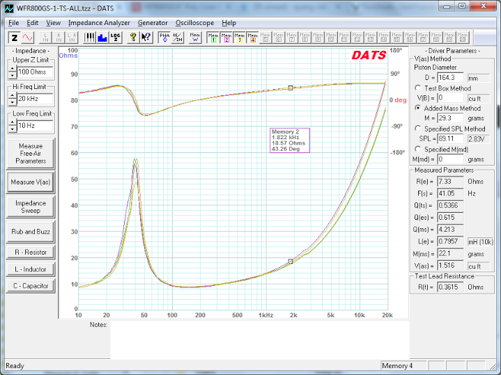

These $10 buyout 8 inch woofers from PE (I believe they are "Bravox" brand as that is the box they came in) arrived. They have a cheap look and feel to them as can be expected for a $10 8 inch driver, but they measure very closely to advertised specs on PE website. All four units were pretty consistent with about 89 dB sensitivity, about 37 to 40 Hz fs, and Qts of 0.51 to 0.54 and Vas of about 1.5 cu ft. I think they should work well for the KaZba. Now I have some good TS params to start modeling in Akabak.
http://www.parts-express.com/wfr800gs-8-poly-cone-rubber-surround-woofer-8-ohm--299-343
Here is the DATS v2 screenshot:

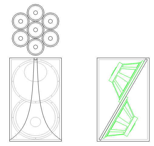

This is what I have in mind, more or less.
2 x 18" in the KaZba with 1+6 planar array of 6.5" (would be too large if I go 8").
It might work if you high-passed the center of the flower, and low-passed the petals. Even then, you'd have some lobing issues, but it might be fun.

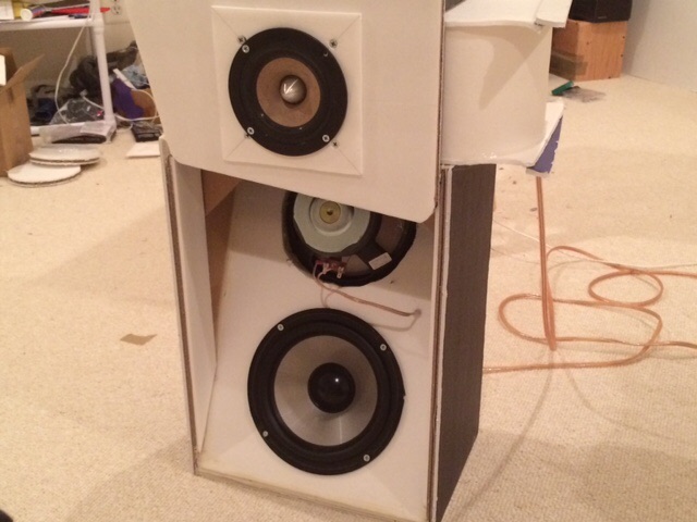

Actually, my mini KaZba prototype has taught me that even with two little 3.5 in drivers, this OB concept generates a lot of pressure and really flexes the cabinet - causing noticeable buzz and vibrations. This tells me that the dual 8 inch will have to be something heavy like plywood at least. I am not going to bother with it in FC.
I've watched 3/4" plywood wings including Baltic birch deflect quite a bit: in regular vented Karlson and in a sealed rear chamber klam- that's why Transylvania went to 3/8" allthread through the front tying to reflector then back panel as any wing movement introduced undesirable modulation of the midrange. I'm not sure how to effectively brace the recent klam12 - maybe two dowels tied to one point on the "top" plate.

Cool concept there CLS. Is the planar 6.5 array running full range or just mids?
I'm thinking the range of 300-3kHz, or 500-5kHz, with the central one covering this whole range while the outer 6 playing the bottom half of the range. It's said to have (more or less) constant directivity by decreasing radiating area with rising frequency. Will have to play with the xover by trial & error, if I really build it.

You may have some comb interference with the hexagonal array of they go up that high. You will have a phasiness when walking around or moving your head a bit. But maybe with circular symmetry it's not as bad as a linear array of widely spaced 6.5inchers ?

I made some good progress with the build using triple laminated foam core and cardboard sandwich. This time the layers are bonded with 3M spray contact cement (77 Fastack). Installed the drivers and took some baseline measurements without K aperture and got surprising base extension (40Hz -3dB) as an H frame Z baffle. The top end extension does indeed reach a 750Hz XO. I tried it as a FAST with the Nautaloss trapezoid baffle (shown here with a Tang Band W4-1310SB provided courtesy Godzilla). Box internal dimensions are 12in wide x 18in tall x 9in deep.
