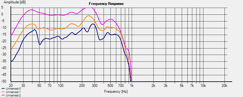

My internal cabinet dimensions are 16" x 14" x 26". Baffle is 20 deg. I did 3 measurements from the center height, 3 ft.(blue), 1.5 ft.(orange) and edge of the cabinet (magenta).
Can you explain this graph to a layman like me? To an amateur it looks like it gets quiet fast. Not disputing the excellent results just trying to understand what it means and how to maximize my PRV's at .62.
That's excellent bass extension. That looks like a solid dipole sub woofer. Can be used for a lot of things. Try the aperture though and see how it sounds.
Thanks X. What's the best way to figure out the aperture?
That's just the bass measurement from 20Hz to 500Hz. I only measured the woofers.

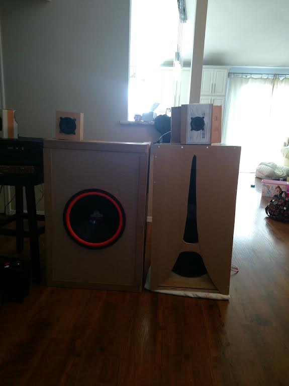

![speakers.jpg speakers.jpg](https://www.diyaudio.com/community/data/attachments/523/523886-45f5344c2c44a8c6e96b56bddb90e6b2.jpg)
Got the 1.16 qt Titan in a 3/4" thick cardboard farm sink package I had laying around for a test. It wasn't ideal but the size was good and it has 12" deep sides. I had a feeling this wasn't going to be a fair fight and it wasn't. The Kazba is noticeably more palpable. I'll leave it to you guys to determine what the measurement is on that. I could probably live pretty happily without a subwoofer with the Kazba if I had to.
