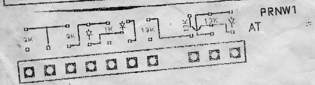

Do you have a diagram for the PRNW1 / NW4 near the LM358? The module itself has PRNW19350 and is 10 pins with three pins offset on the right.

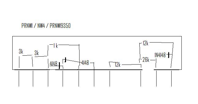

I've pulled this module and am testing it internally against the schematic you emailed me. So far I think I may have found a problem with one of it's two internal diodes but I just need to make more than an aligation about it; the diodes in the middle seem to be a little inconclusive. I tried mapping out this part myself.
-Correction to the diagram. The two 12k are actually measuring 13k.

The attached image is the raw image I have. Some of it is illegible.

Email Steve to see if he'll send you the internal schematic diagram for this module and the schematic diagram for this amp.
