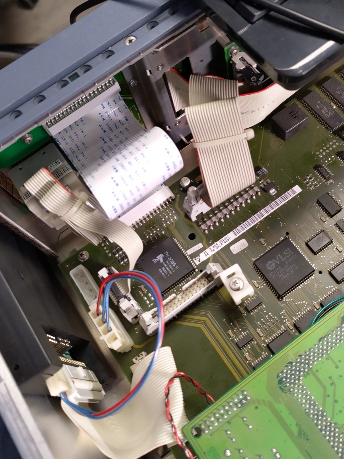

Good morning all. I found a faulty unit. The problem is that during startup, the screen is lit and white. The unit stays in this condition without more progress. Have you a comment about?
John
John
Most likely you have 2 problems: the LCD is dead and the CMOS battery as well.Good morning all. I found a faulty unit. The problem is that during startup, the screen is lit and white. The unit stays in this condition without more progress. Have you a comment about?
John
Try to plug a monitor into the unit, you can see whatever errors the motherboard is throwing. In the unlikely event of a dead motherboard, you can start by replacing all the capacitors on it with low ESR units. I think there’s a thread on EEVBlog with details.
Also check the 6A or 8A glass fuse on the power supply, some units have had bad connections here due to the high current damaging the solder traces and PCB due to excessive heating in the fuse holder.

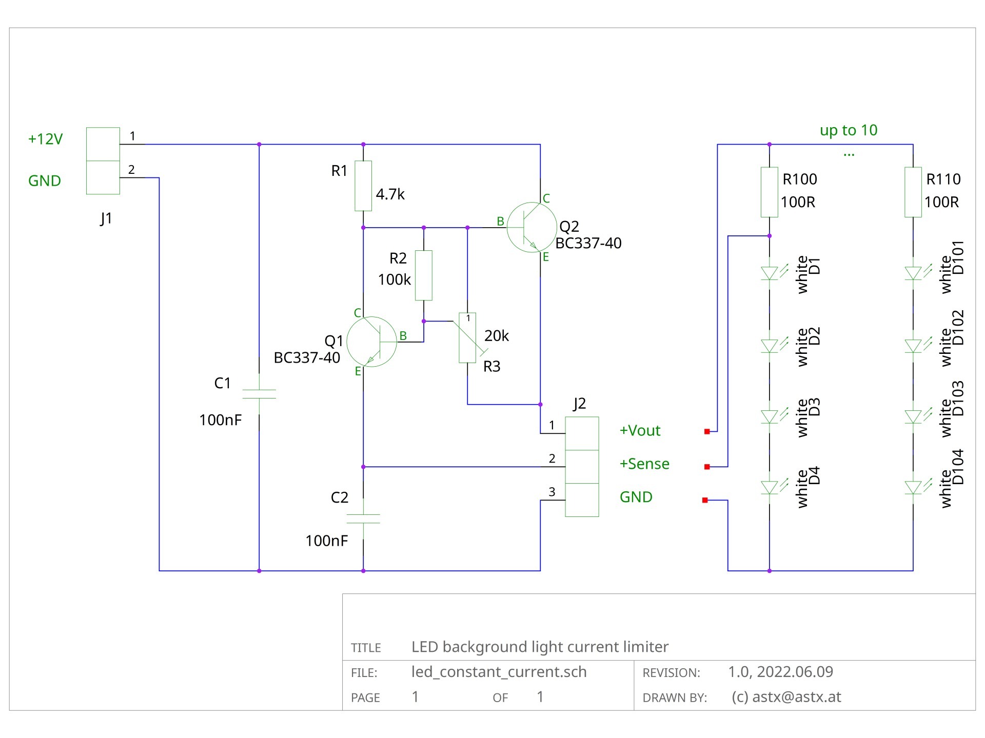

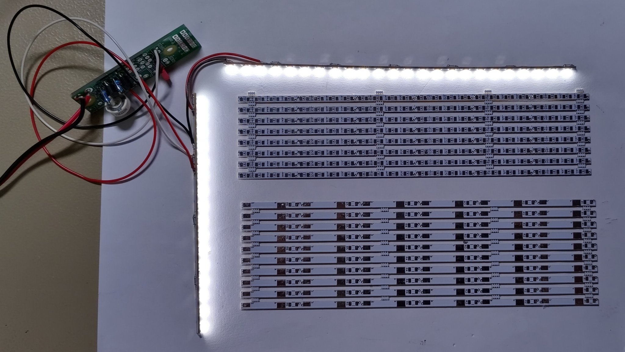

Got my small pcb's to solder the LED backlight recplacement. Left a constant current circuit from an old project.
The used LED's are LumiLEDs L130-4090001400001 (mouser) in 10 groups parallel of 4 LEDs and one 100R in series. Only R100 is used as current sensor.
Have fun,
Toni
