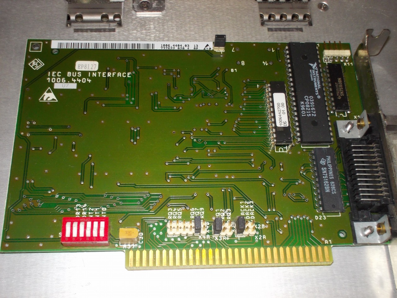

UPD / looking for service manuals, GPIB, ...
Greetings,
I just bought one faulty UPD and am waiting for it to arrive.
In the mean time, I could find the operating manual and I'm now looking for the service manuals as well.
I noticed JohnW posted dropbox links for those files on the first page of this thread but these do not work anymore.
I'd be grateful if you (JohnW) would be kind enough to repost these, (or somebody else).
Also the unit I got has no GPIB card, but I figure the UPD is PC-AT/MSDOS based, so some standard AT-GPIB should work, and possibly R&S have just rebranded a COTS one.
Unfortunately, from the operating manual, it seems that some of the IRQ/INT/DMA are somewhat non standard 😡
Anyone with GPIB UPD willing to take good pictures of that board, so that I try to identify it? That would be awesome...

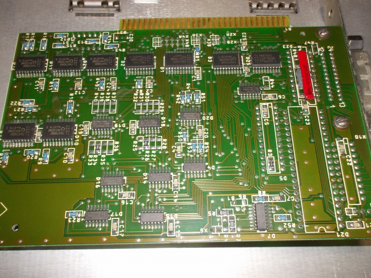

Hi Fred
I checked my UPD's GPIB board. It is not generic one. That's R&S's proprietary board as marked "R&S" on the board. It consist of a large DIP IC may be NAT7210? and a ROM like IC and bunch of 74 logic ICs. I think it is hard to make a compatible board if you intended.
Hi Shinja,
thanks a lot for those picture. Very much appreciated.
I don't think I'll have to make a copy since in the mean time I found that the old (1991) National PCII/PCIIA interface board supports the required DMA channel, IRQ/INT and address ranges, in either 7210 or 9914 modes, so it should work, just from outside the box. Well I hope so, and drivers are easily available as well.
It is cheap enough that I can easily give it a try... and I'll report the outcome.
