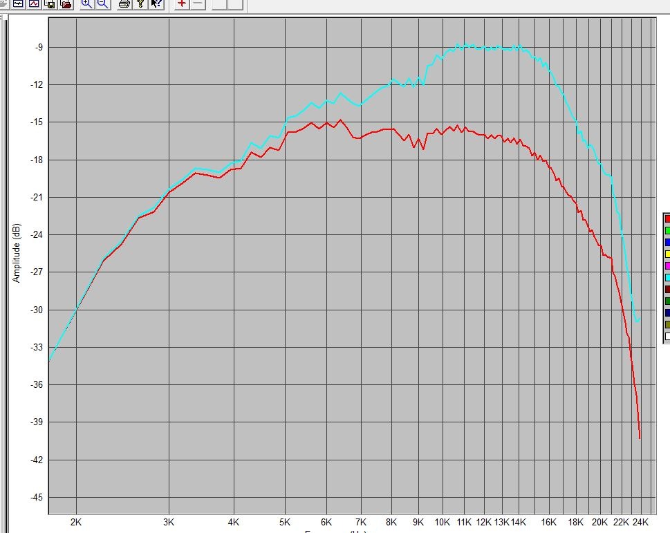

here are the two extreme curves from ten small eletret mic capsules i tested
in this capsules case, if your working below 4-5KHz it should be resonable flat, above that response can vary
