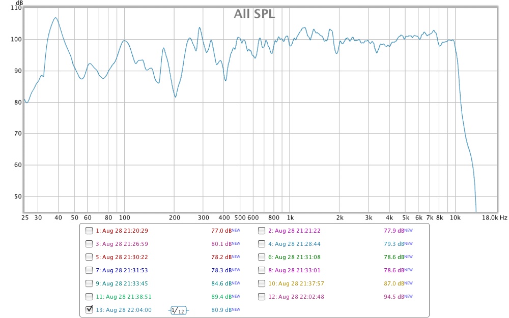

I have earlier this summer completed my line array DIY-project and just now been able to do freq.sweeps and get measurements. Ref the two freq. graphs.
Freq. taper off from 500hz mainly due to the un-EQ'd frequency responce from the LA but my main consern in this regard is the dips.
Is it my room? (Untreated acousticly, concrete walls/ceiling and 2x2" wood frame work and gypsum plated walls.) Room is approx 20x14ft with 7,5ft floor2ceiling height.
Measurement is taken from the left LA only, non-EQ'd at listening distance (~9ft)
If different measurements need to be taken let me know and I'll get it done
What do you guys read from it?

My reasoning was since I wanted a reading on how the array performed I didnt want to complicate it with the pair. I am considering a TL-addition for low end support. However for what I am asking here a single array might not be ideal as a baseline Thats for being an acoustic iliterate
Welcome to the real world. What was it you were expecting? Rooms always add peaks and dips in the low frequencies. If it bothers you, build some bass traps. You could also use EQ, but it may only help one spot in the room.
In my view, the main issue that needs to be corrected is the uncompensated baffle step. I couldn't listen to that response as is.

I wasnt expexting nothing special, I wanted to learn what is showing up in the data collected. Interpret and form a path in a sense.
The graph is from non-EQ'd testing since I didnt want to color any baseline data. I am using an Ashly 15band EQ adjusting the signal to taste when playing music/watch movies.
Floor is wooden tiles and the array cover about 85% of floor2ceiling distance.
Prior to my thread I knew the room would benefit from acoustic treatment (which room doesnt) but knowing how much and where is were I want to learn more about . Perhaps I ought to take the array outside and test it there. Any difference would be the room influence

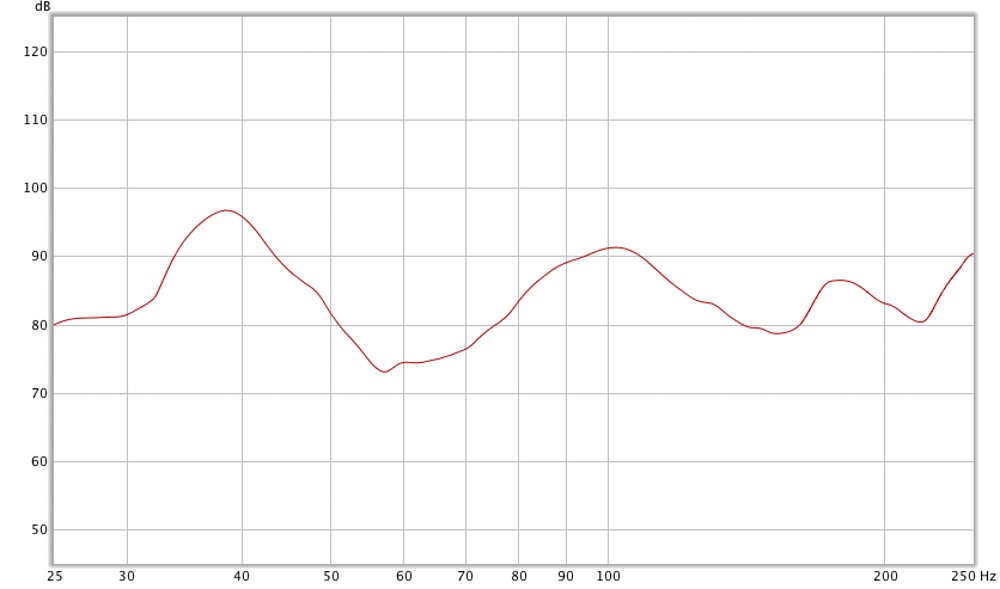

So what's plainly evident is as Greg mentions, the effects of a lack of baffle step. The response from 1khz up goes unappreciated........it's pretty fantastic really.
So first a passive full BSC network is needed to to offset the rising response above 1khz.
Your measured response matches Martin Kings formula where baffle losses begin at 4560/baffle within inches. So if we assume a 4.25" baffle for your TC9 array, we find the losses begin at 1khz and you will need full 6db compensation.
First, you'll need a Zobel circuit to flatten the impedance and then the BSC tilt.

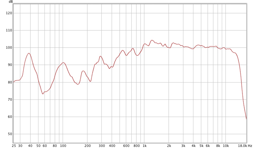

This is my sweep done with both arrays in my concrete rectangle of a listening room.
The green is without EQ, the red with an early attempt at EQ. Things moved on since, but it gives an idea.
I boosted some high end, and the dip, centered at 1k is intentional, I find it clears the music and singers have a less nasal tone.

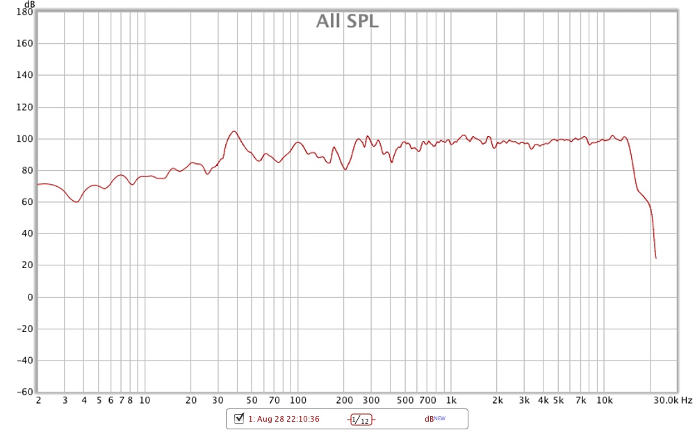

Did you gate the measurement? Is the array in it's position near the wall? And at what distance did you measure? I'd also suggest measuring more than once in a few different places at about the same distance to see what it does with the peaks and valleys.
Gate? No.
About 90cm out from the wall (front baffle).
Speaker about 1,5m out from left side wall - 3,5m out from right wall.
Mic 2,5m out from middle speaker directly in front, mic pointing straight towards front baffle.

In their final position, will they be 90 cm out from the wall? Or actually closer to the wall.
I think that position could be partially responsible for the dips seen around 200 Hz and ~400 hz.
I expected them placed closer to the back wall in their final position to aid the low frequencies.
Still doesn't explain the lack of a drop in the higher frequencies though.
