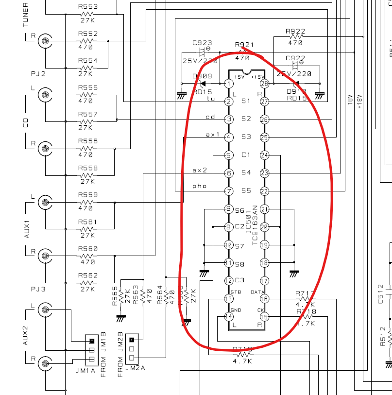

Am working one of these right at this moment. What i have found is i have very low output on right/hand channel on all functions however as soon as i remove the bottom chassis plate the chanel comes back. What i have found is as soon as tighten down the screw on a earth point right near the smoothing caps the chanel disappears but if you remove the plate and connect a bridging wire from that earth point chassi the channel goes faulty am trying to get circuit diagram at present to carry on fault finding.
Some photos would be of help...but if you remove the plate and connect a bridging wire from that earth point chassi the channel goes faulty
Another thought - the screw is too long and shorting the signal somehow.What i have found is as soon as tighten down the screw
