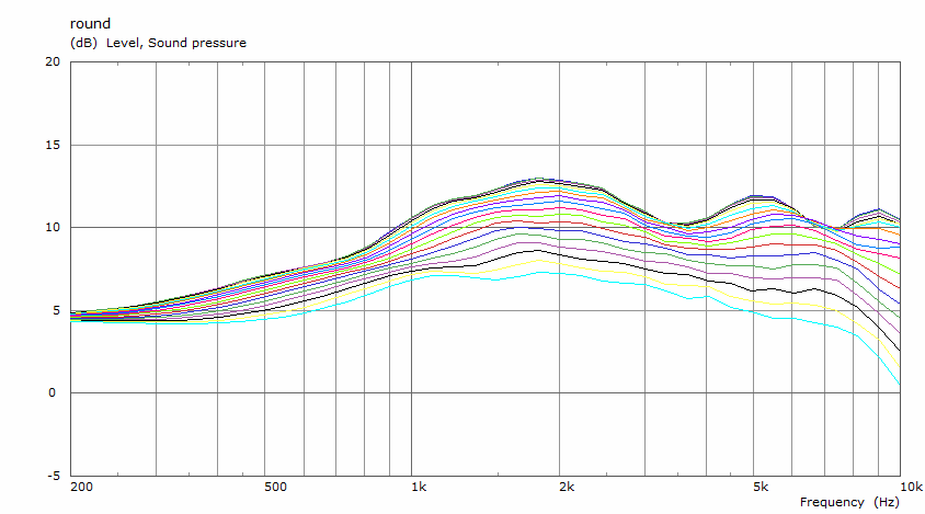

Rounded vs. chamfered edge - sim by @mabat

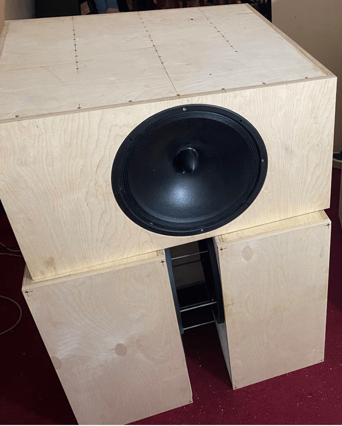

same as any, problems above frequencies whose wavelenght is shorter than roughly the width of the box. If this is 32" wide it means problems roughly above 400Hz until the woofer beams enough not to disperse sound toward the edge, probably past 1kHz. You can scale it to any size and it works out the same, wavelenght vs. physical size.Really? What diffraction issues does this guy have?
Regarding that sim.. It may seem indicative but it's not definitive.
Is there square corner somewhere?
So are you suggesting that as far as baffles are concerned....the flat parts of the baffle create issues? This makes no sense to me,....Not saying its/you are incorrect I just don't recall anyone ever showing me the "issues".....I thought the only issues came from the edges and the frequencies that interact at the edge and no where else.....and my confusion surround infinite baffle.....Make the baffle infinitely wide and no issues......Make the baffle 32" wide and now the frequencies inside 32" are an "issue"?same as any, problems above frequencies whose wavelenght is shorter than roughly the width of the box. If this is 32" wide it means problems roughly above 400Hz until the woofer beams enough not to disperse sound toward the edge, probably past 1kHz. You can scale it to any size and it works out the same, wavelenght vs. physical size.
Makes no sense to me, at this point.... You would think that the frequencies inside of 32" would response no different than the same spectrum, seeing an infinite baffle.
what is the source of the issues? and what do they look like? @fluid has been trying to teach me but I have yet to see a visualization
Another point....these issues won't be due to edge treatment because the Visualization I have seen show that the frequencies at 32" are so big that they don't care if the edges are treated or not....
There is a difference between a cabinet design that is low diffraction in nature and using a big woofer in a big flat baffle below a frequency where edge diffraction effects will be measurable.Really? What diffraction issues does this guy have?
I'm not trying to say there is an "issue" but there is a difference in the directivity. The width and the depth dimensions of the cabinet work together to dictate the low frequency directivity that the box imparts. Infinite baffles are smooth but they reduce directivity. Not right or wrong just different.what is the source of the issues? and what do they look like? @fluid has been trying to teach me but I have yet to see a visualization
Below 600Hz with a 15" woofer there was no difference in the simulations of edge treatment or square.Another point....these issues won't be due to edge treatment because the Visualization I have seen show that the frequencies at 32" are so big that they don't care if the edges are treated or not....

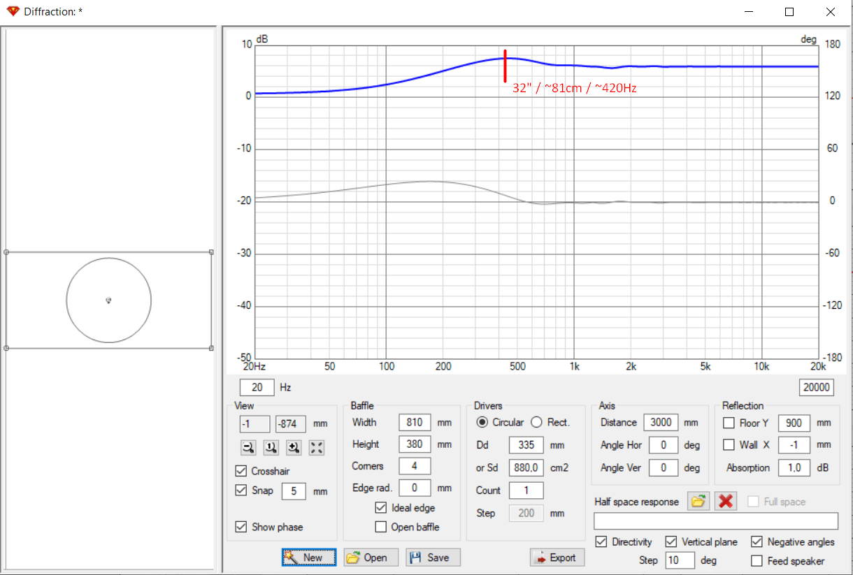

Its all relation between wavelength and the object. All frequencies diffract at an edge they interact, it is just that on a loudspeaker like this highs don't reach the edge as the transducer beams. Low enough lows (bigger than the baffle) just wrap around / diffract enough in phase with direct sound so that not much interference "ripple" is seen in axial response. Only the hump around where wavelength roughly equals baffle width which seems to make constructive interference with direct sound. Above the hump all kinds of ripple show up until the driver beams. This means roughly wavelengths between baffle width and driver diameter would be the ones that produce "ripple" seen in axial frequency response. I have to say there is not much seen here on your example dimensions and with the simple baffle sim, it works out nicely being asymmetric enough spreading the diffraction in time.So are you suggesting that as far as baffles are concerned....the flat parts of the baffle create issues? This makes no sense to me,....Not saying its/you are incorrect I just don't recall anyone ever showing me the "issues".....I thought the only issues came from the edges and the frequencies that interact at the edge and no where else.....and my confusion surround infinite baffle.....Make the baffle infinitely wide and no issues......Make the baffle 32" wide and now the frequencies inside 32" are an "issue"?

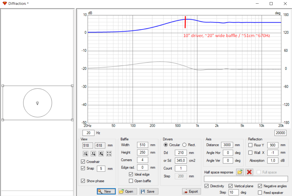

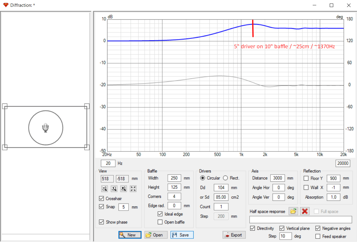

Attached is quick demonstration 15" driver on 32" baffle, 10" driver on 20" baffle and 5" driver on 10" baffle. Although, as seen from mabats full box sims these simple baffle only sims don't tell the full story how a box performs diffraction wise. What these show that there is wavelength in the math, which I suppose is based on reality. Cycle through the attachments and see how the features of the interference on the axial response are exactly the same on all of these examples, only difference you notice is that the response features shift up in frequency as the transducer and baffle gets smaller. So yeah your example big box diffracts the same as would 5" on ~10" baffle, only at lower bandwidth. Just don't use the box up to the diffracting bandwidth and you are golden without roundovers. As you narrow the baffle, the diffraction happens at higher frequency, hence max usable bandwidth below diffraction comes with as narrow baffle as possible, from baffle step down (with square edge). You'll lose the baffle support though, it is compromise where you slide the baffle step down in frequency by widening baffle but slide much past the driver width and diffraction drags down with it and creeps into the bandwidth, you can easily test this on a baffle diffraction simulator. No problem if you crossover below this, about at the baffle step.
