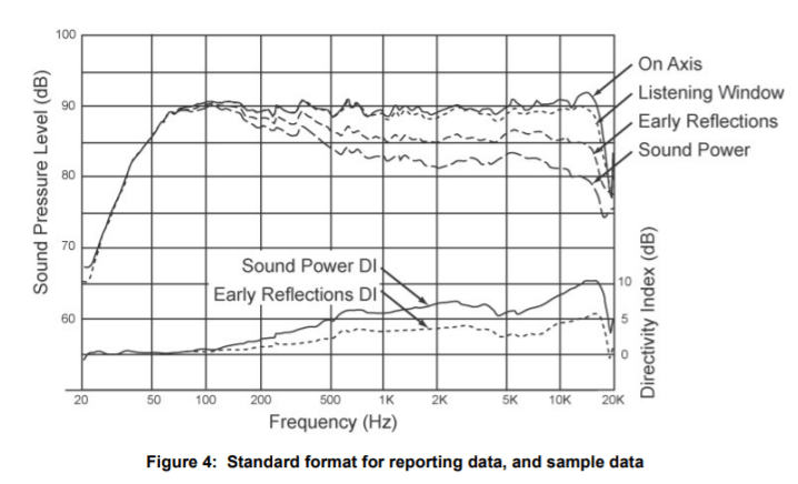

The source seems to be a WHO paper about noise... https://www.who.int/occupational_health/publications/noise1.pdf
camplo (applies to all of us), please inform us about the source of information! Discussion without common definitions is fruitless and frustrating.
Toole's book is a very good reference (that I don't own) It is mostly based on definitions used in IEC/ISO etc. Nowdays we see mostly these
- synopsis https://www.harman.com/documents/AudioScience_0.pdf
1.1.2. Sound Field Definitions (see ISO 12001)

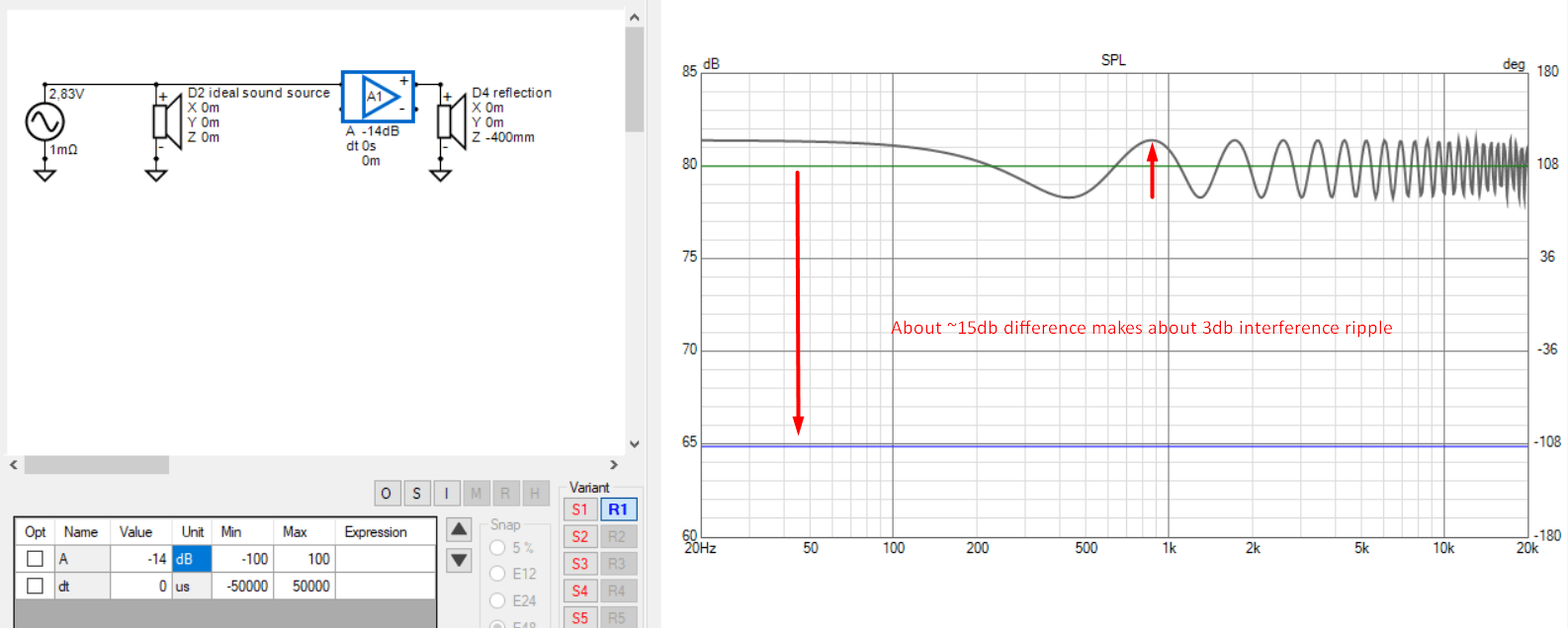

As explained earlier, and in the Genelec illustration, at 1/4 wavelength distance from wall we get strong dip at listening position, because round trip there and back is half wavelength making destructive interference with direct sound towards listening position. Constructive interference happens when two signals have less than 1/4 wavelength path length difference, and in case of the round trip to front wall behind the speaker this makes 1/8 wavelength distance from the wall the turning point. Below this frequency (longer wavelength) we are coupled to the wall but above (shorter wavelength) we are heading to a interference dip as frequency rises and at 1/4wl we arrive at strong dip.
Alright lets define how wall becomes extension of baffle, and what it means in numbers. Basically to get the wall extend the baffle we need wide enough baffle to block / attenuate sound toward the wall above frequency whose wavelength is 1/8 distance from the wall.
Lets make the previous post as example, take the same ~200Hz as our target to do calculations. Below 200Hz we plan to couple with the wall being closer than 1/8wl from it and above 200Hz we plan to attenuate sound towards the wall by using big enough baffle.
At ~200Hz wavelength is ~170cm, so lets just round 1/8wl to 20cm. For frequencies above 200Hz interference starts to show as wavelength shortens and at 400Hz we are 1/4wl away from the wall and the 1/2wl cancellation happens, a strong null at listening position. It is critical to attenuate 400Hz enough so that we don't have significant interference at listening spot from the wall reflection in order to claim "the wall becomes part of the baffle", both baffle and wall working together. Lets define significant interaction for example as 3db interference ripple which happens reflected sound from the wall interacts with direct sound. 3db is arbitrary number, often referenced as audible difference in sound level. From simple experiment without math knowledge it looks like 15db attenuation on reflected signal gives +/-1.5db, or 3db interference ripple. To give more perspective on this +/-1db ripple requires 20db of attenuation, and to make the interference almost disappear 40db attenuation is required. 40db is 1% if anyone wonders, like THD is often expressed in percentages.

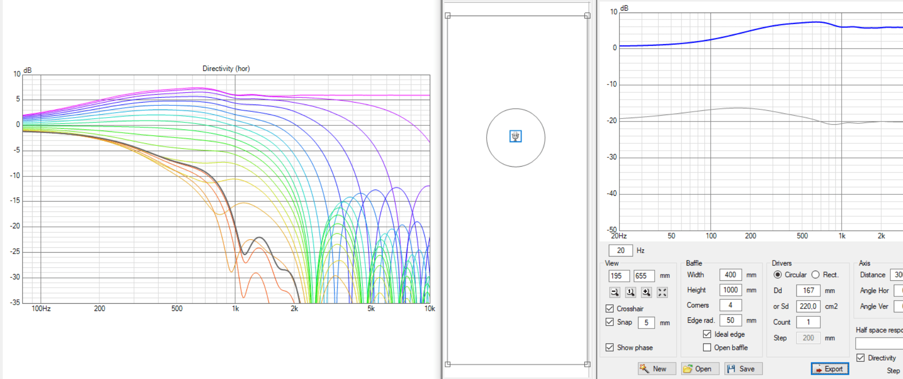

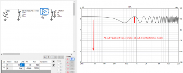

Now enters the baffle size. Here is simulated 40cm wide 1m tall baffle with 8" driver on it. Black line on the frequency response plot is 180 degrees, purple on top is on-axis.
From the simulation we can interpret the system has "baffle support" down to ~250Hz if looking at the on-axis response, but if we look response behind the speaker* it attenuation to 180 degrees, directly behind the speaker as in simplified genelec example, we can read where the -15db point is. It looks to be roughly at ~500Hz in this case, attenuation at 400Hz is so close to 15db so we could call it for simplicity sake and given the accuracy of the simulation. We'd basically got to our goal, 40cm wide 1meter tall flat box within 20cm from the wall we would be effectively couple with the wall and claim wall is extension to the baffle. Only 3db or +/-1.5db interference due to the wall would be there at the listening position according to the simulator.
Form this simple experiment we got rough number that baffle has to be 1/2 * baffle width away from wall to couple with the wall. If we have 20cm wide baffle we would have to be within 10cm from the wall. If the speaker is 40cm from the wall we would need 80cm wide baffle etc. If one wanted to be more strict with it and have 20db attenuation towards the wall to get the interference to +/-1db, in this example this happens at 800Hz and we would have to be within 5cm from the wall with the 40cm x 100cm baffle, or at 20cm away we'd need 160cm wide baffle! This is not too accurate, but to give some example how this all works out, relation between wavelength and size of stuff, path lengths.
More elaborate simulation and strict definition for baffle dimensions and box shape would be required to draw any more or accurate conclusions. Also, we don't usually have speaker directly front of us but a stereo triangle, toe-in and what not, real situation would be more complex. But to be sure to couple with wall one definitely needs to be very very close to the wall for realistic baffle sizes because baffle width has to be (at least) 2 times wider than distance to the wall. Can't toe in wide baffle and stay close to the wall can we, we could circumvent this with other means as well by controlling the speaker directivity otherwise than with the baffle. A waveguide, or some dipole / cardioid system with toe-in would do, increase attenuation towards the wall specular reflection point reducing the interference ripple towards listening position so we could again claim that the speaker and wall work together as one. That said I don't see benefits for wide baffle, especially if one starts to look at the diffraction stuff, unless all the width is used for roundover. Big baffle and big roundovers just aren't very practical.
* VituixCAD diffraction simulation is not with full 3D enclosure but only baffle and some assumption about the enclosure but I'm not sure what it is. This experiment would benefit some BEM simulation to get more accurate answers, how much enclosure shape effects and could be optimized for near wall positioning.
