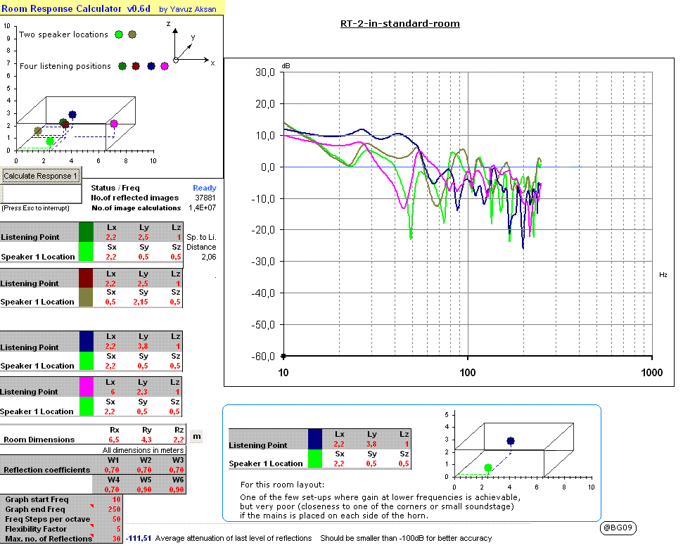

Late, but 2 cent of thoughts about what’s been said about RT-2:
Any speaker can use closeness to sidewalls to furniture’s etcetera, but should be measured in an environment that doesn’t depend on user unique influenced speaker placement where proximity to objects and distances are unknown.
This dependency must be IMO ruled out, i.e. like done for the original FR curve that is correctly showing the horn performance when being measured in Pi environment.

If a RT-2 horn is placed at a third distance of the longest wall of standard room size of 6.5x4.5x2.25 (m) room the FR may extend smoothly but the opposite will probably occur if placed elsewhere but is/was very dependent on room structural design in floor, walls and ceiling.... See picture 1(1).
Have you done measurements or do you have a simulation in Pi space to back up this statement of nominal cut off frequency, back then at late seventies nobody I knew of showed how or had measured such low extension.

Recommended placement is about 1/3rd down the long wall of your room and then shifting along to find a place that sounds good. Don't place it in a null or node of room resonances.
…Response down to 40 Hz sounds about right for this horn …

…True true, as discussed earlier, these sims don't show the whole trught, and there is certainly more low end response in my livingroom than what the sims indicate…
Have you done measurements that confirm your statement? Where have you placed the RT-2 horn? Floor plan?

Unfortunately, I don't have any means of making any measurements, so all I can do is to listen and compare with my old sub..

I think that I suggested no more than including the cabinet in simulations. Perhaps this was directed at another poster.
If a RT-2 horn is placed at a third distance of the longest wall of standard room size of 6.5x4.5x2.25 (m) room the FR may extend smoothly but the opposite will probably occur if placed elsewhere but is/was very dependent on room structural design in floor, walls and ceiling.... See picture 1.
Agreed, that´s why I said experiment. One needs a place to start.
I´ve been emailing and boarding with Swedish and German people `from the seventies`. The Germans were/are building the RT-1 versions, the Swedish are talking about the RT-2 and RT-3. These later models don't seem to have reached the rest of Europe. Anyway, the Germans/RT-1 need some tricks with damping (first segment of horn, apparently damping above 100Hz and virtually extending the horn segment, like stuffing a TL) and careful placement, but they manage 30Hz and even lower. The Swedish don't seem to try as hard and report (memories of) dry 30 Hz with the RT-2.
I have no personal experience other than simulating and reading other people's experience. I base my opinion partly on the original article about the RT-3 and RT-2.
Given this statement: This applies to any driver in any enclosure, so what’s the point of mention that at all? (this was about damping/boosting/driver selection allowing squeezing 30-35 Hz out of it
The efficiency of a horn is generally higher than that of the same driver in a direct radiator enclosure. It might be down by a great number of dB in a certain range, but the actual efficiency in that range may still be higher or equal. Horns reduce cone excursion. They sound more dynamic, certainly in the range where they are most efficient. By choosing a driver that delivers good efficiency and a conveniently boostable response in a horn, you can have that typical horn behaviour in the efficient range and good extension below with roughly equal power use.
It MAY work out very differently. I have had good experience with other horns of my own design and boosting.
