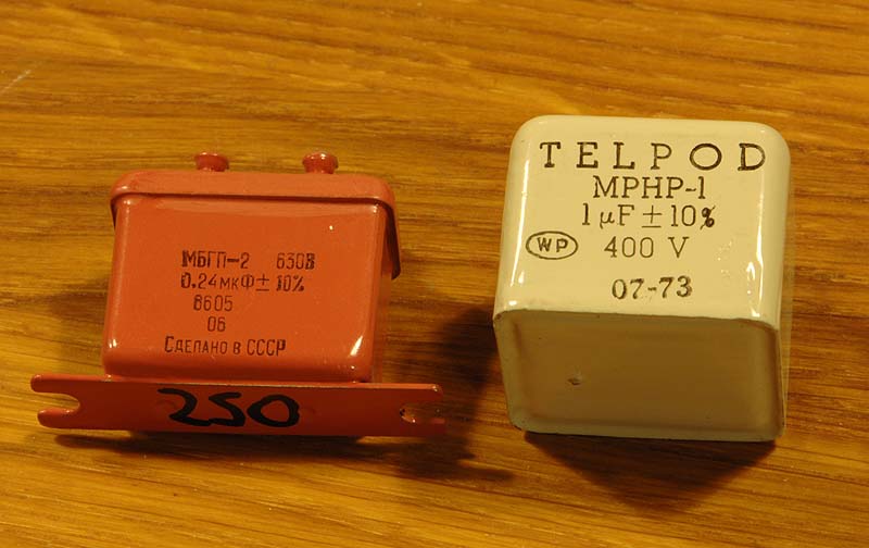

MBGP-2 - left one -
ÜÕâÐÛÛÞ-ÑãÜÐÖÝëÙ ÓÕàÜÕâØçÝëÙ ßàïÜÞãÓÞÛìÝëÙ.
Metallo-Bumajni-Germetichni-Pryamougolni
Metal-Paper-Hermeticity-Square-wave
Consist from several rolls metall-paper, imbrued ceresin, which somewhat transparent. MBGP - For sound equipment, this type - best from MBGO, MBGCH
IMHO =)

PythonOleg said:Metallo-Bumajni-Germetichni-Pryamougolni
[/B]
Pryamougolny means a rectangular form of the body.
"The best" always means compromises, i.e. different losses in different applications for the same capacitors. However, some very expensive dielectrics and metals can be used to make capacitors for all means of usage, but anyway it will mean compromises.
For example, losses sometimes mean thermal changes, thermal changes mean change in sizes, that mean changes of capacitances. It is one example. Some losses are chemical. Some depend on a current, some depend on a voltage. Some mean piezo-effect that changes geometry with voltage. It is always very complex. Now suppose that during an one period of a signal the capacitor changes it's properties several times by several ways...

Is it the cap core that is rectangular (pressed into a square form to fit in the cavity or is it the box that holds the cap that is rectangular?Pryamougolny means a rectangular form of the body.
I am using That brown serie, from picture abowe,
russian military and found them very good indeed
excelent sound compared with lot of fancy ones...
in signal paths, PS, and crossovers too...
K40-9y
