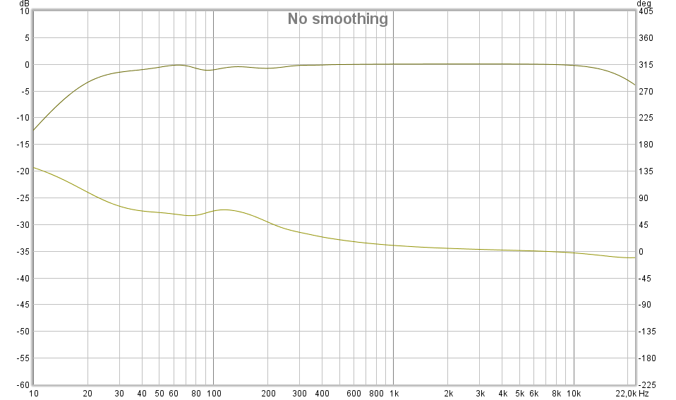

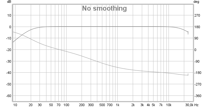

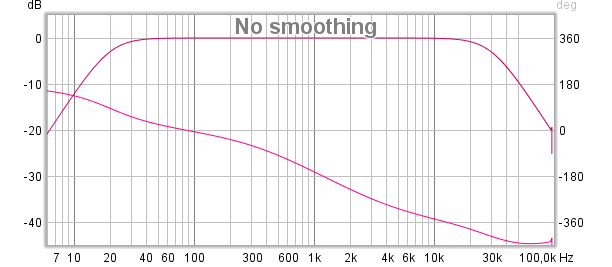

Think it looks good at those scales : )

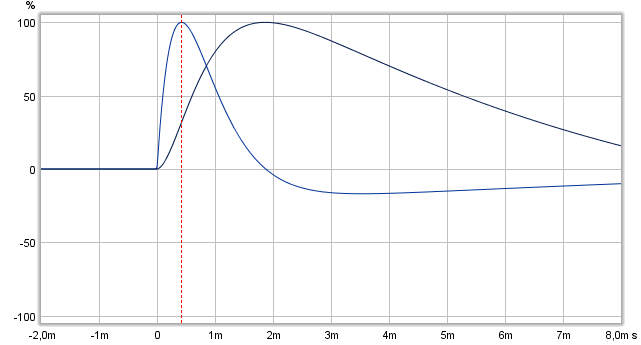

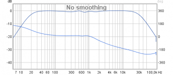

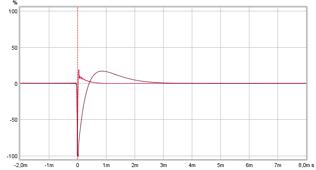

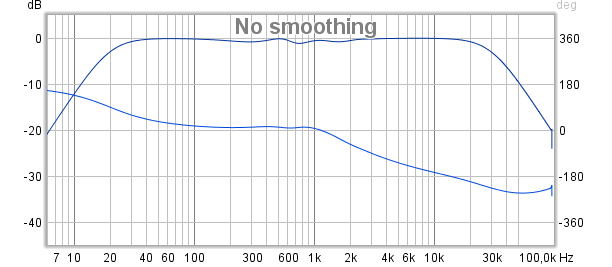

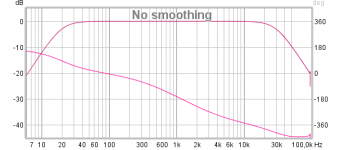

Textbook synthetics below if they can help, system stop bands are set with BW2 slopes as 20Hz and 20kHz, the last one is if XO point was pure linear phase so as to see the difference in bit lifted phase plus a hump from harsch XO.

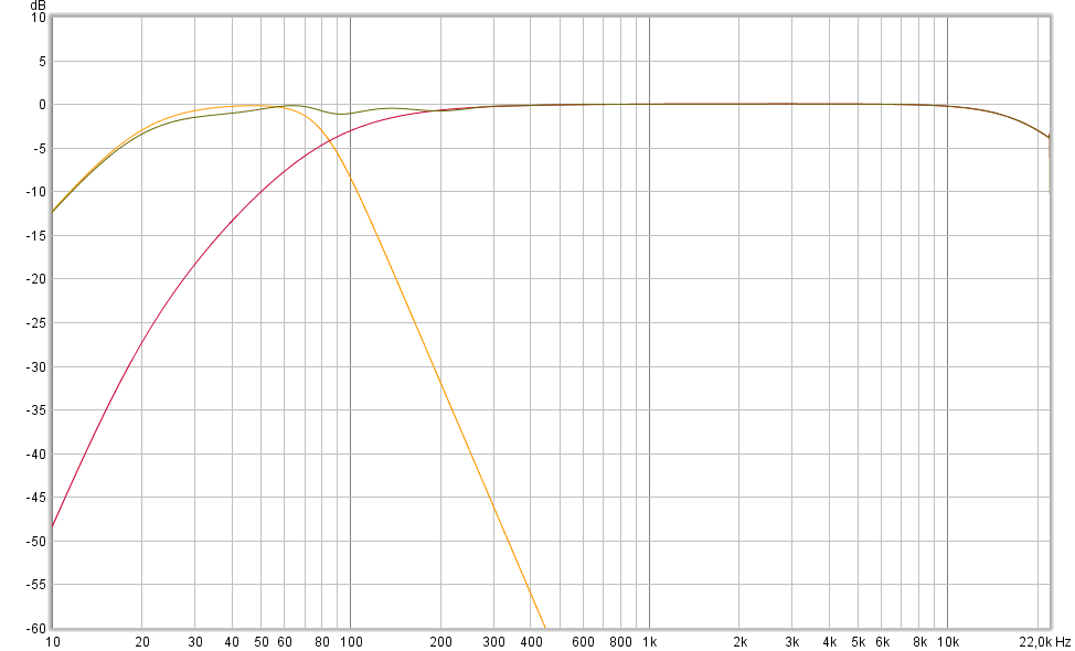

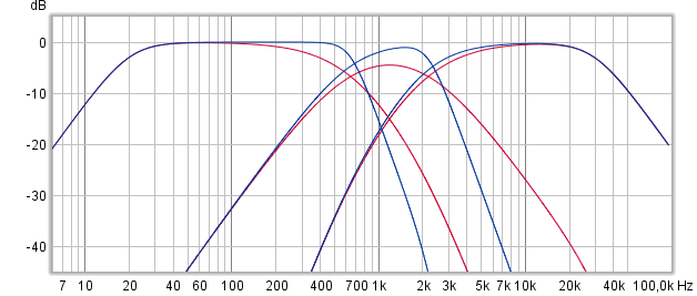

In some study from past can share:
Transfer slope from LR2 to BS2 slope add a PEQ @650Hz/2200Hz Q0,58/+1,3dB.
Transfer LR2 to BW4 slope add one HP or LP BW2 @650Hz/2200Hz plus PEQs Q1,31/+4,3dB and Q0,58/-1,3dB.
In you have system tweaked for LR2 then in theory add above electric filters into DCX2496 should transfer red traces below to blue and then set the right delays 1/650x0,5 plus 1/2200x0,5 and change all three band pass to have the same polarity.

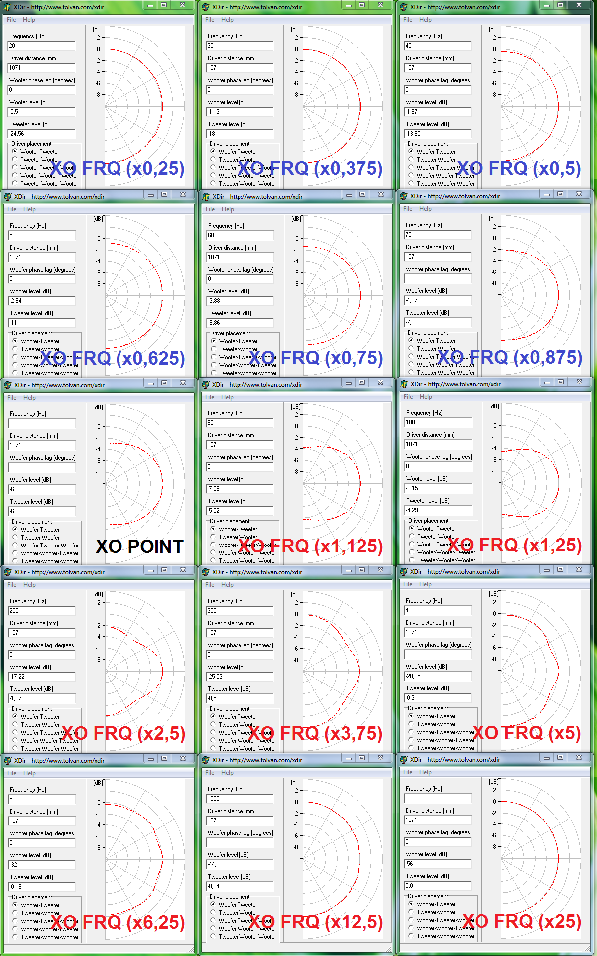

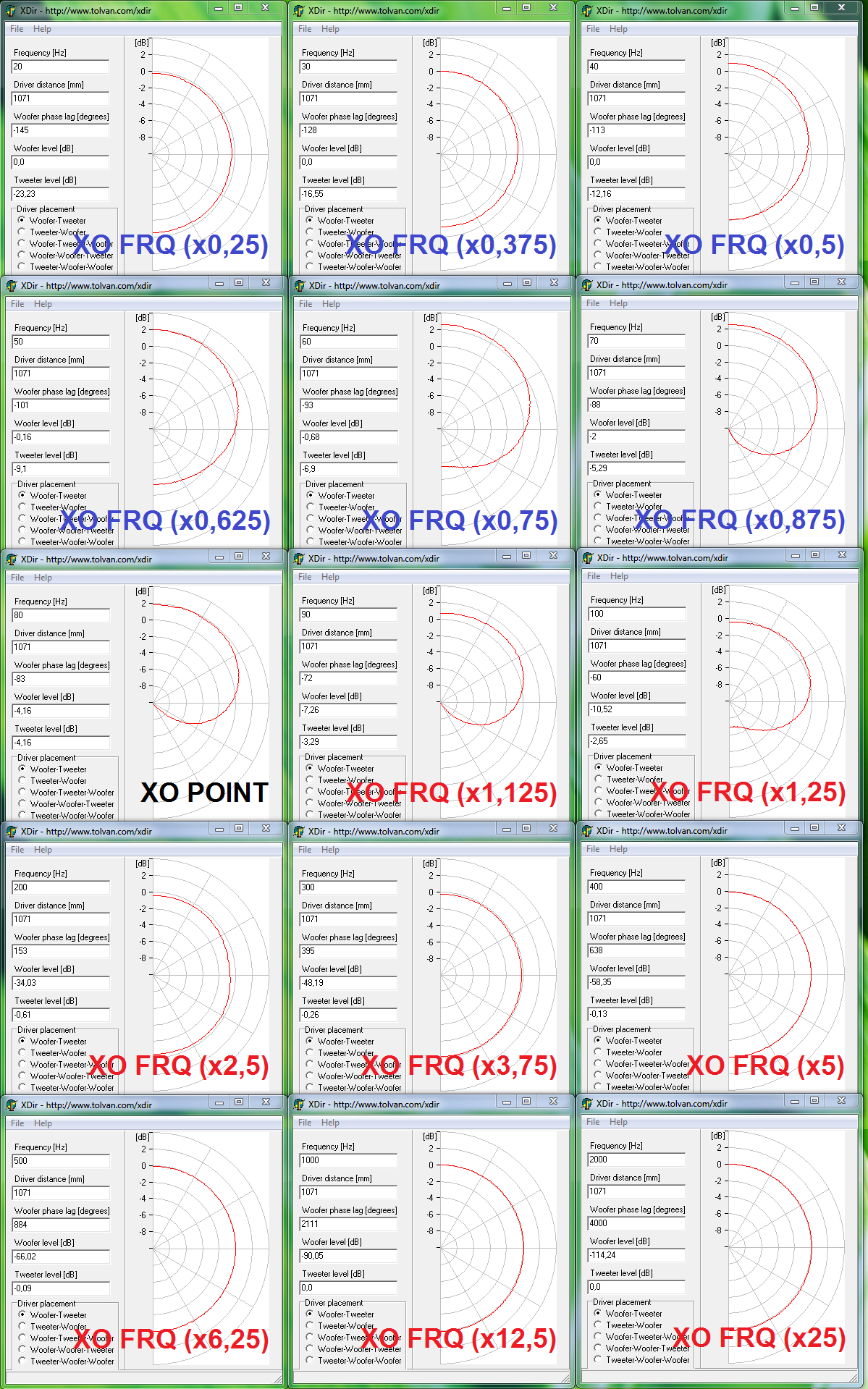

Harsch are not complete in phase over XO region so the verticals power response is bit tilted here and there and not as symmetric forward as for LR2, below example is when two summing bands are within 1/4 wavelength distance, first is LR and second is Harsch.

In past used JRiver DSP and ran a real electric loop with all those filters set into Jriver engine and in used soundcard beside analog I/O have pure digital I/O too then results got pretty textbook and clean. Later started use Rephase because its much faster and output as 64bit IEEE stereo or mono IR-file which when imported to REW can be manipulated in time over there beside change SPL and do all the math on "All SPL" tab, a note is use always IR with the same sample rate and if used as target curves pick same sample rate as your measurement chain use, and also if you filter measurements with windows or FDW do the same for target curves because it can sometimes make a little difference.
Over in Rephase there is not any fixed 2nd order Bessel slopes so use a LR2 and add a PEQ @XO-frq Q0,58/+1,3dB.
Hardest part is remember always to align impulses before any summing or other math, mid and tweeter bands align most often perfect using "Estimate IR delay" but the none sharp woofer band is often a little wrong aligned after that command in REW so some manual alignment is needed, the fastest way i found is after they aligned via "Estimate IR delay" then open "Overlays" window and pick its "Phase" tab where the woofer bands phase is clearly not overlaid together mid and tweeter band so now move woofers IR in programs main window for example minus 0,001ms at a time until its overlaid the other two bands. To do same for Harsch which haven't symmetric same slopes for HP verse LP you have to make one exstra temporary tweeter that have BW 4th order HP to get a reference to align woofer right.
For use in XSim export as frd-file from REW but remember first to align IR and mayby offset SPL to about 90dB levels.

Mine graphs are synthetic textbook ones so they great as a quality check to compare your measurements.

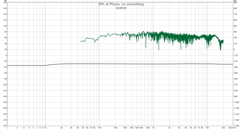

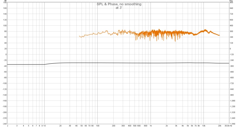

Suggest open before measurement session and via "Limits" button at the right side up in top set other scales, for example a 10Hz to 25kHz X-axis and a +40 to+90dB Y-axis.
With above settings can you share before near field measurement with the window named "SPL & Phase" and ensure its legend below graph have phase ticked on because then we can compare to the third graph of mine, and wait a minute also hit "Controls" at upper right corner and push "Estimate IR Delay" maybe more than once until dialog tells delay is zero.

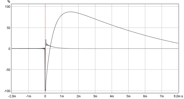

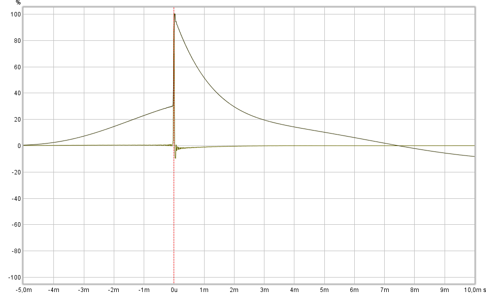

To compare second graph of mine pick "Impulse" window and with mouse inside graph window ensure setting in left top side of graph window is set to "% FS" and also use "Limits" button to tweak X and Y scales.

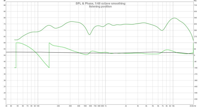

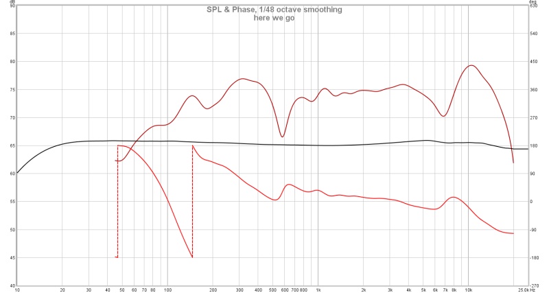

Looks scary
Thanks and year a bit scary but think we can filter that a bit to get a picture of more direct sound from speaker with less reflections from surroundings based on some frequence dependant time gating, so can you do it again but this time do following first, out at left side there can be many sweeps so mark that same one again and push "IR Windows" button a little left to the middle up in top and in that new dialog tick "Add frequency dependent window" and a dot in "Width in octaves" and set its number to 1/6, then push "Apply Windows" and close the dialog and you should see some much smother traces.
That said from present graph it looks your high pass section above 80Hz XO is much hotter than woofer or woofer isn't there at all or it need some many +dBs of boost or high pass section needs to be turned down a bit, what i mean is if you look at my first graph its like you only have the red trace from there where we need also to see the orange trace (woofer) show its face so they can sum together and throw the nice response seen as a gold trace. The good thing about your miniDSP is it can down the road when you get more insight maneuver its settings and features help smooth out the scary looks of response.
