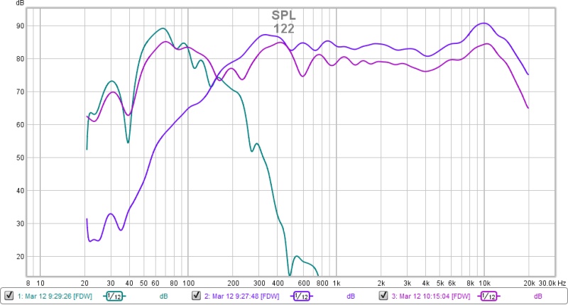

Not frustrated at all on my side. The speakers sound wonderful. I have nothing to compare them to outside my house. Took me 60 hours just to learn how to set up the Mini dsp just so I could take measurements. May take much longer to put it to good use. I made 20 or so measurements this morning moving the speakers here and there. finally settled on a spot where measurements didn't very much. I've spent time changing crossover points, messing with delay, speaker output, and changing EQ filters using the auto method. It's all good. Time is on my side. Can't thank everyone enough for there patience.

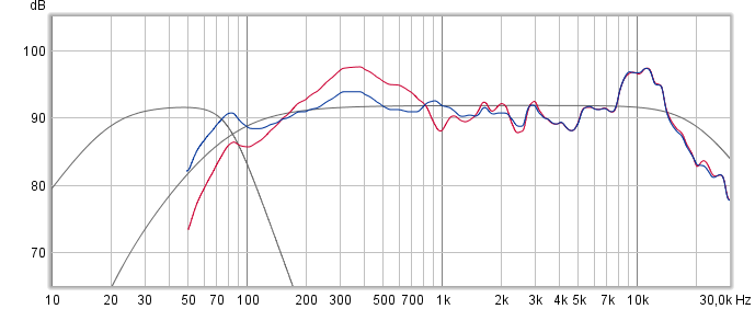

Is it a Jordan Eikona ? because in below plot took their published website response (blue trace) and overlaid with target curves (grey traces) for a 20Hz-20kHz system response with harsh XO point at 80Hz, when then i use free Edge to simulate baffle step and diffraction for OB and extract it (red trace) from published response it shows we can't reach a 80Hz BS2 roll off slope for OB, that said for info when simulated in 3,7 liters sealed it reach a BW2 86Hz slope that should be possible EQ to BS2.

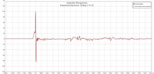

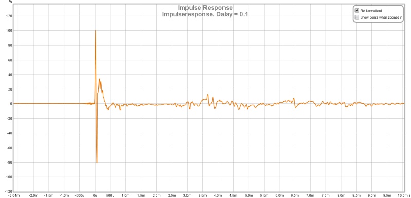

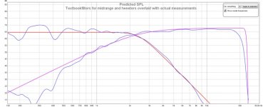

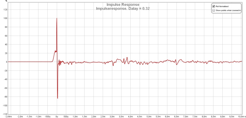

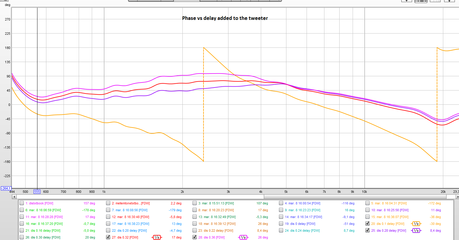

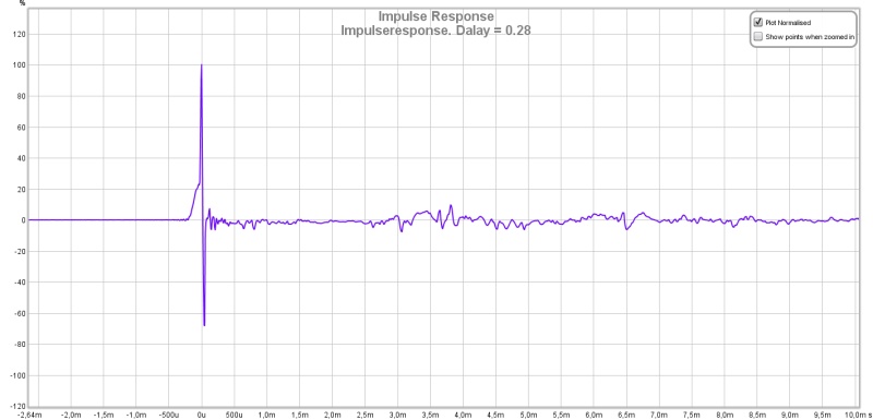

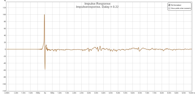

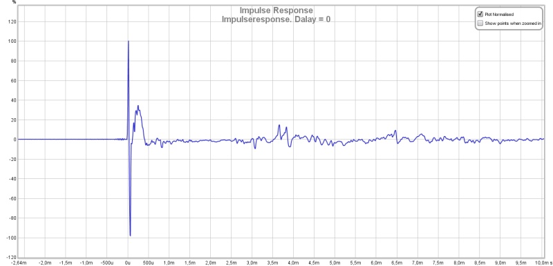

I have done some testing, and it seems I have finally got the grip on it!?
Crossovers are made in Rephase. Crossoverpoint is 2400 Hz. In theory the delay that needs to be added to the treble:
(1/2400)*0.5*1000 = 0.2083ms
Measurements are taken 80 cm from the speaker. All of them are smoothed with frequency dependent window =12.
Before I imported impulses responses from REW to Rephase I made sure to align them to zero via estimate IR in REW - Align the midrange a little bit manually. Thank you BRYTT for that advice !
I maybe could have made the acoustic responses of tweeter and midrange closer to the textbook ones, but I guess it is pretty close.
I just found that in Rephase, in the Paragraphic Gain EQ, there is an option to use so called "monotonic 12dB/oct high or low-shelf filters. This makes the EQ'ing much more easy than simple notches. Cascading two 12 dB filters is equal to 24 dB.
I think that the stepresponses look pretty sweet, right?

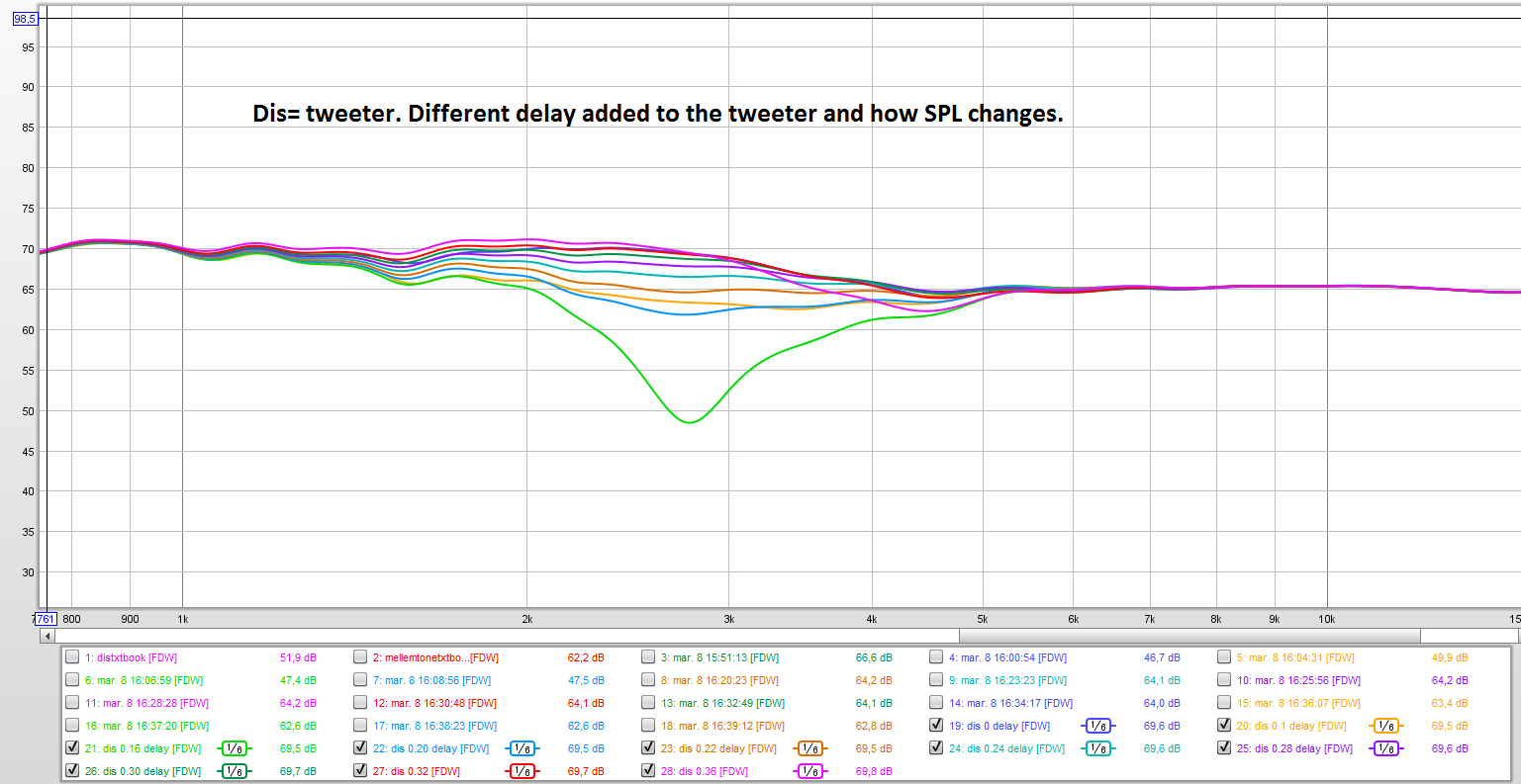

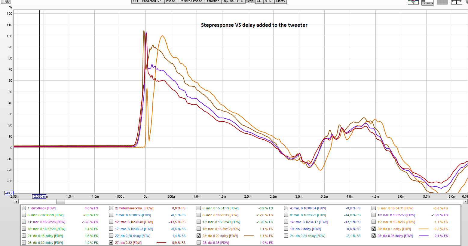

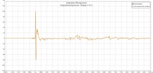

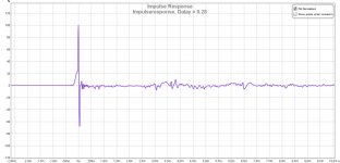

Here are the impulse responses.
...I think that the stepresponses look pretty sweet, right?
🙂 Looks perfect and so far delays somewhere inside area 0,28-0,32mS looks most textbook like.
A note for final delay numbers is if you refines any small bits per pass band down the road makes changes to delay so when you satisfied and lock pass band responses then any house curve tonality had to be a global speaker system correction.
Thanks sharing, will we see your new bookshelf build with Harsch filter also somewhere down the road : )
...A note for final delay numbers is if you refines any small bits per pass band down the road makes changes to delay so when you satisfied and lock pass band responses then any house curve tonality had to be a global speaker system correction...
Or if a global system EQ is not available then set any tweaking numbers for house curve into all summed pass bands also no matter their stop bands are really far away, it will help delay settings also stays the same.

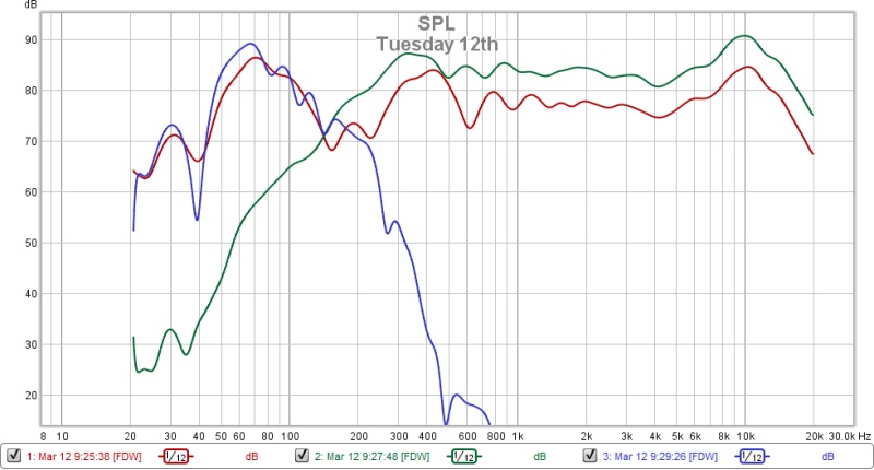

I have at the moment quit the SB65 with horn system. Think something is not just right about the sound.
The above measurement is SB17 MFC and the Alu-dome tweeter. Basreflex 16 liter, tuned to around 31-31 (with a mulitimeter and a resistor). The idea is to make a fusion with these drivers and two of the "cheap" SB20PFCC30 drivers. I got an old Dali 7A cabinet for free which I will use for that. Both midrange and bass will be aperiodic.

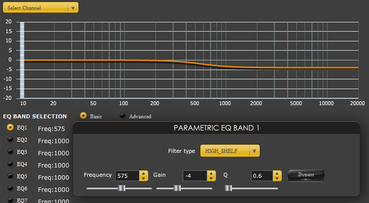

I do not have experience with a system like yours. But I have thought about that "Baffelstep" is something that probably will mask what your are measuring and what your are hearing.
Basically baffelstep is at what frequency (dependent on the baffel width) the sound will radiate. At higher freqency the sound will radiate forward. At lover frequency it will radiate both more around the speaker- in all directions. At good formula to know where baffelstep occur is 115/(width of baffle in meters). For instance a baffel width of 20 cm, the baffelstep will ocur at = 115/0.23)= 575 Hz. At this point there will be a ca -3 dB loss of low frequency compared to the higher one. Imagine a steady downgoing curve.
If you measure very close to the driver (say 5 cm) you cannot observe it. But if you measure at a longer distance (I have heard a good advice is at least 2.5 times the with of the baffel or longer) you can see it on a graph.
The maximum baffelstep-loss is -6 dB - And is room/position dependent
To address and cope with the baffelstep I normally use an "High Shelf" filter with a Q between 0.5 to 0.6 and minus 4 to 6 dB
Compensating for baffelstep is basically a matter of EQ'ing the response of the bassdriver to a straight line.
Hope it makes sense. And if you knew it already, maybe someone else can make a use of it 🙂
