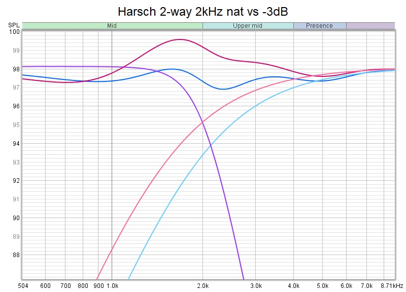

Here's some playing around I did that you guys might find of interest.....
After trying to smooth the textbook Harsch at 2kHz magnitude response with EQ's on the outputs post xover,
I noticed the resulting bessel high pass post EQ looks like a blend between the -4.2dB and -3dB versions.
Let me explain:
This first graph is the same thing you showed in your animation.
2-way Harsch at 2kHz textbook -4.2dB vs -3dB summations at xover
-3dB set: sum=dark red, HP=light red
-4.2dB set: sum=dark blue, HP=light blue
same BW4 LP for both sets=purple.
![Harsch 2-way 2kHz nat vs -3dB.jpg Harsch 2-way 2kHz nat vs -3dB.jpg](https://www.diyaudio.com/community/data/attachments/799/799880-5e2a5a0ff28eafeda2cf0e1c5445446b.jpg)
Nothing new so far, and not near as cool as your animation

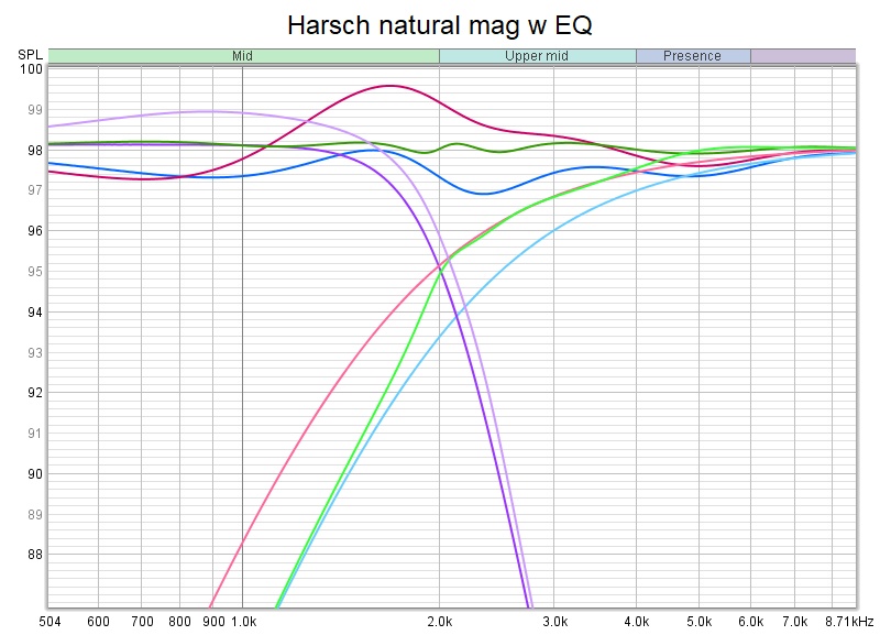

Now with the EQed set:
sum=dark green, HP=light green
BW4 with EQ=light purple
(this is the -4.2dB set with 3-4 small EQ's on each side, none over +1dB)
![Harsch natural mag w EQ.jpg Harsch natural mag w EQ.jpg](https://www.diyaudio.com/community/data/attachments/799/799967-cc7bbe5b4f357ed9ab8fcb5c9e1605e2.jpg)
Notice how the bessel high pass looks like it follows the -3dB HP until the xover point,
then head towards the textbook -4.2dB bessel below xover point.
I dunno, but i find that interesting as heck, and have no clue why.
I figure if anybody knows why, it's probably you

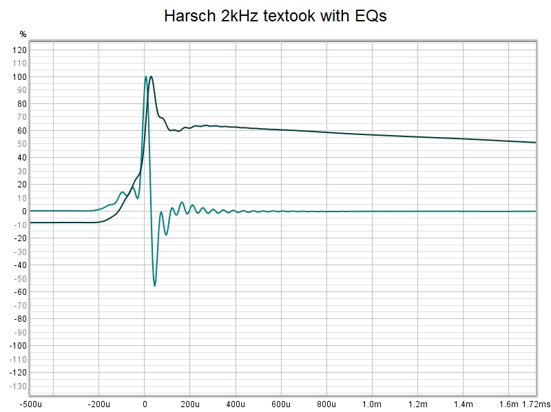

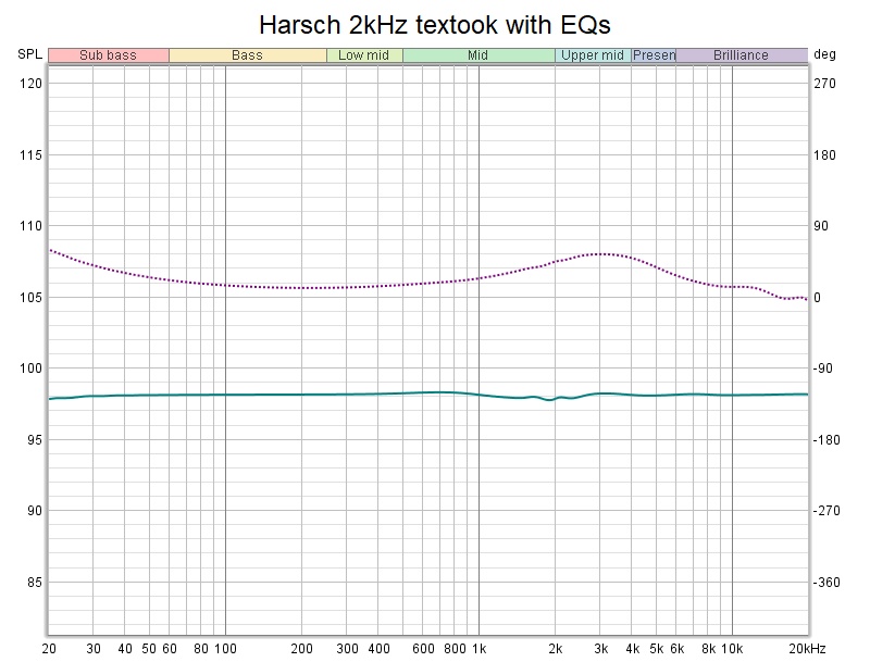

Here you go Ron,
Slightly different EQ's and the impulse has an added Lpf at 20kHz that the SPL and phase traces don't.
I've found i need it to remove what I call digital gack from impulses,
when trying to make measurement across digital platforms.

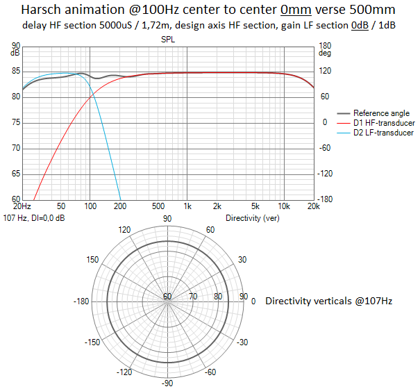

Harsch isn't steep enough and what is distance, get below using 500mm distance and a +1dB gain for LF section, simulation use audioband 20Hz-20kHz homebrew perfect omni transducers hor/ver is covered with 72x 10º per step inputs so what we see in curves is isolated the cause by filters and spacing excluding the directivity of a real world transducer..
A mouse click into animation will hinder X/Y ratio distortions:

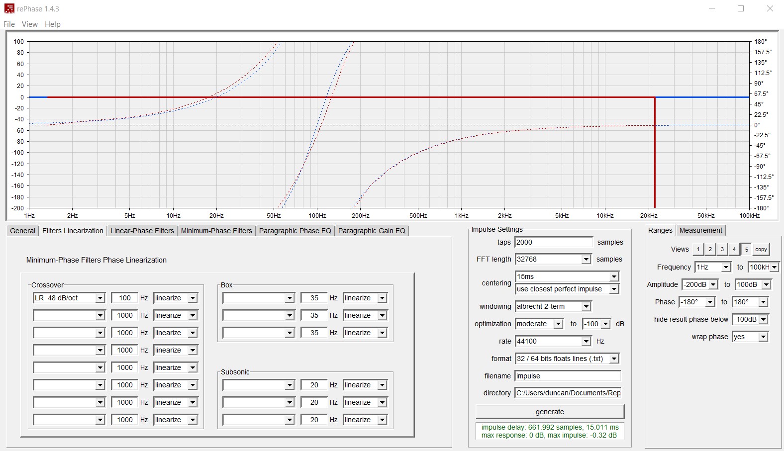

I can get good agreement linearizing the phase only of an LR96 at 100Hz with 4096 taps which is about 46ms latency.One thing I've yet to find a solution for...is how to get a steep xover at 100Hz with latency low enough for live sound, or any situation that can't tolerate much latency.

Attached is the best I can do with LR8 at 100Hz, 15ms latency and fairly good match to the phase wrap without wrecking the magnitude response.
No free lunch with FIR filters and changing phase
