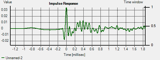

Are there measurements of the Technics SB series anywhere? Would like to see IR and SR to see how close it is to transient perfect. Did they use 2nd order electrical LPF and first order electrical HPF? The 2kHz XO freq and wide band tweeter would certainly support that - and end up sort of like what I did with the FR58EX/AC130F1 project (except I went first order electrical all the way).

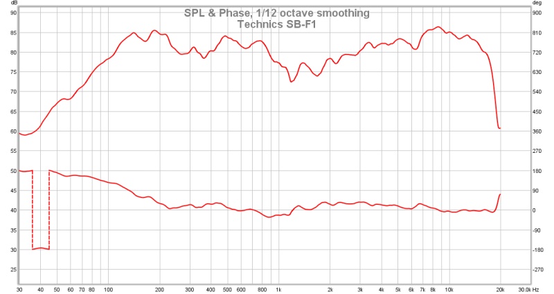

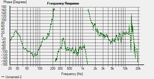

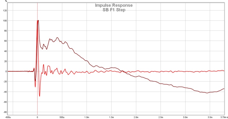

Here you go.
This is a pair I have - they do sound lovely, but are obviously fairly small and volume limited.
If you can get hold of a pair cheaply - I thoroughly recommend!
Nice! The SR does indeed look a lot like a Harsch XO. The little dip in the phase response is also reminiscent of the Harsch. I wonder what the electrical XO slopes are? If possible, can you ever post a photo of the XO if you happen to go inside the box?
You have label of SB F1, is that the same as SB 400?
