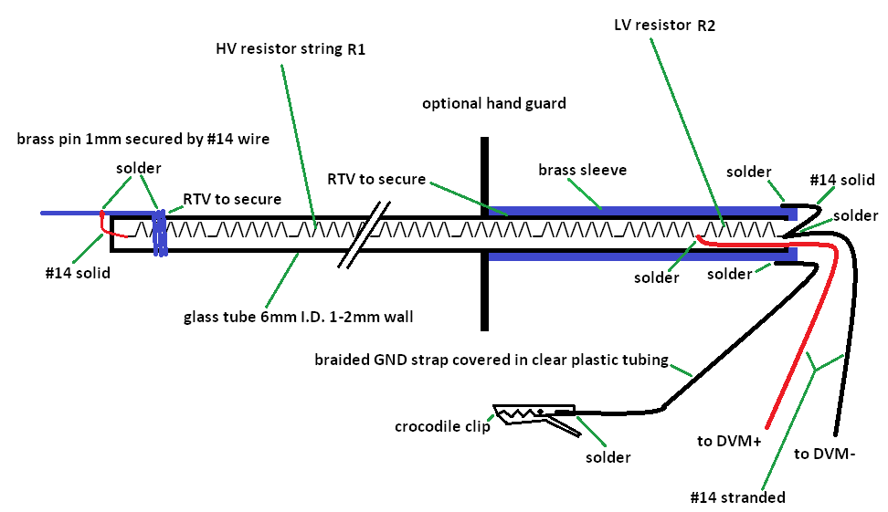

It does not look like high voltage DMM probes have had too much mention but as I sometimes buy used ones and have built a few I could say they all need inspection before use. It should always be inspected before using and it ought to be made in such a way that it is obvious if something is wrong. By high voltage I mean here anything from 1KV up to 5KV Sadly, some professional ones are not made to be inspected and do not give any indication that something is wrong until it's too late.
I like a probe that has its own ground lead and is not just a string of resistors but a voltage divider. I can only address items made for use in the USA.
Many of the cheaper "TV set" type probes, the ones rated 20-40KV, are just a large HV resistor and meant to be used with a 20K/volt meter. If the 'meter' end of the probe comes loose, then the HV will be there at that end. It will be very current-limited but still enough to give a surprising shock. Some of these same probes also do not have any kind of ground in the handle (with a ground clip) designed to be arced to in case of some failure.
A good probe is a voltage divider having a HV resistor in series with a low value resistor. That resistor should be rated 2-3x the wattage it will ever see, so that there is little question of it failing. It also necessarily has a ground lead as well as a + lead for the voltmeter, and should have a lead with a ground clip. The ground clip should be soldered, everything should be soldered.
Lastly for now, a HV probe of the TV set servicing kind is generally not made to be left in place for more than a few minutes on a 25KV line as the resistor will usually overheat. This should be overcome in any home made probe. It can be left on 2-3KV all day.
A home-made probe, which I consider perfectly safe, can be made for use up to 2-3KV so it ought to help with most audio requirements. Above that, it can also be made to handle higher voltages, just beware that glass can be arced through with enough voltage.
It's already been stated somewhere that the BBS is not responsible for accidents. I am also not responsible for actions undertaken by others, even if I said to do it, which I have not, nor if the action was compelled by the devil or spirits or subliminal messages or visions/voices or any other motivation including being too cheap to buy a special probe brand new (like me). If you don't like this drawing then don't make probes according to it. HV experts are welcome to comment, it won't bother me.
I can post the formulas for calculating the value/watts/number of resistors, need to find it.
