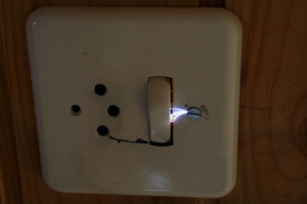

So you lot wanna to live ? My darling spotted this in a heavy thunderstorm and grabbed a snap photo....my lab wall socket is somewhat overused.....
PS.. Don't tamper with the light switch ? It so happened my neighbour had a direct hit and the pulse rocketted through supply live to earth.
richj
