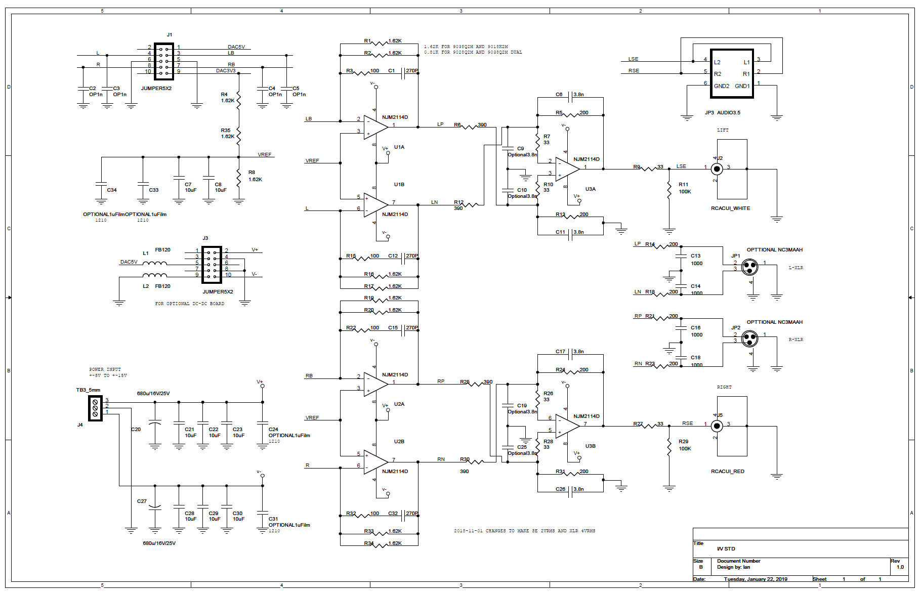

Salas, you said a while back regarding using the amp in an opamp configuration for dac output stage MAYBE could work, but had to be set at gain of at least 2 to be stable.
the schematic is from member «Iancanada» output stage for sabre es9038q2m dac.
So if i would replace last opamp with «DCG3 bare cell» circuit, should i remove the low pass filter caps (c6,c11,c17,c26), replace it with something that sets the pole in accordance to DCG3 build guide, and make sure the voltage divider that set the gain (390R+200R) is 2 and not 1,5 or so...?
Don't want to be really off-topic, so please respond as you see fit, of course. I understand this goes beyond the original intention of the circuit.
Has to be utilized like an op-amp cell with + - inputs, meaning open access to its feedback return node. Following established balanced to SE op-amp arrangements as described in technical articles.
I don't know if it would react badly or not, never had a reason to try it like that. In such a case I would have kept the rearranged networks impedance as low as in its standard application at least.
...Sorry i forgot: the filter could be added after the output stage with a simple RC network if it's left out. For the DC servo, not sure if it's needed because the opamp cell looks like it has it's +- input dc voltage fixed at a value decided by the divider to ground.
Again, i know this is a bit experimental, but i'd be curious to see the outcome!
Yes, some attempt along the thought lines you describe
