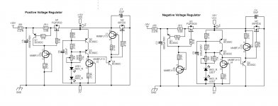

How to calculate Rf resistance?Thank you!
The published schematics are 100% correct. Follow them without hesitation. There are clear and adequate emitter arrows also there. If you will analyze beyond PSUs output polarities you will understand why those semiconductors polarities work that way inside the PSUs.
Rf is a small value below 1Ω to make an RC low pass EMI/RFI filter with C1. 0.33Ω or 0.47Ω is alright. There is inrush current there at power on so it better be small value and sturdy. Just to take the RFI edge off. Classic RC filter calculations apply if you want to quantify the effect. RC Low-pass Filter Design Tool

The rectifier would produce a +dc and -dc right... so that is how I was thinking. Or should the -20vdc simply be gnd ?P.S. If not a typo, don't connect any -20V to the left as shown. There's the GND.
edit
Saw just now your "there's the gnd"... will get right on it
It will produce a train of positive going half sinusoidal peaks in this case.The rectifier would produce a +dc and -dc right... so that is how I was thinking. Or should the -20vdc simply be gnd ?
gnd in place and for the negative version, the gnd and +vdc switch places, is that correct ?
The bridge and parts inside the circuit mirror polarities for negative. The top line becomes negative in respect to bottom line GND.
When you want to use the positive section and the negative section as one symmetric PSU, just bridge their zero lines (gnd) at the output.

And ofc I forgot to move the source resistor for J4 on the negative version, good thing we are dealing with theoretical stuff 🙂
The schematics are already drawn in post1 and guide, why you redraw them? Which drawing software you use?
That is an excellent question and if anyone, you deserve an answer.The schematics are already drawn in post1 and guide, why you redraw them? Which drawing software you use?
I am currently working on an updated Vacuum State Electronics RTP3D preamplifier (and later also the DPA-300B power amplifier), and the Shunt Regulator (SuperReg as VSE calls it) and the Input Signal CCS (JFet based) need some voltage regulation. The original SuperReg calls for an external one and the input signal ccs has a very simple 1 pcs MOSFET regulator. So... I looked around and discovered that the best voltage regulator on the market is your UltraBiB, so that is what I went for.
Why I am redoing the schematic, well, I also want the regulator to be physically close to the circuit it is suppose to feed, so the Shunt Regulator & CCS (separate circuits) gets one UBiB right on the PCB they will be mounted on in close proximity to reduce parasitic C and L 🙂
The software I am using is called EasyEDA, its basically a PCB CAD software from JLCPCB. I like it. Easy to work with, fast learning curve, online component database and there is all the tools one need to either create or modify symbols and footprint.
