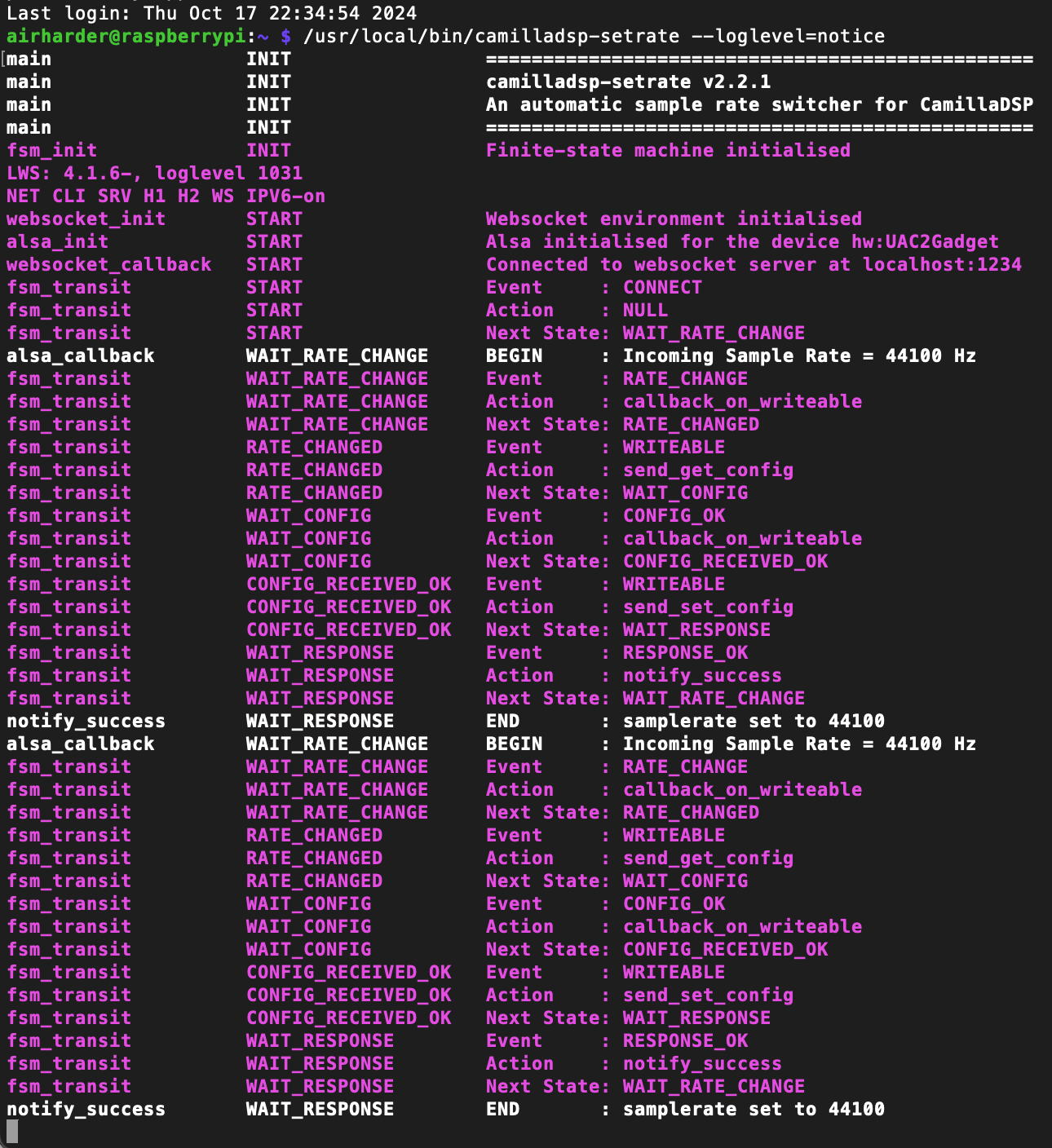

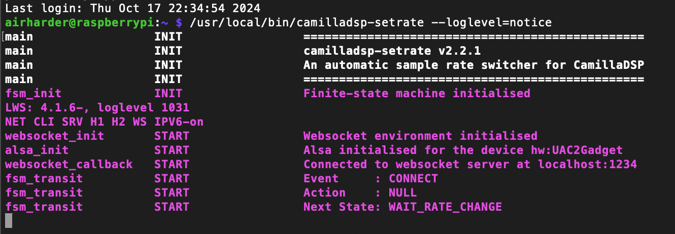

Please have a look at the attached screenshot. For me this looks like the camilladsp-setrate process initialization completed with success. You find a second screenshot, that shows what happens when I start a track with 44.1 Khz and then switch to a track with 48 Khz. This time it didn't recognise the change in sample rate. By the way rate adjust is enabled, see screenshot. Regarding the capture device selection: hw:UAC2Gadget doesn't work for me with the Wiim Ultra USB out. I tried several devices from the drop down menu and this is the one that works for sound output: plughw:CARD=UAC2Gadget,DEV=0.
Now I just changed the device again to hw:UAC2Gadget -> didn't work -> then again plughw:CARD=UAC2Gadget,DEV=0 and played a track with 48K, samplerate got recognised just fine! Then skipped over to a 44.1 K track, this sample rate switch also got recognised - > then went back to the 48K track -> and here the sample rate adjust failed - it got stuck on 44.1K.

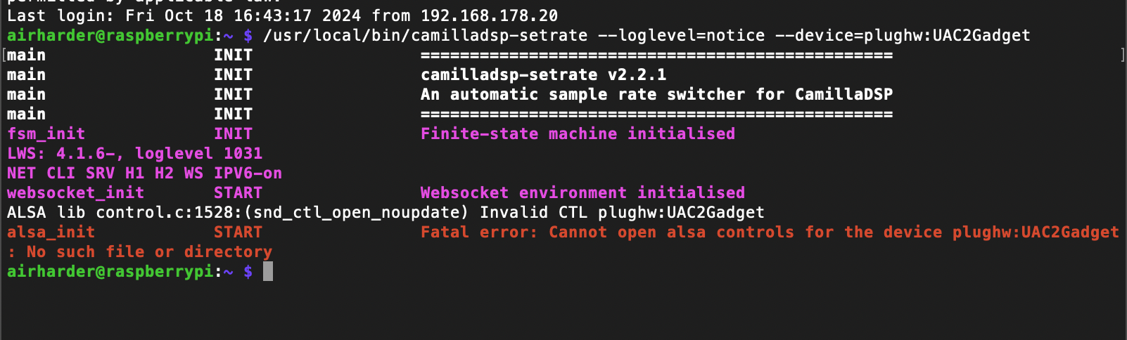

I just tried this command from your important note:
/usr/local/bin/camilladsp-setrate --loglevel=notice --device=plughw:UAC2Gadget
-> I'm getting this error message (see screenshot for details):
ALSA lib control.c:1528🙁snd_ctl_open_noupdate) Invalid CTL plughw:UAC2Gadget
alsa_init START Fatal error: Cannot open alsa controls for the device plughw:UAC2Gadget: No such file or directory
Not quite sure what to do from here.

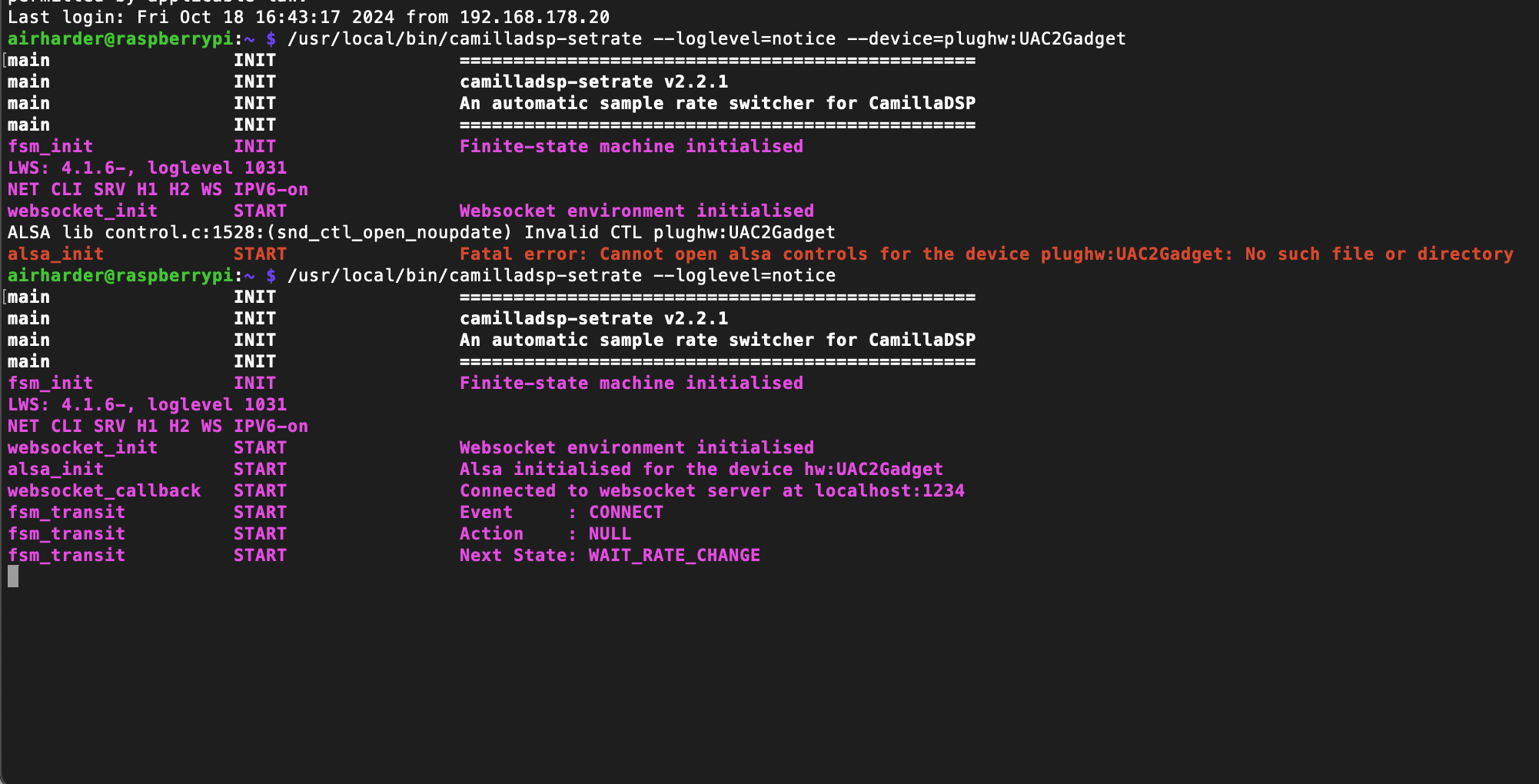

After running the above command, I tried this again: /usr/local/bin/camilladsp-setrate --loglevel=notice
it doesn't seem to recognise any sample rate or anything when I play a track - see screenshot. This now seems like a little step backwards.

@Airharder :
Please do not post screenshots if a text copy (wrapped in the CODE tags, of course) can be sent. It's MUCH easier to read, can be searched through, longer text can be posted.
If plughw works and hw does not, most likely your CDSP capture params do not fit the gadget params. What are your gadget params? My 2 cents S24LE is being considered as 24 bits (c_size=3), instead of S24LE3, a very common issue.
That's correct, the alsa controls require hw devices or pcm devices with defined ctl configs. IMO if you fix the very likely format issue and make hw:UAC2Gadget work, this issue will be fixed automatically too.

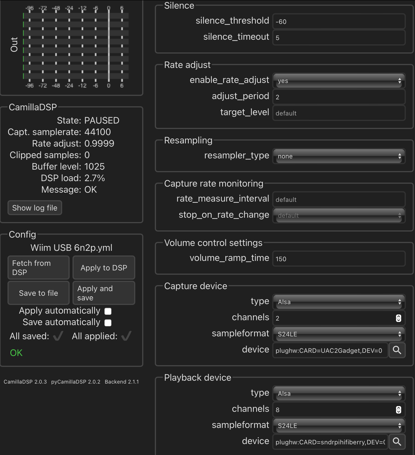

Thank you, I'm still learning my way here in the forum - will post the code directly in the future (thought it's better to avoid these long code posts). Is there any special way of doing this right? When I copy the code from the mac terminal window, and paste it here, it usually enters many blank lines, that I feel like removing manually. Is there any better way of copying/pasting code here?
How can I set the CDSP capture params correctly then? I have changed the capture device sample format to S24LE3 - hw:UAC2Gadget still doesn't work. Generally I'm always trying different device sample formats. So far only the plughw:CARD=UAC2Gadget,DEV=0 is working for me. Any idea how I can fix the format issue and make hw:UAC2Gadget work with the Wiim Ultra USB out? Is there any setting I have to apply with the command line or anything I should change in 85-DAC.rules or camilladsp-setrate.service?
No need to try/error. Just use the same params as those assigned to the g_audio module (or configfs params, should you use that method).
You can check accepted hw params of any alsa device with --dump-hw-params parameter of aplay/arecord. E.g.

@Airharder
Yes, from the first two screenshots we can take that initialisation was successful and that actions after a sample rate change are carried out as expected.
The second screen puzzles me, because I see that the sample rate 44100 appears twice in a row, where only changes should be recorded. A fanciful hypothesis is that the second notification refers instead to the 48KHz change and that, for some obscure reason, the alsa control returns the wrong value 44100. The latter phenomenon could be related to an incorrect format as @phofman suspects.
I forgot to recommend you to stop and disable the camilladsp-setrate service before running the process manually:
sudo systemctl stop camilladsp-setrate
sudo systemctl disable camilladsp-setrate
I am not an alsa expert and had missed that information. Thank you.
Or maybe the USB host side goes through some audio mixer (pulseaudio, windows audio mixer, ...?) which always resamples to a fixed samplerate, no matter what the source track samplerate is. It might look as it should be playing at 48kHz, while in fact everything is being resampled to 44.1kHz. Just 2 cents...

Well, I changed to S32LE but I still don't get any sound with hw:UAC2Gadget
Then more issues are in your chain. CDSP logs will likely tell more. As I said this is not trivial to setup right and often does not work at first try. That's why it's important to start with the terminal and work layer by layer up to the fully working = correctly configured appliance.
I can choose "hw:UAC2Gadget,0,0" or "hw:CARD=UAC2Gadget,DEV=0" from the drop down menu.
Well, the GUI config is another layer. I would recommend to modify the CDSP config file directly, no extra layer of complexity. But your choice...
Device ID 0 and subdevice ID 0 are defaults, no need to specify the zeros. If you wanted to use device ID 1, then you would have to specify either hw:CARD=XY,DEV=1 or simply hw:XY,1 . Always use the card name instead of its ID as the card ID can change between reboots. Device/subdevice IDs are hard-coded in the device driver and do not change.
