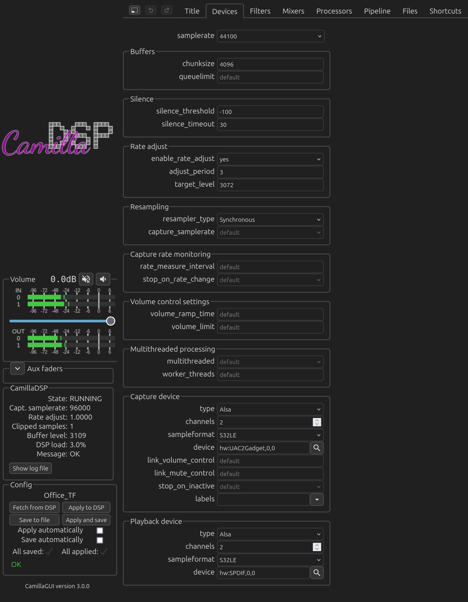

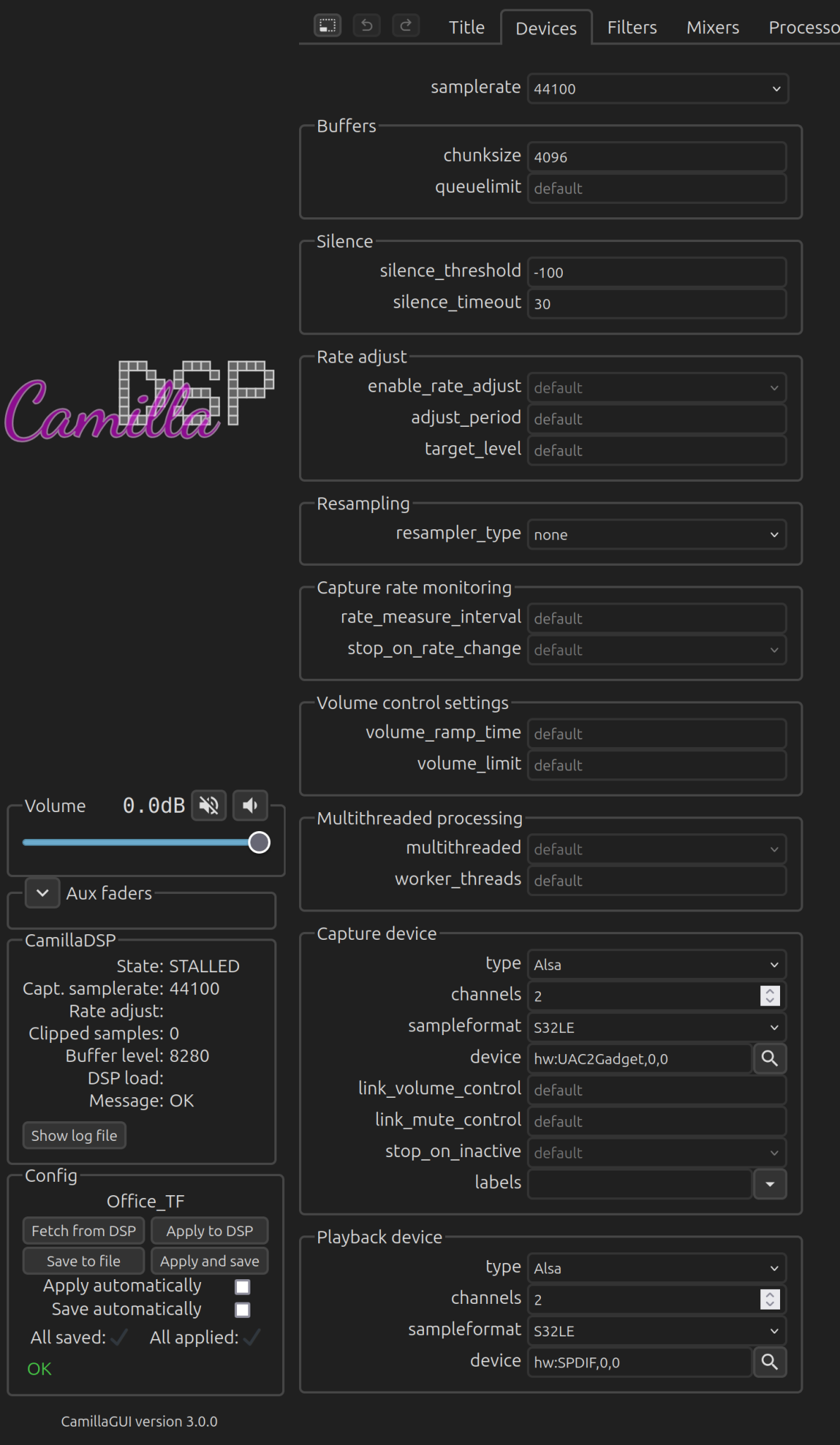

Hi @mevang, let's give the camilladsp-setrate another try. Here is quickly my status:I would suggest adding 176400
Capture device: hw:UAC2Gadget -> works
With this code line in /etc/modprobe.d/usb_g_audio.conf:
Code:
options g_audio c_srate=48000 c_ssize=4 c_chmask=3 p_chmask=0
I get sound everything works well, but sample rate is stuck on 48000 Hz (to be expected).
When I change the code line in /etc/modprobe.d/usb_g_audio.conf to:
Code:
options g_audio c_srate=44100,48000,88200,96000,176400,192000 c_ssize=4 c_chmask=3 p_chmask=0

I guess, this line might give the hint where the issue can be found: Capture error: ALSA function 'snd_pcm_hw_params_set_rate' failed with error 'EINVAL: Invalid argument'
Just one thing to know: I use 6channels of the HifiBerry DAC8X (2x Hi, Mid, Low) so I also tried to set c_chmask=63 for 6 channels in usb_g_audio.conf
Code:
options g_audio c_srate=44100,48000,88200,96000,176400,192000 c_ssize=4 c_chmask=63 p_chmask=0
Else please see my device settings screenshot attached. I still get no sound. Any idea what I'm missing here?

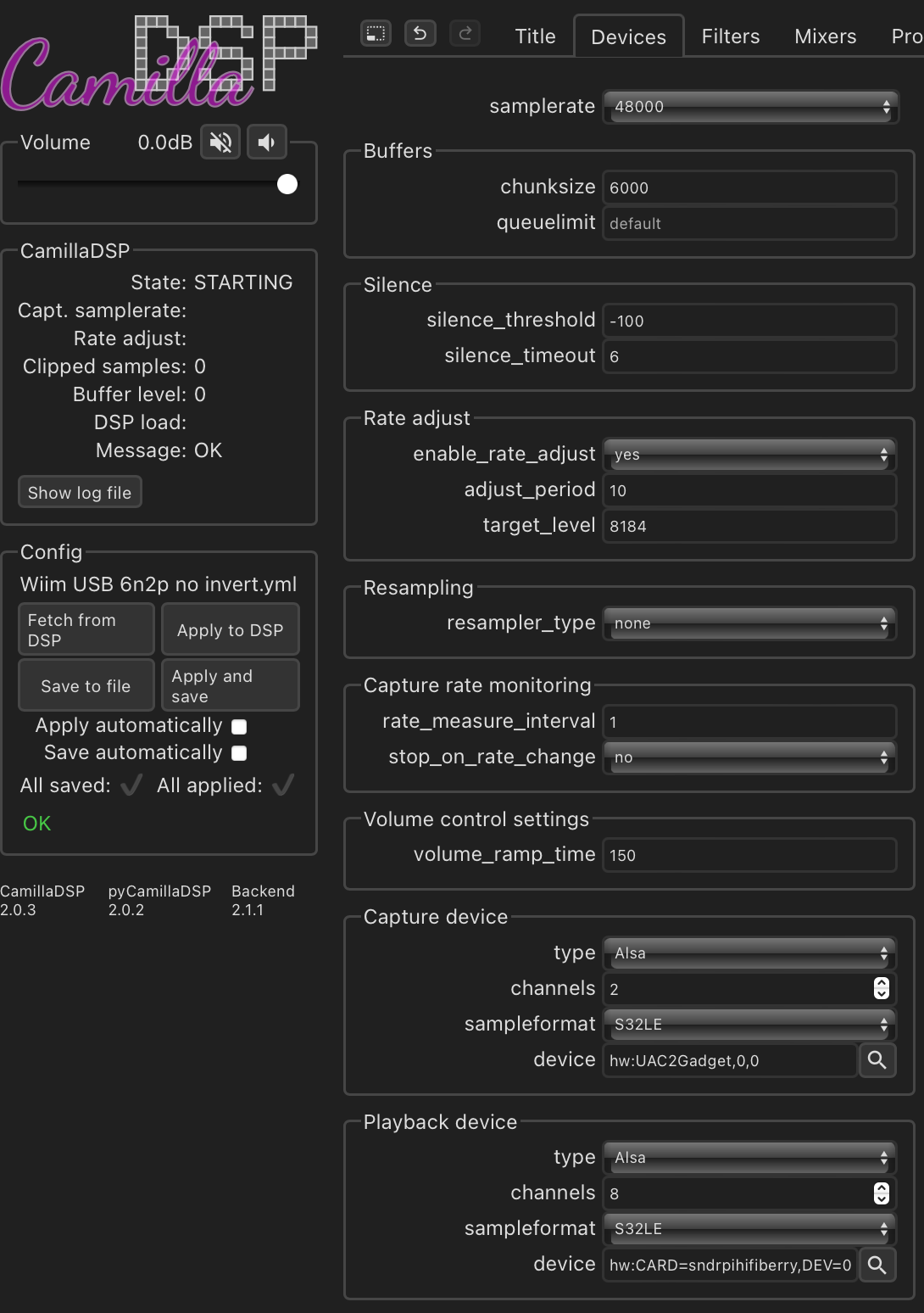

As already told, camilladsp is responding with an error message to the configuration update command sent by camilladsp-setrate.camilladsp-setrate is recognising the different incoming sample rates, but can't set the DAC sample rate to the incoming sample rate - see below:
The log file produced by camilladsp indicates that something in the configuration is wrong. Please run camilladsp-setrate with theHere is the CamillaDSP logfile:

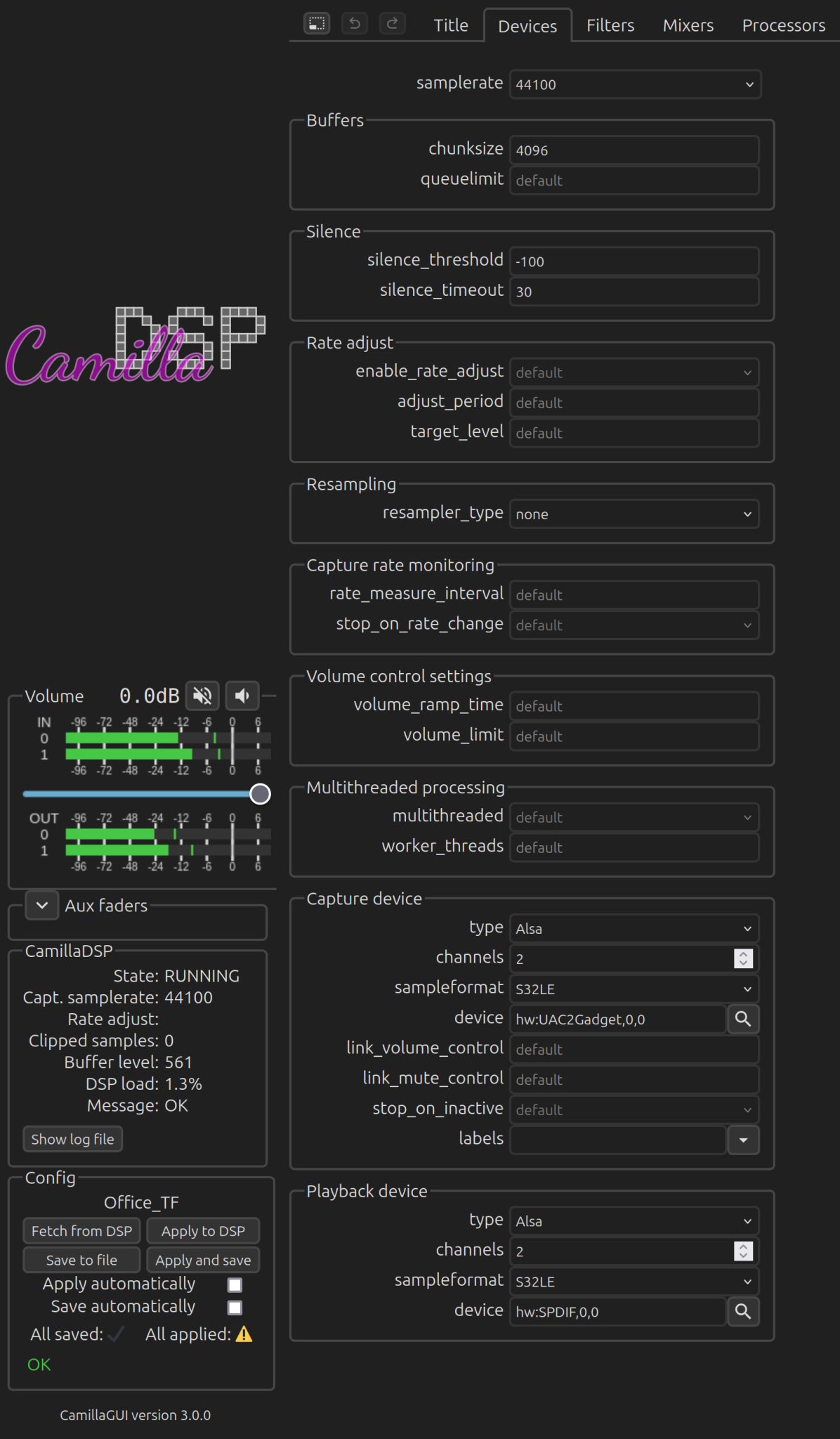

Just a post that may be helpful to others upgrading to CamillaDSP version 3.0. I have simplified my CamillaDSP configuration after upgrading to version 3.0, and camilladsp-setrate is working well for me, even better than before. Here is a screen shot of my Device tab:
Notably, previously I had Buffers --> chunksize set to 8192. I was experiencing an issue where the samplerate would adjust fine when samplerate increased, but not when it decreased. My CamillaDSP log file gave an error that 4096 is the maximum buffer chunksize. I changed it, and the problem went away.
Also, the format of the configuration file has changed. Importing the old configuration files only worked if there were no filters specified. Once I had the Devices tab and Mixer tab configured in the new configuration, I setup my first filter and saved that. Then I copied the rest of the filters from my old configuration document into my new configuration document. I then went back into the GUI and setup the Pipeline. That worked well for me. Of course, you can create your filters anew if you so choose.
The main difference that I see is the in how the "Pipeline" is configured in the new version. Once I had the Devices tab and Mixer tab configured in the new configuration, I copied the filters from my old configuration document into my new configuration document, then went back into the GUI and setup the Pipeline. That worked well for me.

I have been playing music for a few hours and the buffer level was around 6600. I just set "enable_rate_adjust=yes" and the buffer level is hovering around 2000. I'll keep an eye on it.
EDIT: Have "enable_rate_adjust" set to "yes", and the buffer level is back up over 6000.
Rate adjust is disabled unless specifically enabled in the config file https://github.com/HEnquist/camilla...7e436de888c24c17182b63d051/src/config.rs#L640 . Also the rate adjust is closely related to option target_level which specifies, how large a buffer fill the rate adjust will try to maintain.I assume it does because camilladsp-setrate is working without any issues.
It's always good to look at CDSP logs when setting up the project - you should see this info-level entry https://github.com/HEnquist/camilla...6de888c24c17182b63d051/src/alsadevice.rs#L792
As of the complaint about maximum chunksize - the gadget alsa device has maximum buffer size of 16 * pagesize 4kB = 64kB https://github.com/torvalds/linux/b...b55/drivers/usb/gadget/function/u_audio.c#L26 . That corresponds to 8k samples at 32bit/2ch. Since CDSP requires at least two chunks per buffer, 4k per chunk is maximum.
My camilladsp.log does indeed indicate "Capture devices supports rate adjust". Also, my journal log entries after I changed the chunksize to 4096 look clean.
Nonetheless, I updated my Devices configuration based on the above comments. Now it is as follows. Please let me know if you have any further suggestions:
EDIT: After setting "enable_rate_adjust" to "yes" my camilladsp.log gives the following warning: Needless 1:1 sample rate conversion active. Not needed since capture device supports rate adjust
The fact that the capture device supports rate adjust allows you to do without resampling, which would otherwise have been necessary. In any case, if your player and camilladsp have distinct clocks, the rate adjust option must be enabled.My camilladsp.log does indeed indicate "Capture devices supports rate adjust". Also, my journal log entries after I changed the chunksize to 4096 look clean.
If you can afford larger latency, I would recommend raising the target level to 3/4 of the buffer size for timing safety. Right now your timing safety is around 30ms (3k of 96k).Please let me know if you have any further suggestions
