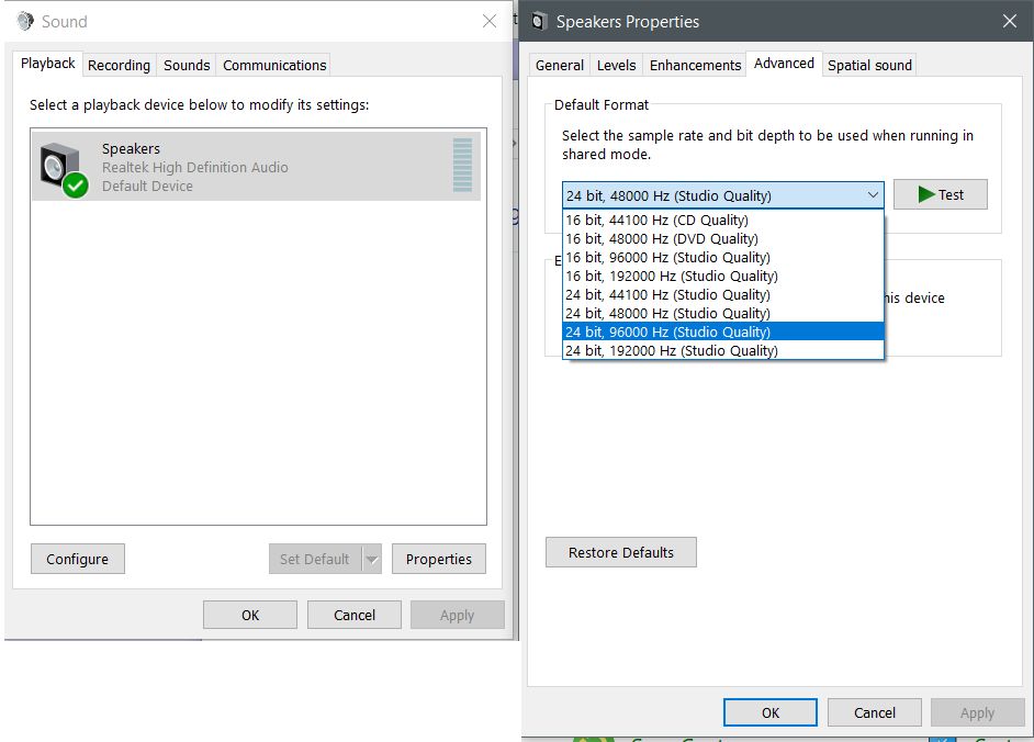

Windows Sound Engine resamples audio by default if it does not match the setting shown on the right in the attached image. Also, Windows does not do very high quality resampling, so better to avoid it if getting best sound quality is an important concern. A combination of using ASIO drivers and configuring Windows Sound settings correctly is the most reliable approach.
