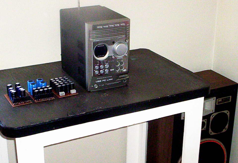

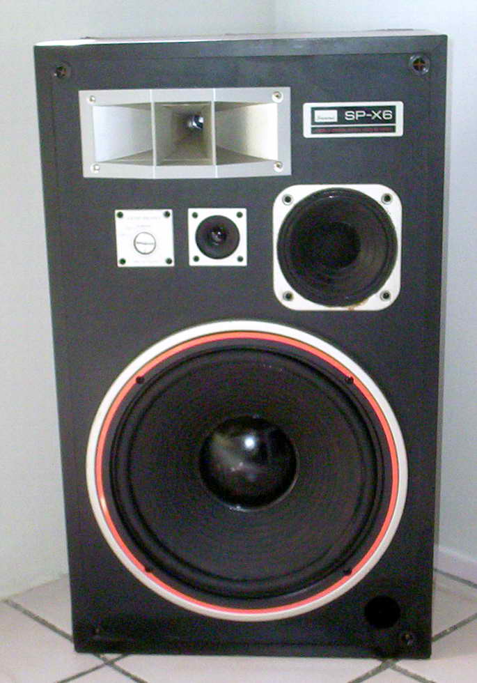

This makes a lot of sense.
The bias was drift.... also the trimpot... put a dot into the trimpot
and other dot of alignment around, as reference to return the trimpot to almost the same previous position.... and turn it many times from maximum to minimum and opposite.... i use WD40 while doing that... it is good to remove dust, oxide and to check the trimpot..if bad...you will see this fast... and better to discover that before sniff smoke.
You will be able to zero the offset.... and it will have drift because heat.... but...better not to give another touch.... adjust it almost cold after 2 minutes of warm up.....
You will see that we do not perceive small offset differences...but bias differences are easy to perceive.
Have you watched thread...our threads about Dx?.... the Speaker Sansuí...hehehe...sounding very nice..... i like it.
To clean your panel the WD also works....but..... have to be removed with a dry cloth...as if stay too much long my melt the white printed names you have over your panel.... test it in advance.... a little bit oiled and polished turns beautifull.
Have to apply and remove, it is able to remove dirty, but has to be removed...not entirelly removed, just a very thing surface will remain that will dry after a couple of days.
Also too much friction with cloth produces static that attracts dust into it too...so..... is able to make it pretty, but not for too much long as dust will "land" into your panel.
Using some times each month things goes fine.... easier to remove dust with a soft brush after cleaning this way...also finger prints will disappear... pieces of cake, biscuit and so on..ahahahah
WD40 and turning potentiometer many times use to remove almost all noises from the unit.
