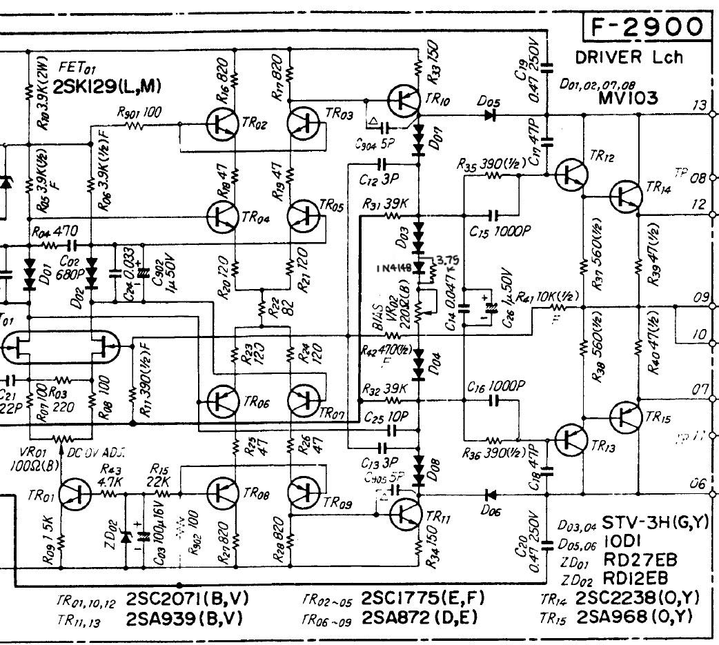

Sansui G22000 with Updated Transistors/Low Power Output
It's what I had in stock.
And you have to admit, its a valid reason 🙂 This amp is certainly a problem child.
Still scratching my head on this one...
Me too. It just doesn't compute. Mad thought... you are using the same dummy load for testing each channel ? In other words your load for that channel really is 8 ohms and not something lower. Sorry... had to ask 😀
