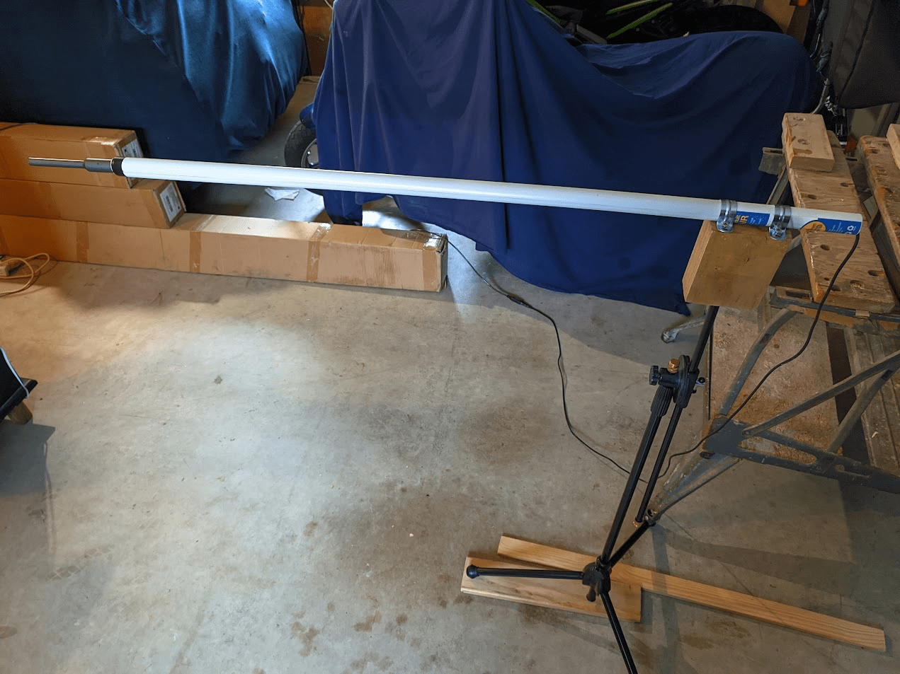

Two tips for taking measurements.
1. Don't put pillows / soft furnishings on the floor in an attempt to absorb or reduce reflections. You want hard surfaces! This makes it easy to spot the first reflection ripple. Basically with gated responses, you want as many hard surfaces as possible in your listening environment, so you can spot the first early reflection easier therefore set the gate with confidence. Little ripples in your response (especially below ~ 1KHz) are indicative of a reflection sneaking into your response (gate set too long)
2. Put your mic on a long boom. I used a piece of "PVC repair pipe" of a suitable diameter for your microphone. It was already split in two halves. I got from Mitre10 / Bunnings The clip / stand most people use will cause high frequency ripple in the response. You want your boom length > distance from mic tip to speaker (i.e. keep the stand out of the "sphere of measurement"). Here's mine:

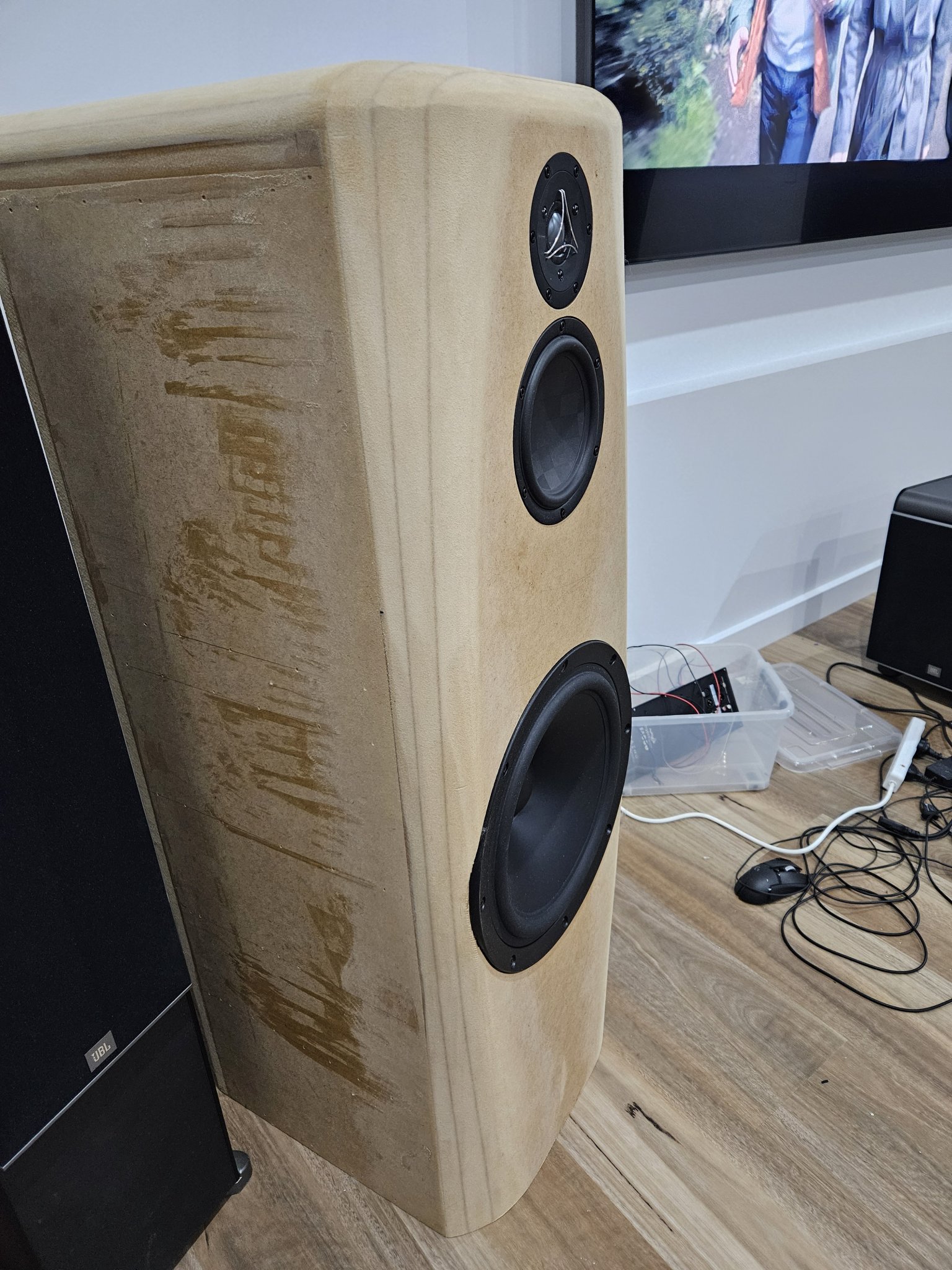

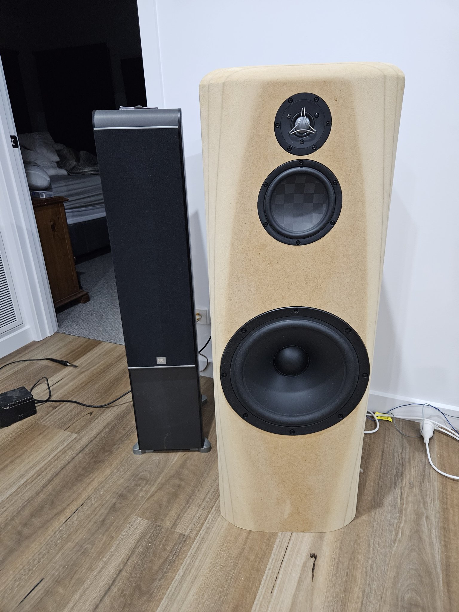

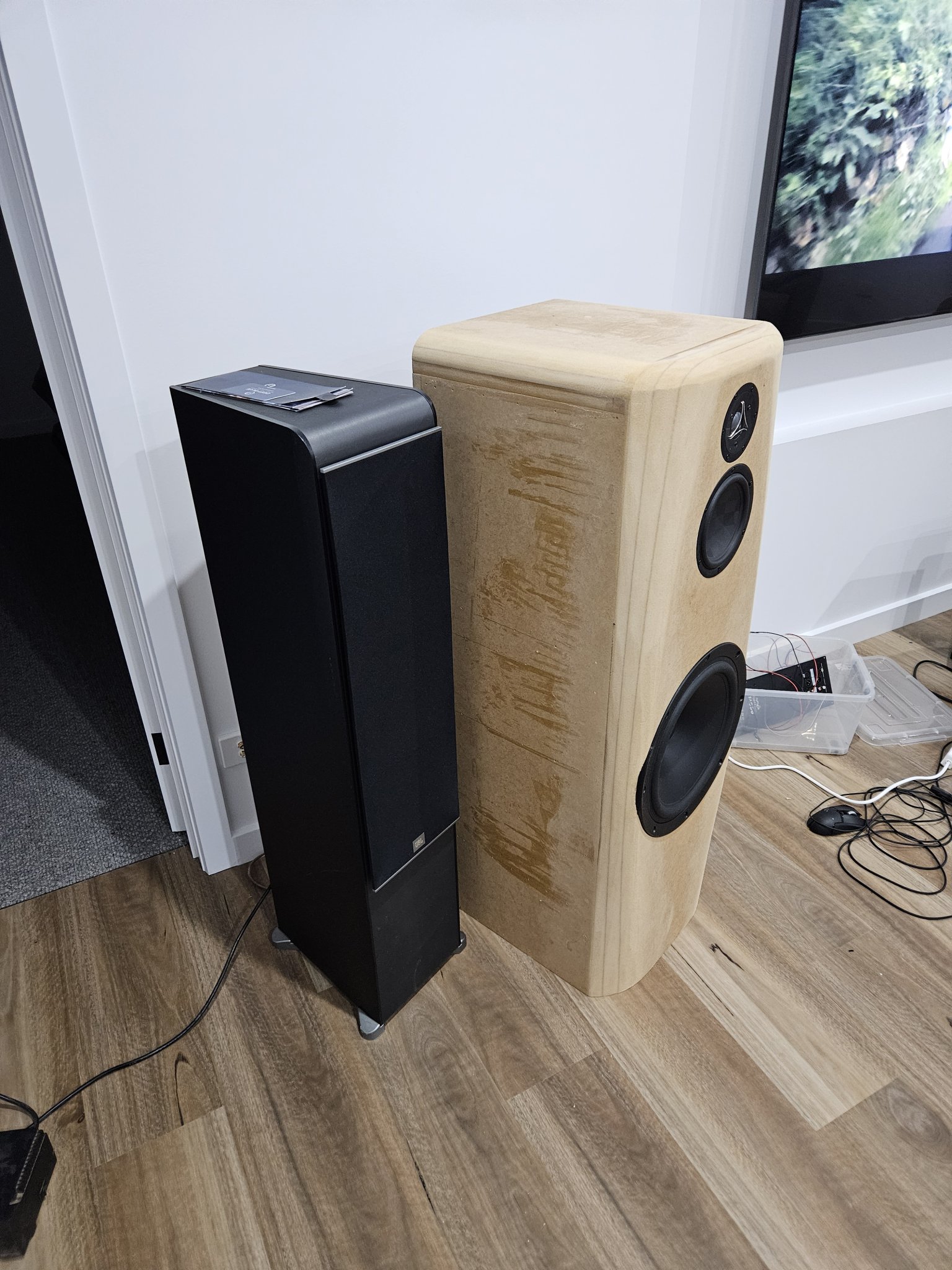

Hi guys,
Glued on the front baffle yesterday so gave the front a quick sand. Loooots more sanding to do on the sides etc due to using bulk glue to make sure it sealed properly lol.
A few pics attached, they are monsters. I could just lift them without the drivers in them.

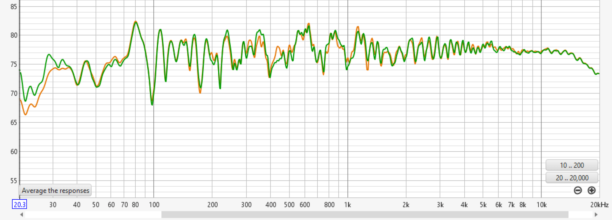

I'm going to start playing with the Hypex crossovers, I'll add that Highpass/PEQ, whichever you think is better, what frequency am I aiming at for that?
Edit - Just done a quick in room rew measurement, 1m on axis with tweeter. Currently all 4th order to get me started, 1600hz & 200hz.
3db cut on the tweeter, 5db boost on the 12".
Green plot has 3db shelf boost on the 12" at 30hz just experimenting.

Looking very good 👍
But - could you try and do a gated measurement at 0, 10, 25 - until 90 degrees, in the horizontal plane, so that we can see exactly what is going on in the crossover region of the midrange and tweeter?

Hi all,
Project is still active, Currently the speakers are at the painters getting 2pak painted. Going with white for something different, should be a nice contrast to the black drivers.
They have been at the painters for about a month now, they are just slipping it in between jobs, for beer money, so I can't complain lol.
I will have lots of testing to do once i get them back, the only problem is, is that I basically can't lift them with the drivers in, they are damn heavy.
So i'll have to work out the best way to get my testing done.
Sorry, I meant to say that from the photos it looked like your shape was rounded more than what I've seen in other baffles where just the edges were rounded.
If you've seen Soundblab's YT videos he has a couple of speakers where they are cut on a table saw.
Thx
Ahh ok I see.
Yeah the idea of that was basically to fix the same problem. I tried to get the roundover to start right up near the tweeter.
So for a bit of a feature, i did a variable roundover along the whole length of the speaker, so it sort of looks symmetrical.
Normally people might use a huge roundover/router bit, but I have a CNC router, so i could make it whatever i wanted.
