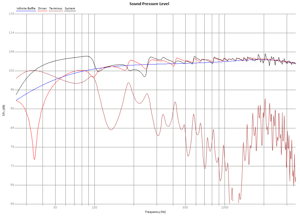

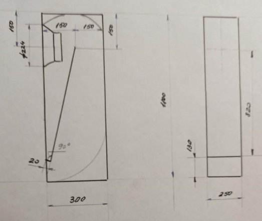

Do you know the T/S specs for the drivers that those were designed for? if the SB20FRPC30 isn’t a close match then I’d model it before putting all the effort into them.
If you can give me detailed dimensions of each, I can do a quick model for you. I just use the Leonard Audio TL modeler.
And yes, you’ll need some baffle step comp at a minimum imo.

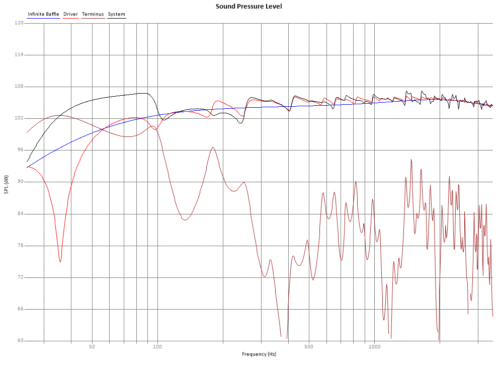

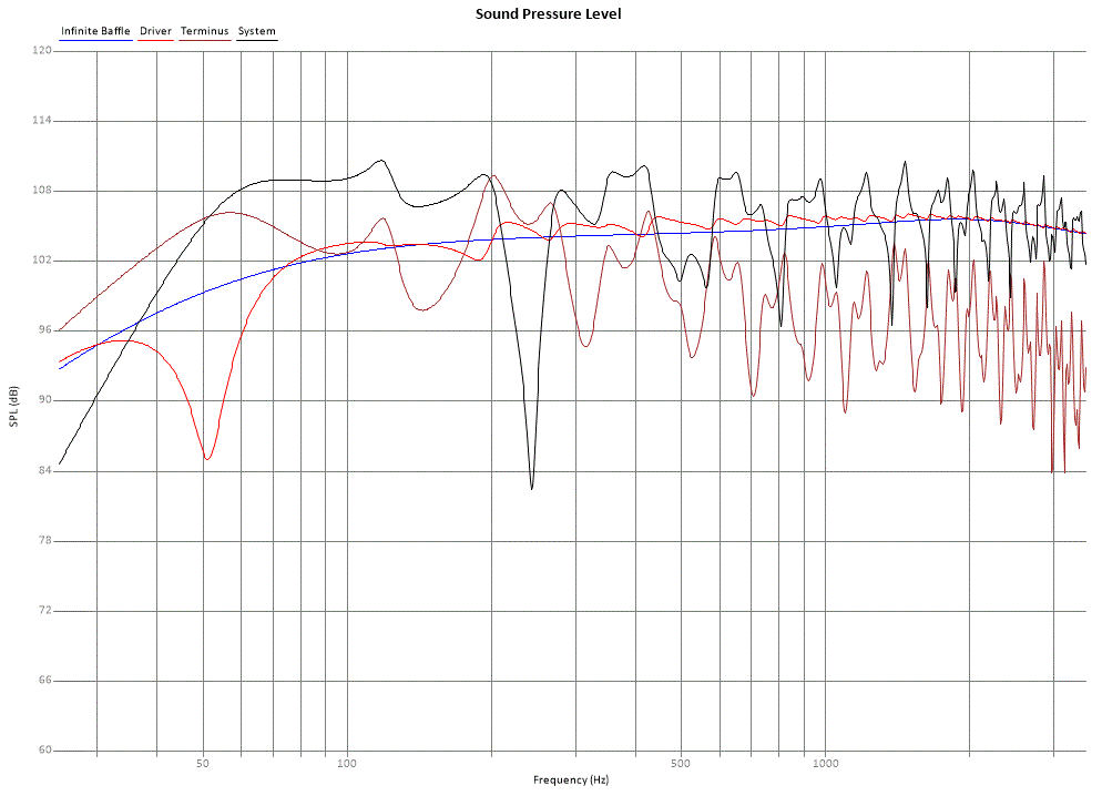

Victoran, I modeled the standard enclosure for you based on the dimensions provided. I didn't round the corners since I don't have any way to do that, so the enclosure is larger than indicated at about 86L. I'm not an expert on TL's, so take it with a grain of salt, but I think the terminus is too large, tuning the enclosure to over 50Hz assuming 3/4" material. You could replace the square opening with a port equivalent to a 3" port, 2.5" long for OK results with an f3 around 36Hz, max SPL about 106db and vent velocity under 15 m/sec. I lightly stuffed the line in the first 1/3 or so for all iterations. Here is what I got, the first one is as designed, the second one with a port a few inches from the end (exiting front) and the third one with the port at roughly 8" from the end (exiting rear). I'm sure it could be further optimized by someone that actually knows what they're doing, LOL! Hope that helps.
Fyi, if you moved the terminus to the rear, it would help eliminate any unwanted port noise at the listening pos.

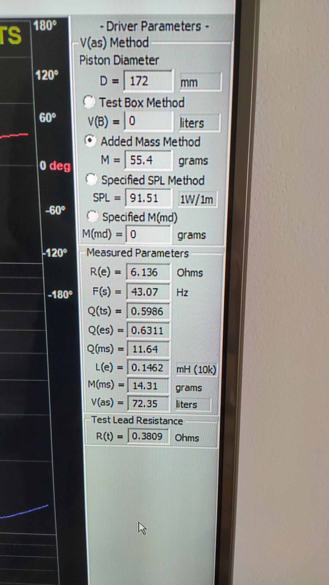

I am fascinated by the driver. I break-in it +-5mm 20hz for two hours. measured the T/S parameters and they are literally the same, both break-in and stock driver. Fs didn't move. The impedance is literally the same on both drivers throughout the entire frequency spectrum.
