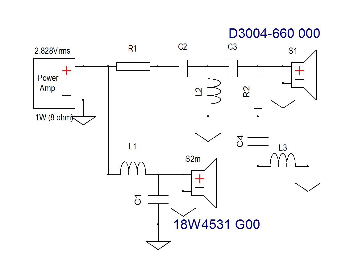

How do you feel about crossing it at 1.75kHz with the D3004/662000 iluminator tweeter?
@ dot and marley, I'd vote for the first rule to be to simulate the speakers first.
@akarma: this simulation shows that SS 18W4531G00 can be low passed sufficiently good at about 2 kHz with just a simple 2nd order electrical filter. That it will sound very good with any tweeter of equivalent quality, high passed in the same manner, goes without saying even though newby DIYers may have trouble believing it.

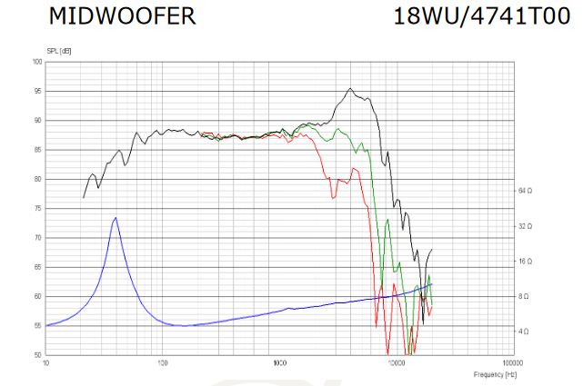

The enthusiasts always follow these sort of threads, perhaps because we are trying to fix the wounds we still carry from grappling with the horrible 6" plus 1" speaker. 😱
Why is it a horror?
* Worst time alignment problems of any two way.
* The 4-6kHz cone breakup.
* The tendency to needing low crossover with all the usual tweeter problems.
Now add the 6" scanspeak horrible frequency response, and we have a complex crossover and maybe a difficult cabinet construction to try and fix the phase.
This is entering a World of Hurt and constructional expense, IMO. 😱

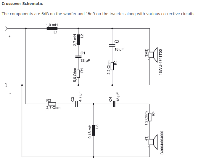

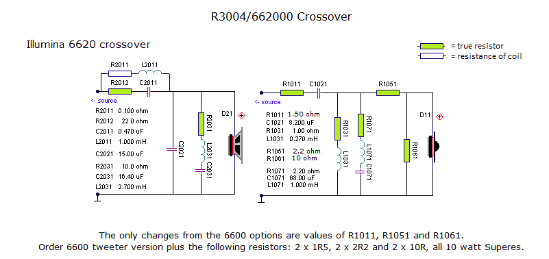

For the (IMO) horrible 18WU/4741-T00, we might consider Troels' Illumina-66 with the ring radiator:
Illumina-66
And the flat baffle NADA 2-way with beryllium tweeter:
NADA 2-Way Klang + Ton Kit Pair using Illuminator Drivers
Crossover enthusiasts will understand these two designs immediately. Both crossing around 2.7kHz. A lot to like in both of them in engineering terms. But would I take them on? No. I think there are much easier and more cost effective ways to build a good speaker.

Looking at the Illumina 66 I believe that the chosen woofer (the illuminator 18WU/4747T00) looks worst than the revelator 18W/4531G00 that I choice if combined togheter with the 662000 tweeter. I would go for these two driversHaHa! 😀
There's no problems with linear response. It just sounds dull and boring. MW16P has some transparent and more sparkle midrange. SS18W puts out good bass for its size and that's all. It's my opinion after comparison.
And SS18 is very mediocre on high side. XOver must be low enough. At least 1.7-1.5kHz
Exactly!There's no problems with linear response. It just sounds dull and boring. MW16P has some transparent and more sparkle midrange. SS18W puts out good bass for its size and that's all. It's my opinion after comparison.

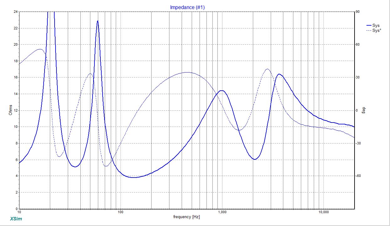

There's no doubt that 4 ohm 6" bass is easier to deal with than 8 ohm in the filter.

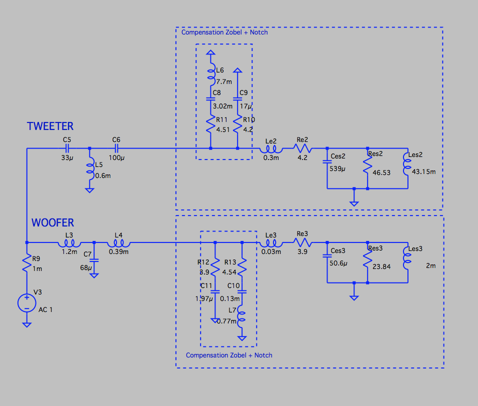

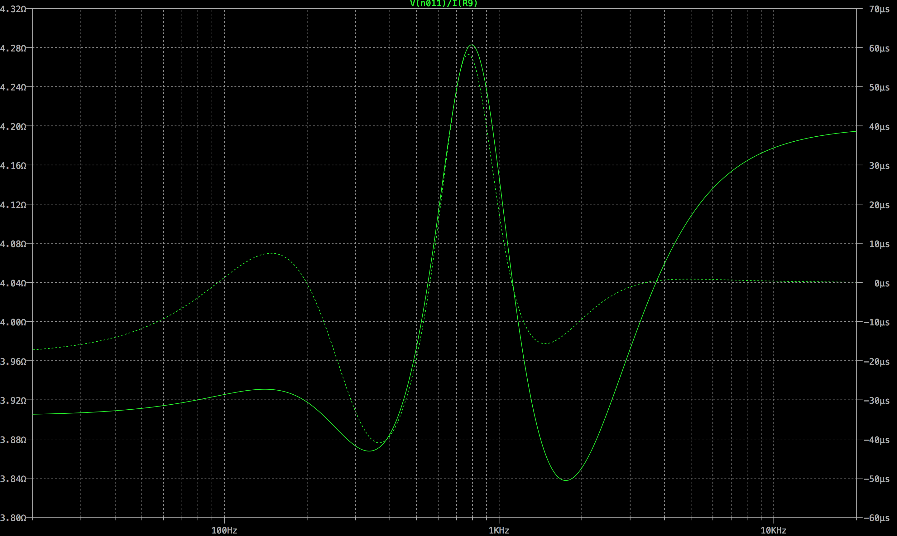

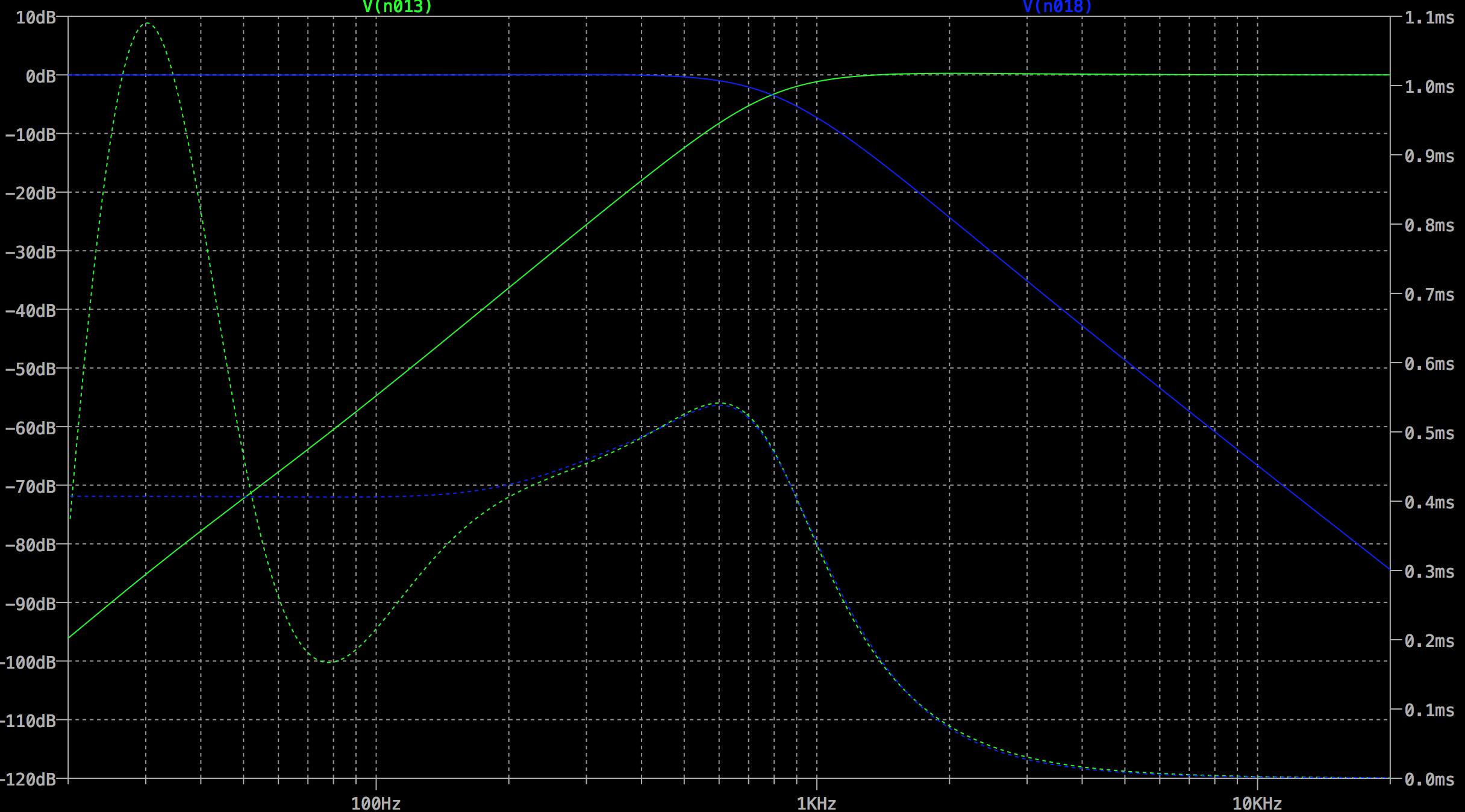

Moving forward

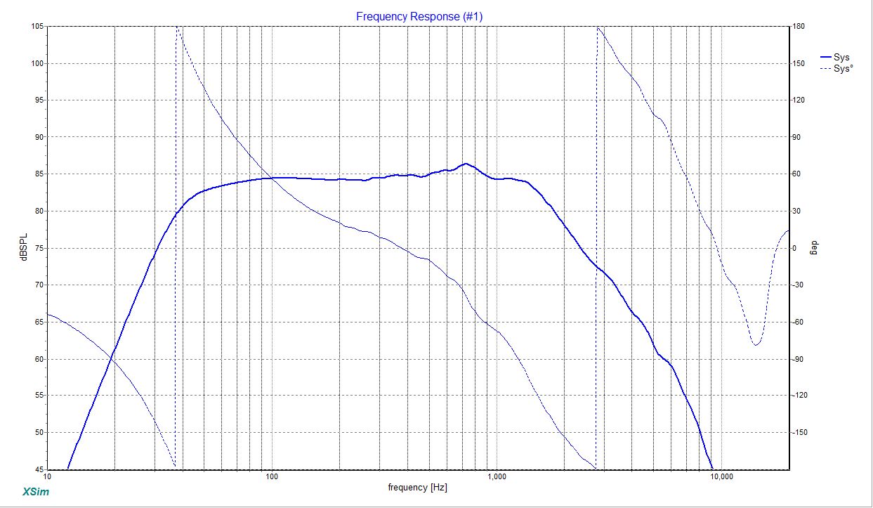

Before buying the drivers I'm simulating using their electric model, zobel and notch compensation, and I ended up with this BW3 crossover, I attach you some pics to get an opinion about that.
I still miss some components to compensate the cabinet, but I'll keep simulating as soon as I decide the model
Crossed at 800 Hz. I don't think 1" driver can go that low.
Your simulation lacks measured frequency response of drivers.
+1 Lojzek, That's what I did, though I did add a Zobel and notch filter. Even so, Madisound has produced at least 2 crossovers with the 4531G in a 2-way at 2kHz. One a 2nd order, one a 3rd.
This driver does just fine. The real issue IMHO is getting a tweeter to match at 2kHz. The 15W would be better options due to higher XO with almost as much bass, which the 18W/4531 is outstanding.

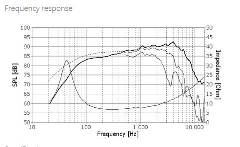

The 18W/4531 measures much better than spec re: FR at the top end. It's an easy crossover to make at 2 kHz. And you get really awesome bass for a 2-way. Much more impressive than say the Magico S1 Mk II.
This limits your tweeter selection however. Larger AMT's, and dual magnet selections from Peerless and SS are going to be very good choices, but also some of the deep-chamber varieties, which SS has in soft/ring and even Be.
The Peerless XT25BG would be a great choice, though the SS version has lower distortion.
If you stick with SS, the 15W helps you out with a higher XO, but also higher f3.
In either event, the SS demand a big cabinet.
A much easier 2-way mid-woofer is the FaitalPRO 5FE120. That can be crossed over at 3-5kHz easily, with great dispersion characteristics. This really opens up your tweeter choices, and fits in a 0.25 ft3 cabinet. You won't get the huge bass, but it is much easier to design, AND the smaller cabinet easier to live with.

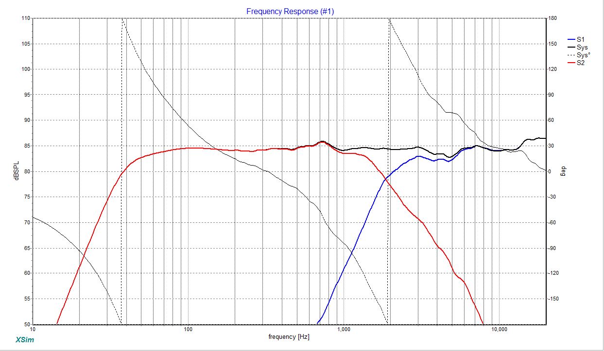

SIM: 18W4531 G00 & D3004-660 000
