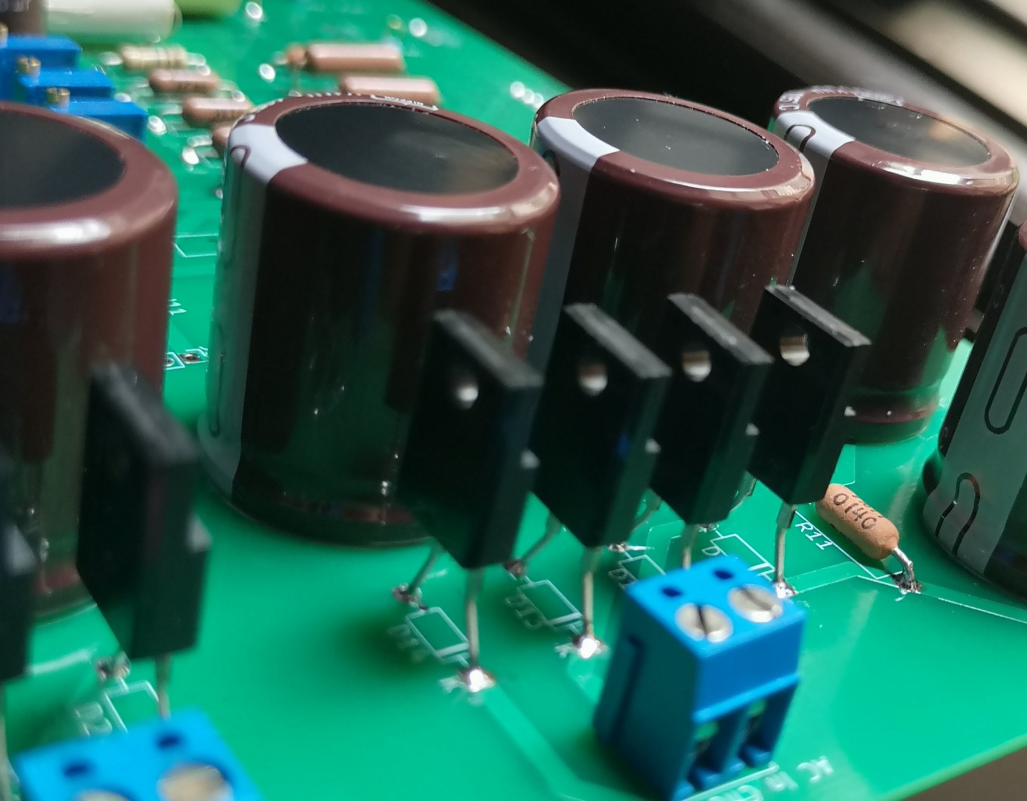

Can you post a picture on how you mount the MURF1060 to the pcb ?
Thanks.

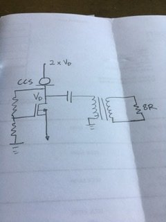

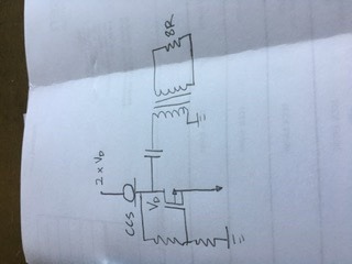

Awesome! Really looking forward to what you come up with. I have been thinking about it also and I was wondering if a high voltage low current version is better than a low voltage high current version. Here's a thought:I have collected all the parts for an all solid state version of the UNSET which will use some large UJ3N065080K3S SiC fets running on a couple hundred volts into a 600 ohm vacuum tube OPT for the output stage and something similar to this for the gain stage. It is all waiting for space on the bench. I need room for the 20 pound heat sink!
The CCS means double the B+ than with a transformer, but this is not such a problem with SS devices because you can go to a higher current. But if you go to a higher current, then the transformer has to be bigger, and this is the reason for the above circuit. Something like 200V B+ and 500 mA might very well be possible. It neatly sidesteps the problems of this design with tubes. You are not hit with a very high B+, nor do you have to get a really large transformer. But of course, there must be trade-offs. I'm just throwing out ideas that I'd like to pursue.

The circuit you show can be done with a suitable choke instead of the CCS. Tube amp builders call this "parafeed." as in parallel feed. They don't realize that the two inductances are effectively in parallel thus reducing the value of the total inductance. I have experimented with this design using a big sweep tube for the CCS and a KT88 for the output tube. An old experiment is here, new experiments will use bigger output tubes:

A gyrator will work, but much like the CCS circuit, the power supply feeding the CCS or gyrator must be about twice the idle plate voltage to emulate the voltage rise caused by the energy stored in the transformer or chokes magnetic field being turned back int EMF as it is released.

Yes, the transformer is in parallel with the CCS for AC frequencies. I know very little about transformer design, but I read that SE transformers have to big to keep the core from saturating. With this "parafeed" construction, there is no DC current through the transformer.
Anyway, just throwing stuff on the wall to see what sticks.
Ah, I did not the reason for the double voltage was so that it can "emulate" the transformers stored energy. I was thinking about it in terms of voltage swing. As the input signal swings negative, the top of the plate/drain will swing down, and there should be enough voltage above the CCS to make sure it keeps conducting. Am I thinking about this right?A gyrator will work, but much like the CCS circuit, the power supply feeding the CCS or gyrator must be about twice the idle plate voltage to emulate the voltage rise caused by the energy stored in the transformer or chokes magnetic field being turned back int EMF as it is released.
In a choke or transformer loaded common cathode / source / emitter circuit the drain voltage will be close to the B+ voltage at idle, limited only by the DCR of the choke / transformer. It will be pulled toward ground as the output device is driven into conduction. How close it gets to ground depends on the saturation characteristics of the output device. A typical audio tube like a 6L6GC saturates at around 50 volts unless it's driven into A2. A TV sweep tube can get down into the under 20 volt region without A2, and a semiconductor can go below 1 volt. During this time a large magnetic field builds in the choke or transformer. As the output device is being driven toward cutoff this magnetic field will collapse creating a voltage in the inductance of the winding. This voltage will drive the drain of the output device more positive than the B+ voltage. In a theoretical lossless circuit operated at its maximum undistorted output voltage, the drain voltage will rise to twice the B+ voltage. In a loaded (speaker on the secondary) lossy circuit the voltage will be less than 2X the B+ voltage. If the circuit is driven to cutoff the path for current flow in the transformer primary is temporarily broken and the voltage can rise above twice the B+ value. I have measured over 2500 volts in a guitar amp with a B+ of 430 volts, when overdriven about 10 dB beyond clipping while operating into a speaker at or slightly above its resonant frequency.As the input signal swings negative, the top of the plate/drain will swing down, and there should be enough voltage above the CCS to make sure it keeps conducting. Am I thinking about this right?
An artificial inductor, gyrator or CCS can emulate the impedance VS frequency curve of a real inductor, but it does not have any magnetic storage capability so the headroom for the expected voltage swing must be provided by the power supply. Twice the typical B+ is usually sufficient for a circuit that does not normally operate in clipping.

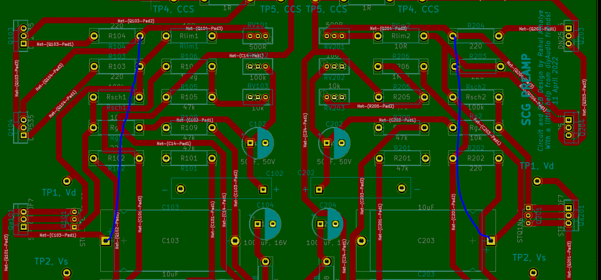

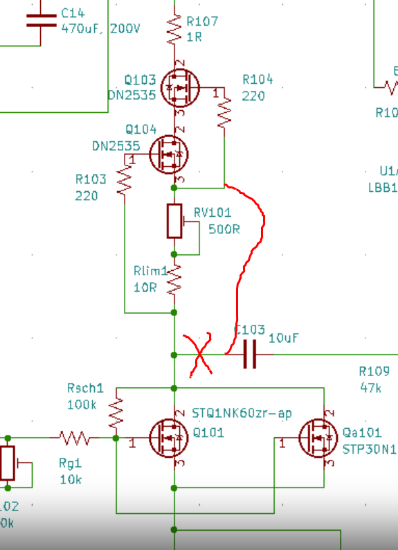

Wow, that was fast. Got a yes from both you and Alfi! I didn't want to disrupt the builds but sounds like it is a go. Okay, here it is:
Mu-Follower Mod
To achieve this on the existing PCB, the output cap pin (C103/203) closer to the outside should be wired to the inside leg of R104/204 (and not wired into the C103/203 solder pad/hole).
Pretty simple really. You can even hook it up with alligator clips, but be sure to desolder the C103/203 pin from its hole.
All this does is that it takes the output from the source of the CCS FET instead of from the drain of the gain FET. There is no change to the gain or any setting required. It has produced quite a bit of sonic ecstasy for me.
The other change to make is to take the current to 25-30 mA when using the TO-220 parts. For the STP30N10F7, the operating point is about 35-40V above the Vs voltage and 25-30 mA current. If you do this, make sure you have good heatsinking on the reg, top CCS, and gain FETs. Also, this much current will be marginal at best with the TO-92 P-channel FET (bottom FET). I am currently breadboarding it with a TO-92 part (VP0106), but it will run much happier with a TO-220 part (like the FQP ones).
Let us know what you hear.
