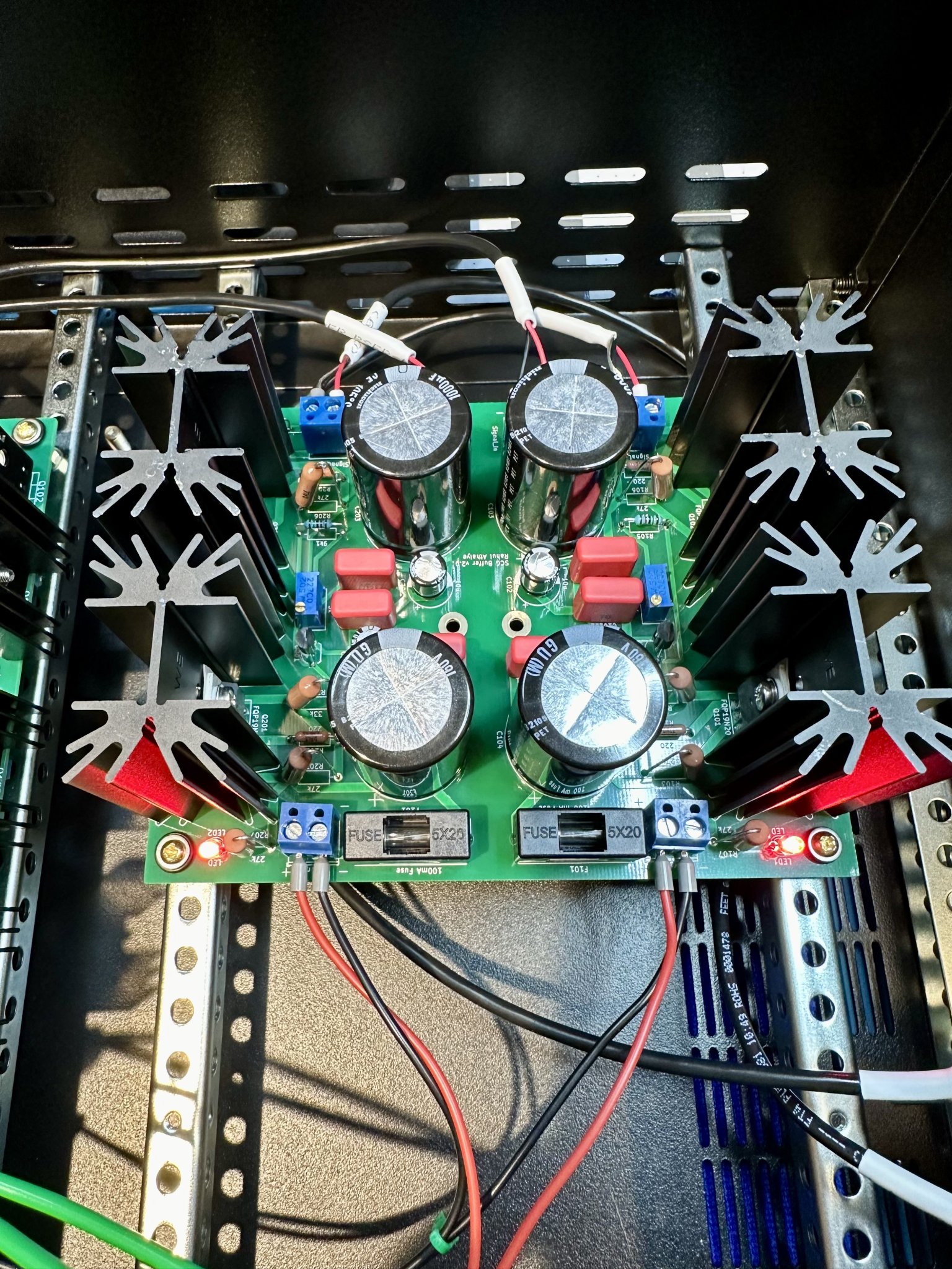

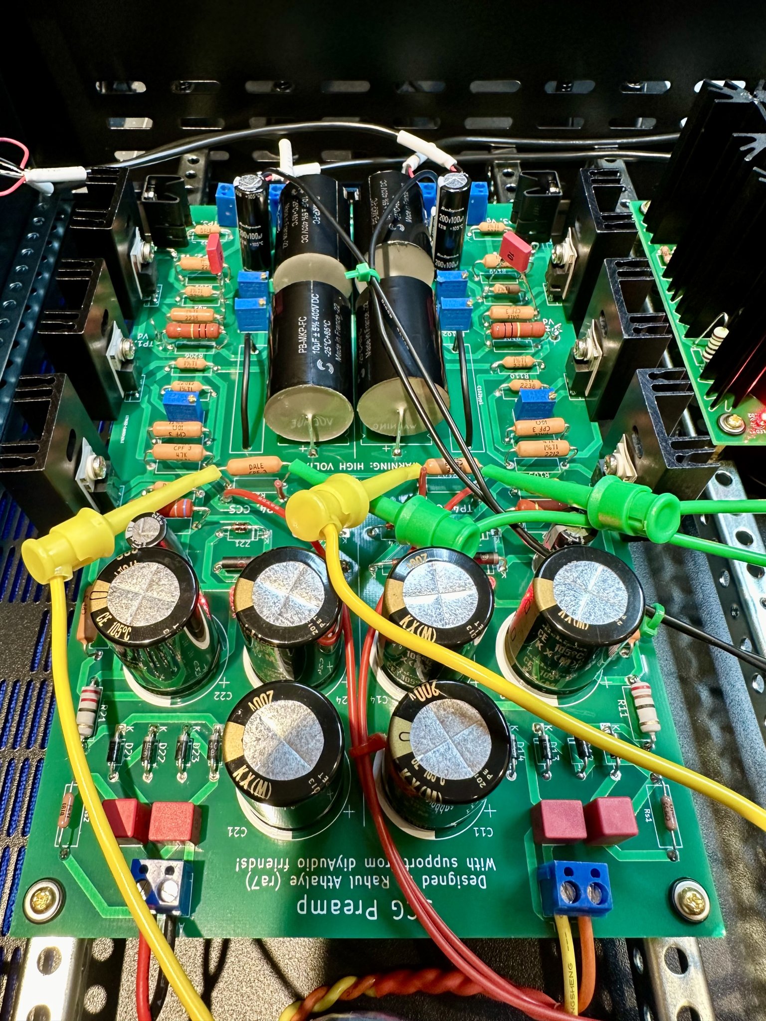

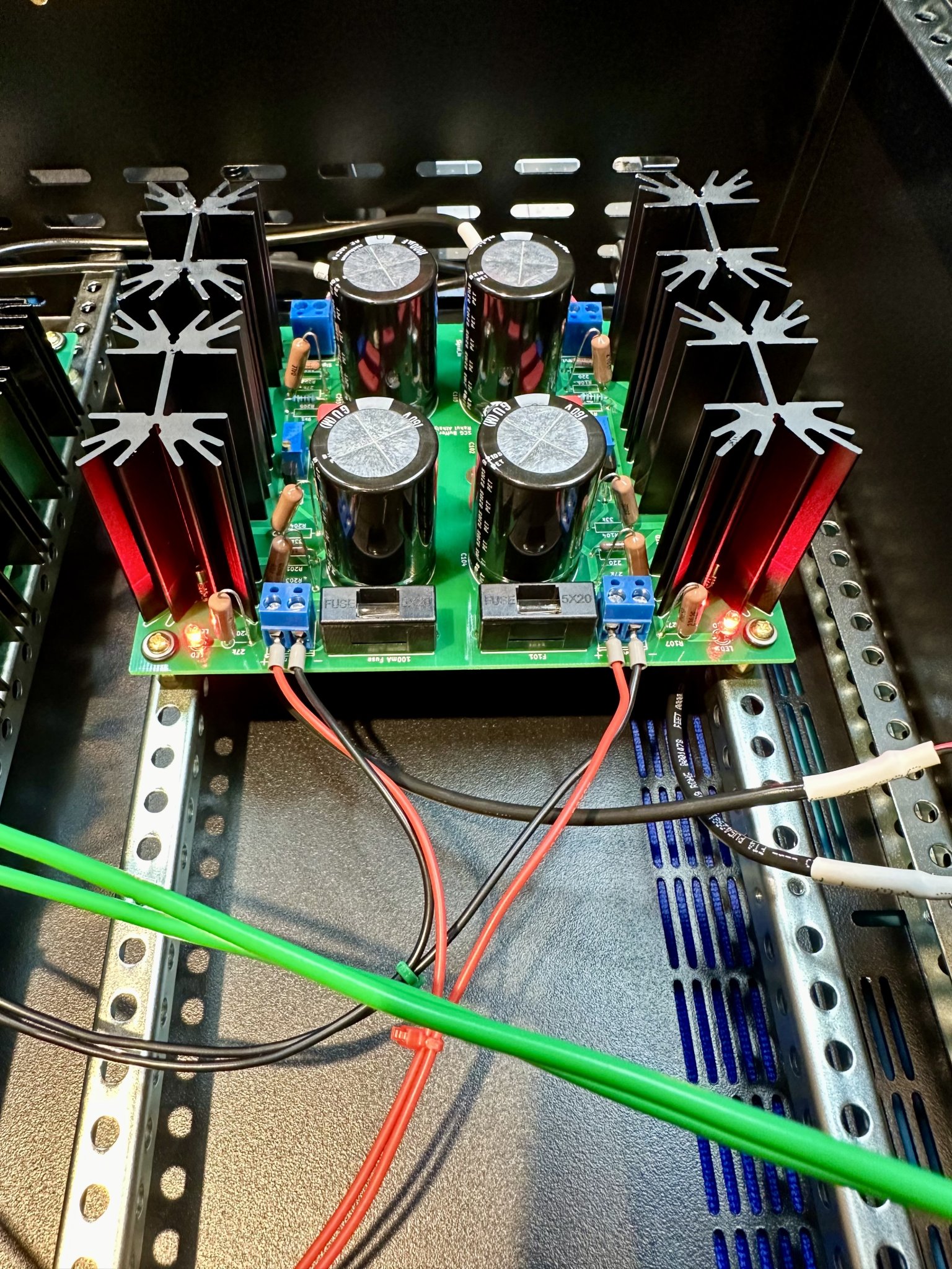

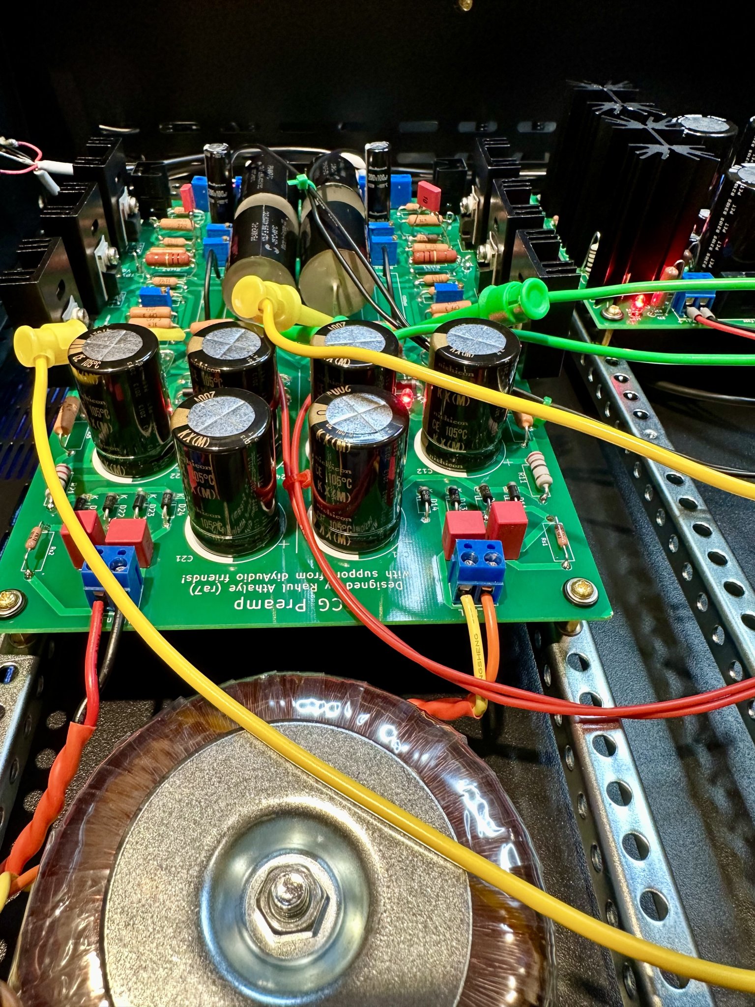

So, still LUSH after upgrades(1 and 2?)It sounds clear and lush.
@sov, don’t do part 2 yet. And I’ll post the cap change, which I found to be very useful.

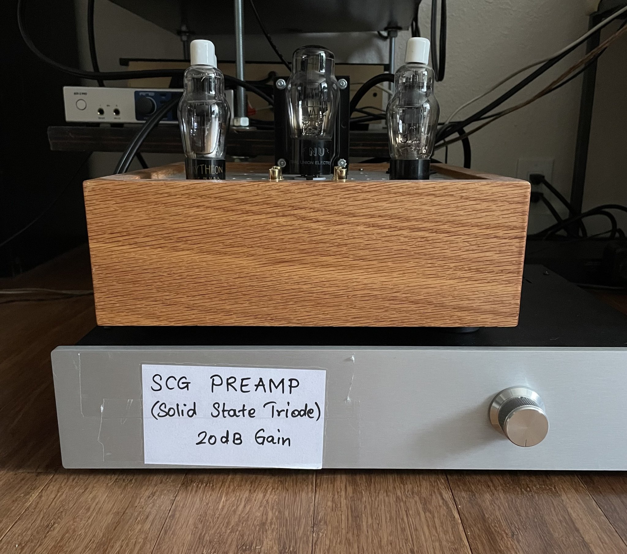

I’ve been enjoying this beauty recently. That’s a Type 85 tube, which has an absolutely glorious sound. The load is a CCS, similar to the SCG. Power supply has a Maida reg. I built this just before starting down the SCG journey, so it is maybe three years old now. It has a truly lush sound where you can forget about everything else and just enjoy the music. If I wasn’t a slave to building new stuff and experimenting, I could just stop here and be happy forever.
When I hooked it up recently, I remembered why I fell in love with this tube. The SCG is cleaner than this, it doesn’t editorialize as much, and it shows you more without ever being close to harsh. But sometimes, you just want to relax and not really want to notice everything. That’s why we have more toys than we need.

I just listened to Flamenco Sketches on my build and it was truly excellent!
I do love tubes, though, particularly the 300B, so now I have to wonder about the Type 85.
Tubes are not superior, but the way they work is so close to fundamental research in physics, it’s as magical as science can get.

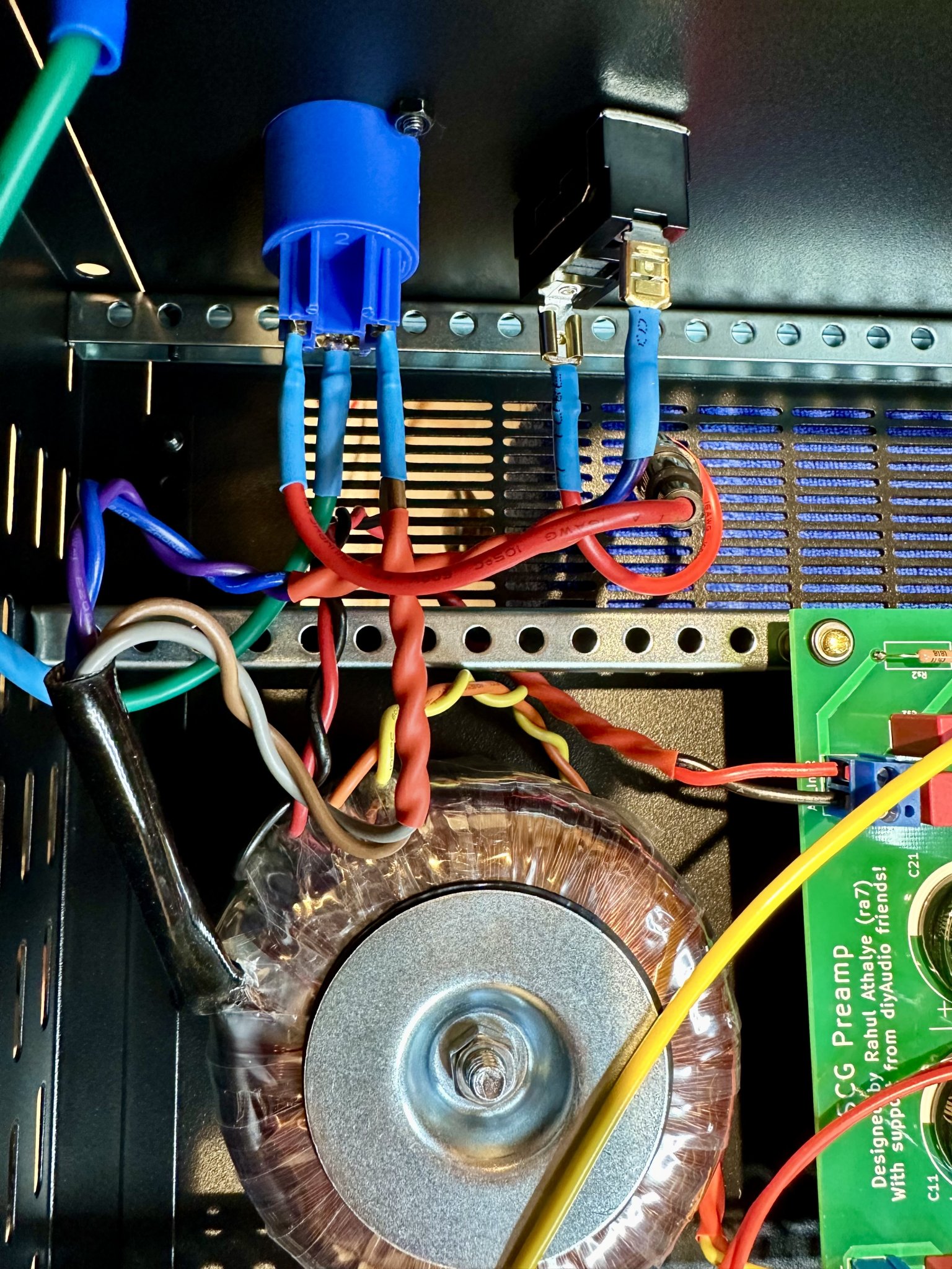

Not to speak for ra7 but I can tell you he has continued with the project. More important things, like his young family, have taken precedence.
I made mine using perf board and have been enjoying it immensely for the last six months, if not more.
I am using mine to drive Rahul's TDV amplifier idea using the THF51. I made four of these since I, too, biamplify.

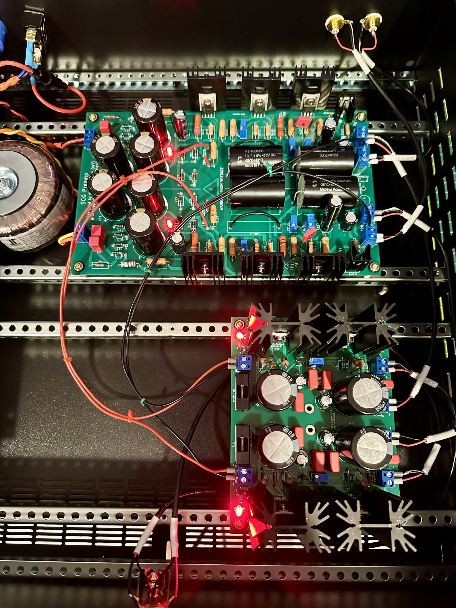

Thank you for the support, Rick! You have helped me keep going. Yes, life has been busy but I have been working on this design. Rick has been on the experimental journey and we have made quite a bit of progress. I also learned a number of things along the way. The next update will introduce JFETs for the input and gain transistor. In the past, I tried the good old 2sk170, but it didn't sound that great. Now I know the reasons why.
I'm waiting to finish developing a JFET headphone buffer amp before posting an update to this thread. There is already a MOSFET buffer but I want to hear what JFETs can do, especially after hearing their potential in the SCG. Testing on that is not done yet. I just ordered 200 JFETs from Digikey, the dirt cheap kinds, of course. Hope to have that wrapped up soon.
If interested, I can post a couple of schematics.
