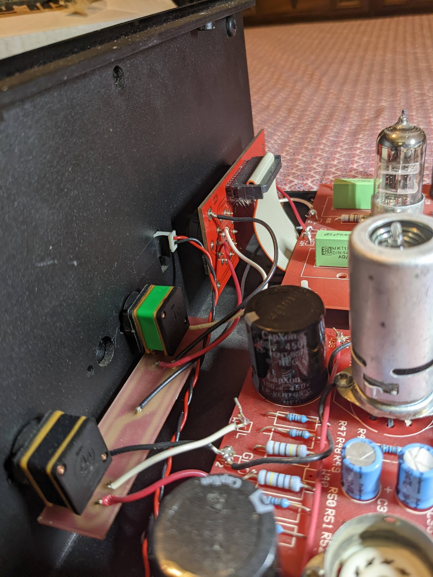

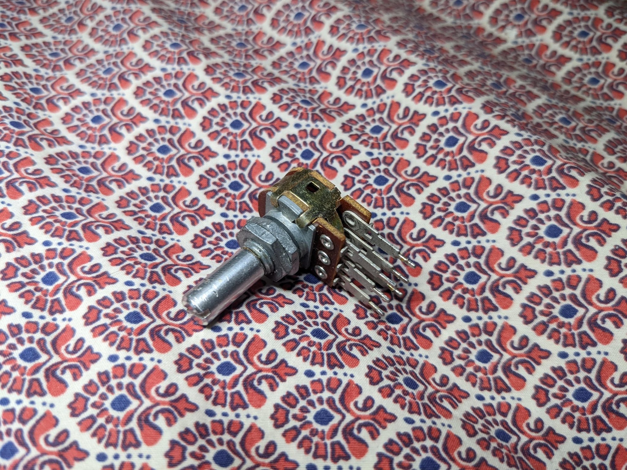

Funny to see someone solder the legs of a ALPS pot made for circuit mount.

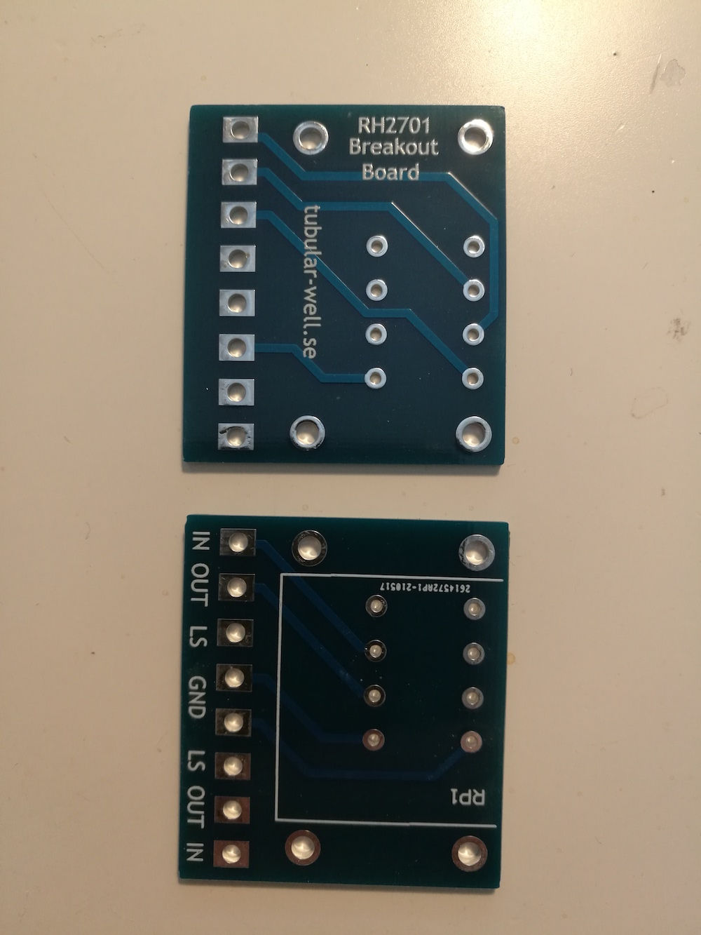

I actually made small boards for this : breakout board

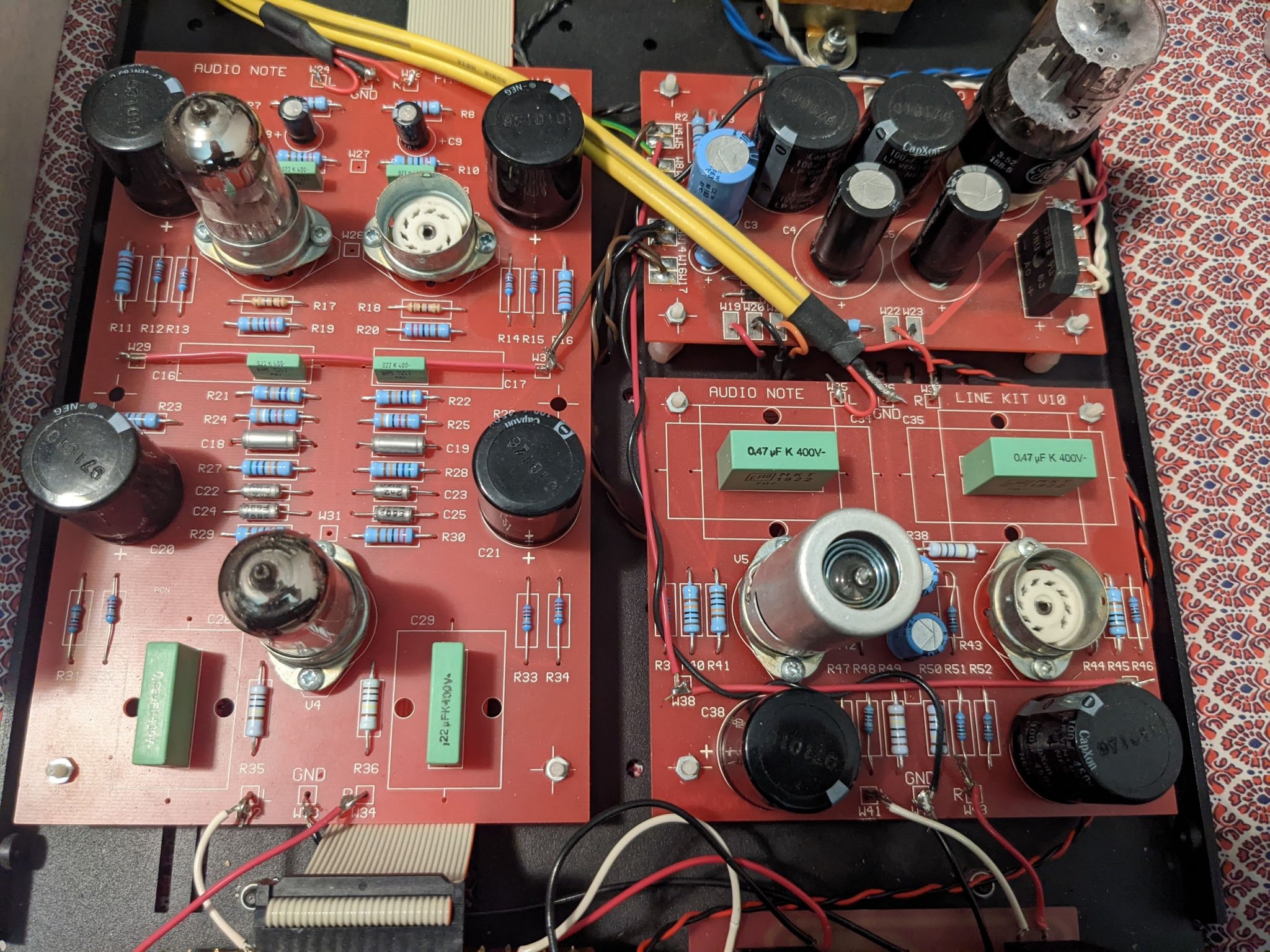

Audio Note... one pays for the name and the reputation. This one seems to be assembled by the typical person that is not precise. Happens too often in this area and it will be quite some work to make it OK.

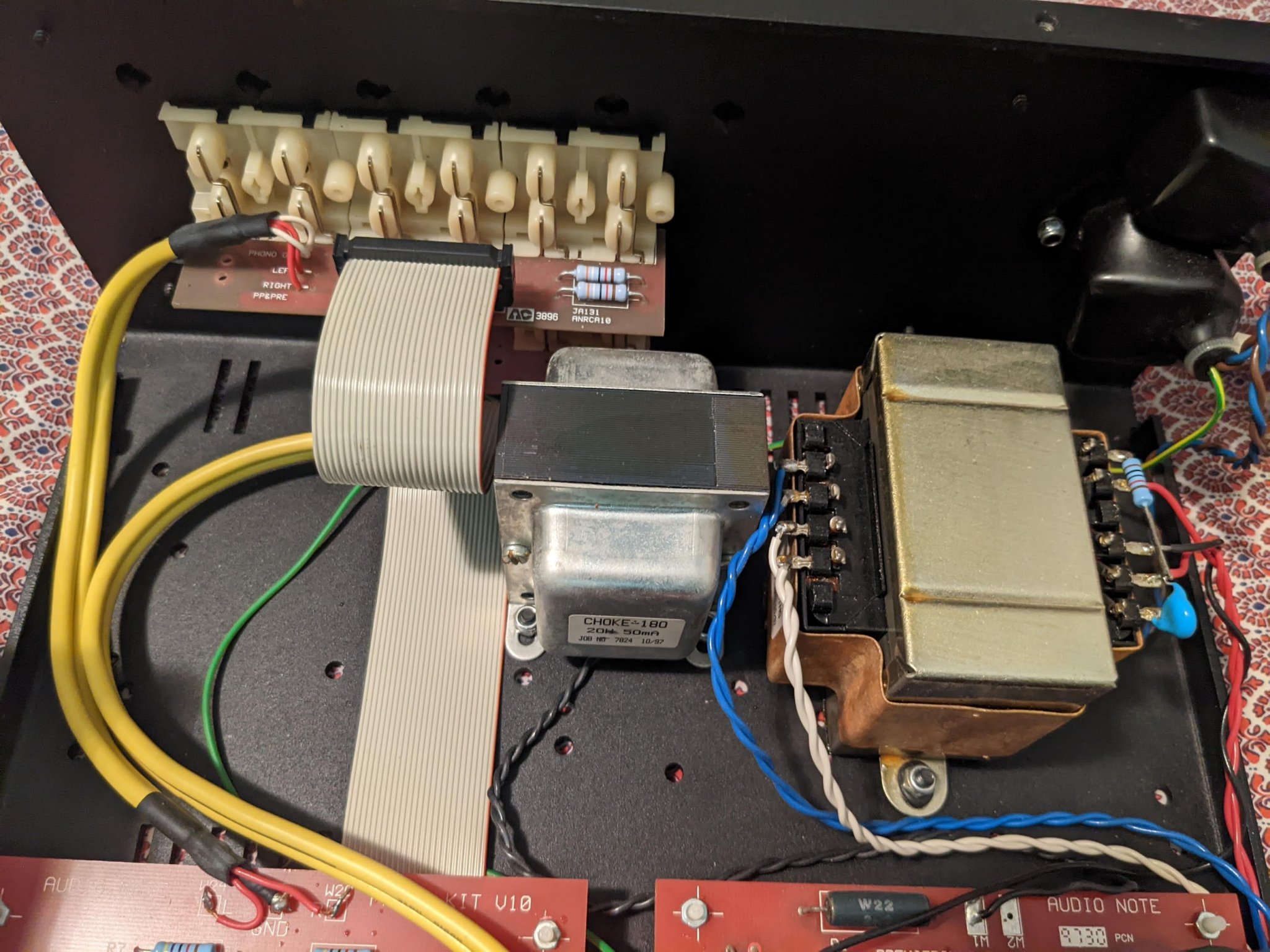

Is the mains wiring solid wire?
If it works as intended why touch it ? I don't see any cheap electrolytic caps there. Good industrial standard and what you see in all four- five figure factory equipment . I had similar factory built M1 preamp and it sounded great. M2 clone containing M3 phono stage which I built for a friend was easily better than his prized Audio Research SP16 preamp .
You do pay up to neck for AN gear but that equipment usually do perform on elevated level and it is meant to be used in all AN system.
Actually I see little which is questionable there. To assemble a preamp like this is a whole lot more work than in typical "neat" DIY crap tossed into drawer after a month of playing. Silver Audio Note $$$ wire , Jensen copper Pio caps (the old ones tend to leak after 10 years so it's worth checking for leakage especially RIAA caps ) Black gate caps , Beyschlag 0.5W resistor , Kondo based phono and line amp . I bet the stock kit came with standard capacitors , ERO MKT Green mylar caps (quite wonderful cheap capacitors ) , and open frame Alps Radio Schack potentiometers. All the upscale $$$ parts were an upgrade by the owners of the unit. If that thing is up the snuff it will easily rival $5k preamps from the usual suspectsI hope this preamp was not made by you...
I own Nagra PLP $11k preamp . ALL the capacitors are 10 cents industrial standard units and all the passive parts (except the transformers ) are worth maybe $25 . Now , check $11K Audio Note preamp and what's inside.Let's be real here. Without lifting the lid could you tell if the signal passed through a 10 cent capacitor or a $100 capacitor?

This particular one is built sloppy. That it works does not make a difference, that is a minimum feature and a must. If one only looks at minimal possible functioning then why buy AN? Limono, your remark on assembling "neat" DIY crap is strange. There are several devices at diyaudio.com that perform flawless, are well organized in terms of layout etc. and are sold in large numbers to many satisfied builders. With a BOM consisting of quality industrial parts, good quality potentiometers and switches and also performing way above the average. Seeing that standard and then this device is probably causing the remarks 🙂 Another area and probably not a one where people buy a 11k preamp with 25$ worth of parts, it is likely exactly the opposite.

Recent kits from ANK and a factory AN products have mostly impeccable built quality .Point to point wiring tend to be rather messy affair and the way AN is doing it is actually pretty neat.

I get:Funny to see someone solder the legs of a ALPS pot made for circuit mount.

I find it hard to improve on it and only had to change the leaking AN pio`s and the BG in the line stage.
It uses stranded hook-up wire.
The most important thing I did was to move the choke and put a shielding can on it for without it there is a serious hum and noise breakthrue on the phono and line stage. A design oversight.

ChrisP got it right. Little green film caps for the coupling caps, Panasonic electrolytic caps, hot garbage volume and ballance pots that mounted on a pcb with a smaller ribbon cable. Only thing I did to mine was got audio note pots and bent the legs to fit the pcb and reamed the case to make them fit. I replaced the rectifier with a nos one. I was going to replace the phono tubes with nos 6072's but the sticker shock did that idea in.
I did put 6072a's in the phonostage, mostly because that's what the original m7 circuit was designed for. I also put some CV4003's in the linestage replacing the cheap looking ecc82's which were rather microphonic. To be fair I was using this with a World Audio Design K5881 power amp that was far too sensitive. With the original ecc82's you could hear your footsteps through the speakers as you walked accross the room.

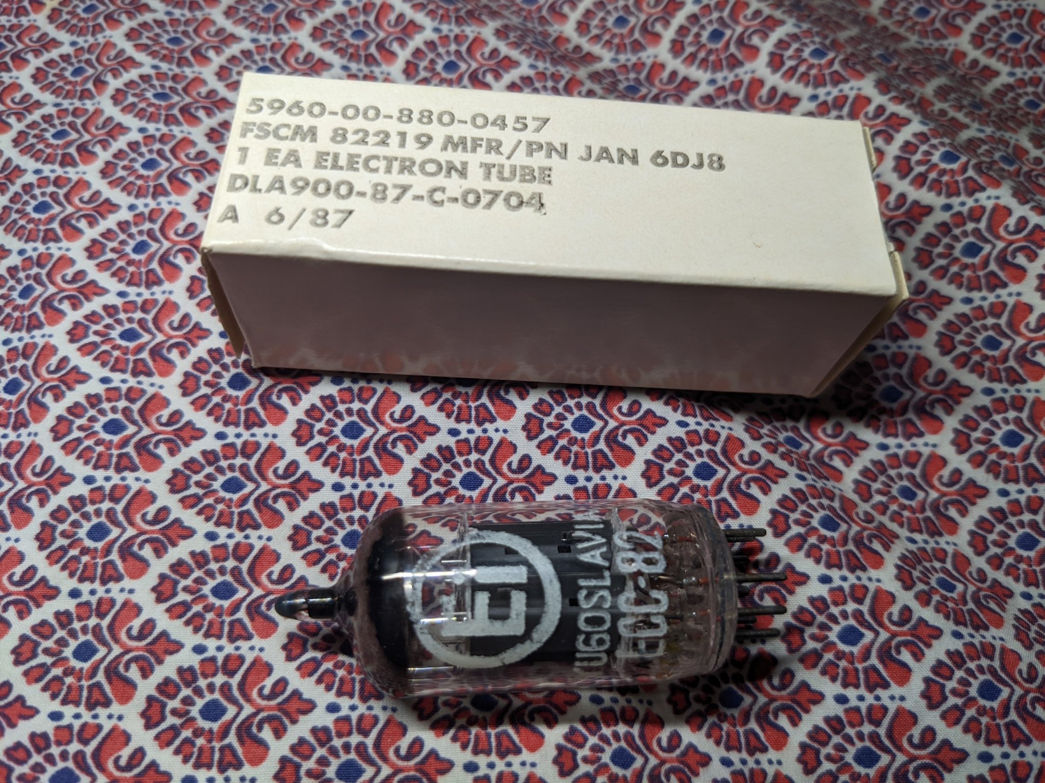

And ChrisP is right about the original 12AU7's, they were microphonic but I had the pre in a room that was carpeted on a cement foundation in a cabinet that is as heavy as a main battle tank. so I didn't have much issues with them. I believe they were a Yugoslavian made tube and they had a reputation of being good when they worked but had issues of premature failure and didn't last very very long. I guess cheap thrills with microphonics, gotta love the 90's! I think they were manufactured by EI, but that's just from memory. I have always used the tube shields with all the tubes so there was some mechanical dampening.

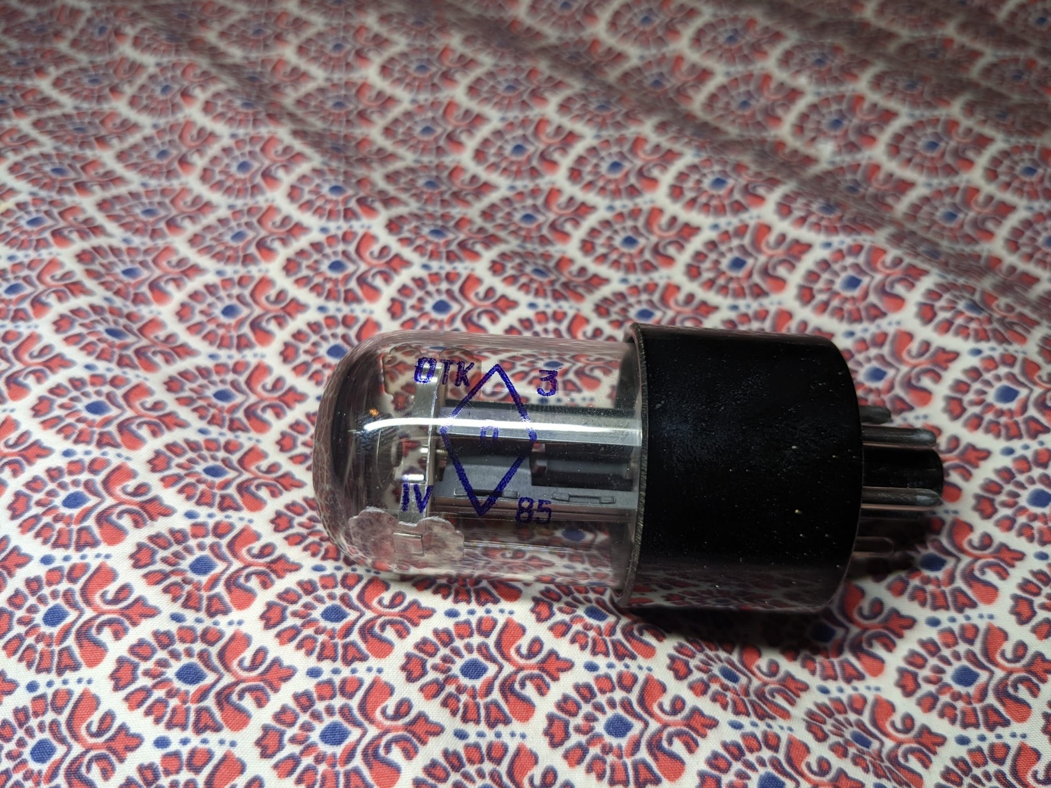

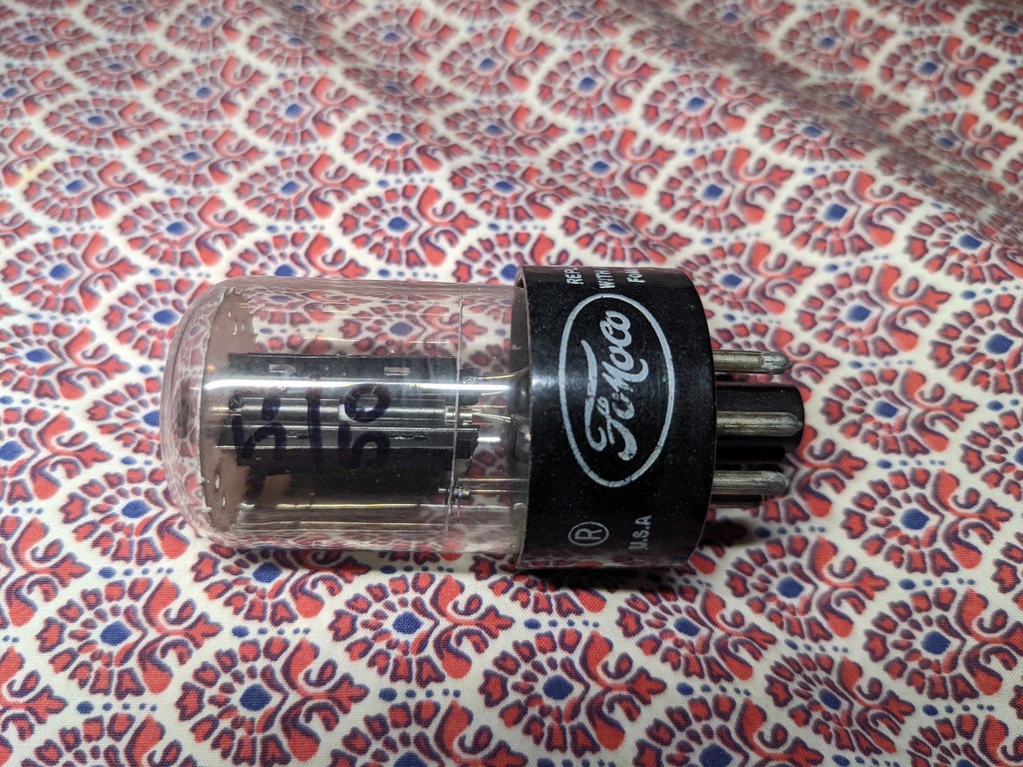

Oh the original rectifier was some cheep Chinese tube supposed equivalent and it arced on power on so I replaced it with a GE 6X5GT, I got 2 from an ebay seller and one is branded FORD. That is so funny.

BTW I was wrong, there are no Panasonic caps, they are CapXon and Rubycon. The coupling caps are green prismatic ERO mtk. I was also wrong about the volume and balance board, there is no second ribbon cable, the PCB is jumpered to the switch PCB and 1 ribbon cable takes everything to the back.

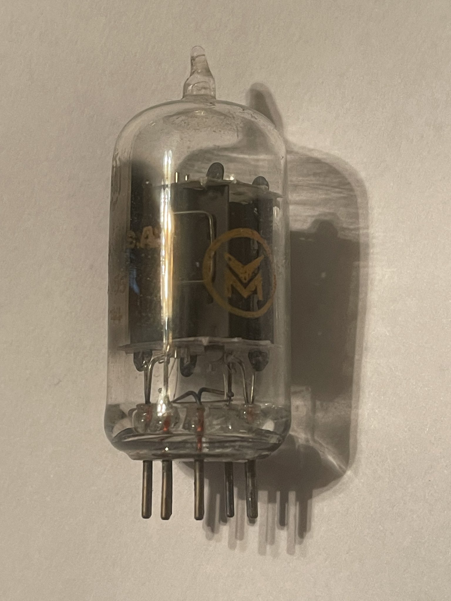

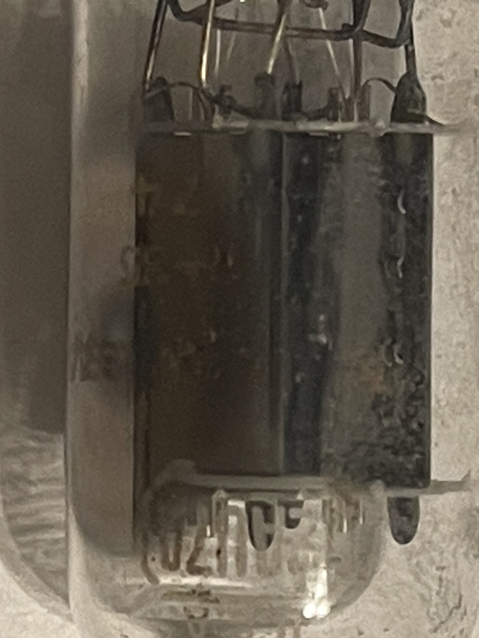

Your mystery tubes (12AU7) are Voice of Music rebrands. I have one or two of them think. I recently used the iron from a VoM tape recorderI'm still using the OG Sovtek 12ax7xt. I've left this pre amp on for over 7 years at a time and they still work. I was just too lazy to reach behind and turn it off. I think that's what my kit shipped with, after all I purchased it in 1997 from Angela Instruments so I may be wrong. I did replace the 12AU7, with some NOS tubes and I don't remember the actual manufacture but they are branded with a M with a V on top of the M and inside a circle, some sort of rebrand, marked U.S.A.... 12AU7A... MADE IN USA ... 60-46.... 274. When I bought them I knew the manufacture but I have no clue now. (the ... is just line breaks). If someone knows this tube origin I'd love to hear it.

to build a guitar amp. I believe they used different tube vendors to rebrand. They appear to be RCA to me but I'm not sure. Tube is a bit crusty.

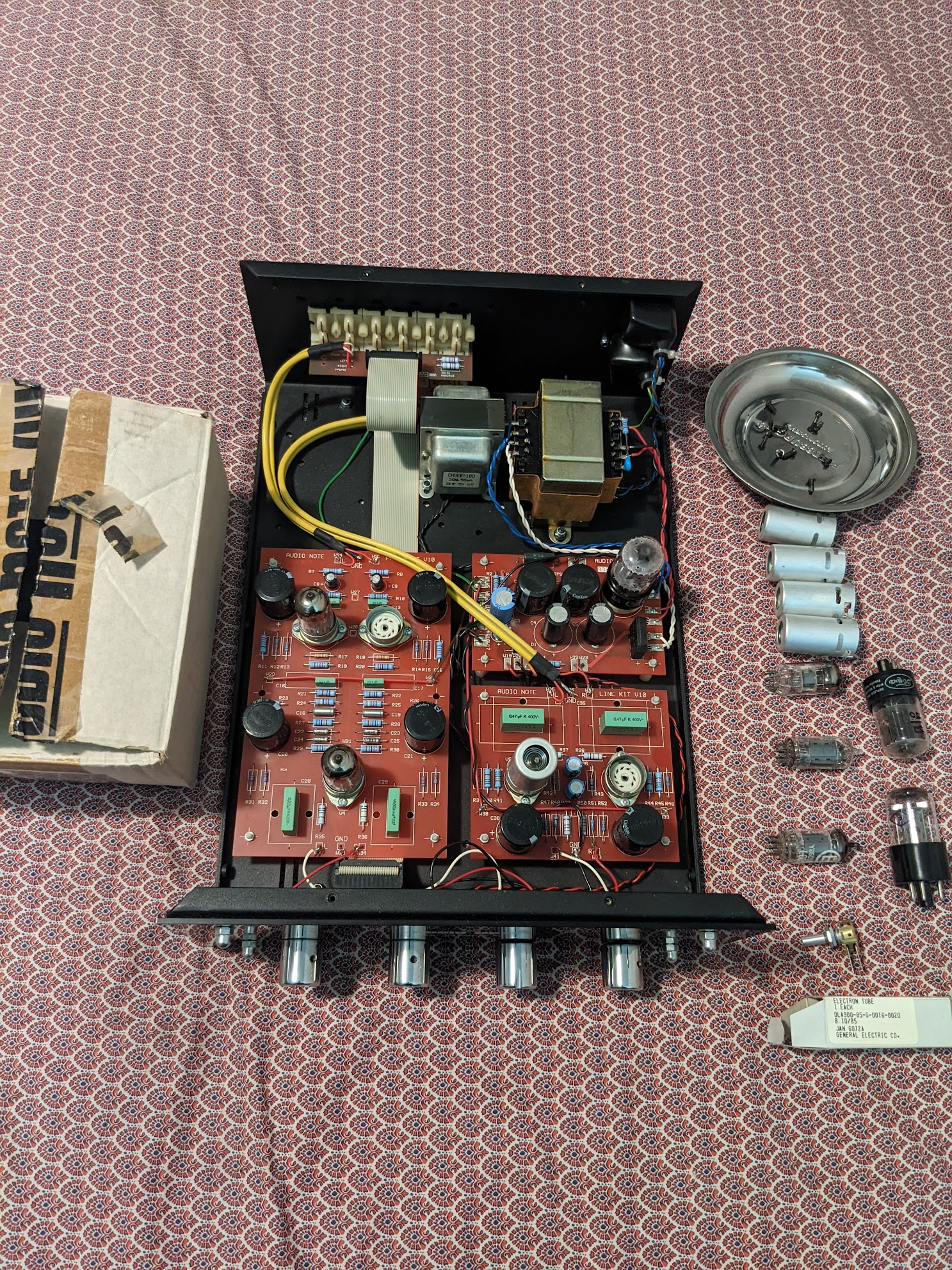

I'm going to try posting some pics, some are so funny, I'm not sure if I could comment or just let people figure it out.
