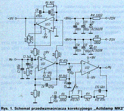

Do you think R9 should still be connected to ground
now, or does it make sense now like it is?
In the formula of calculation of time constants it does't
seem to make a difference wether R9 is connected
to gound or to the Output of NJM4580.
I'd really like to have the original Actidamp schematic
to compare it to phonobox.

in the meantime i've swapped the op-amps in my
pro-ject phonobox:
TL061 => OPA134 (this is a FET Opamp used for Actidamp in
the phonobox)
NJM4580 => OPA2228 (this is the amplification part)
Also, i adjusted a number of resistors and capacitors,
as the phonobox (in some older revisions, including mine)
is somewhat inaccurate.
Pleas refer to the schematics here (thanks to Dimitri!!)
http://www.angelfire.com/az3/dimitri/images/phonobox.pdf
DO NOT connect R9 to ground as it is suggested in the PDF,
but leave it as it is. R9|| R8 = 5003,8 Ohm, together with
C6 gives 75,06 uS time constant !!
From talks to the developer of the original design I learned
that R9, C7 are not meant as a low-pass Filter, but this
is an optimasation noise-wise! My thanks go to Pavel in
czech republic!!
What I did exactly is :
R5 : 1,32 MOhm, was 1,2 MOhm
R6, R7 : 220kOhm , was 330 kOhm
C4 : 0,47 uF , was 0,33 uF
R8 : 5.6 kOhm (selected), was 4,7 kOhm
C7 : 10uF, was 2,2uF
C6 : 15nF (selected), was 18 nF
R10 : 300Ohm, was 270 Ohm
R11 : 2,7kOhm (selected) , was 2,7kOhm
R12 : 2,2kOhm (selected), was 2,2 kOhm
R13 : 47KOhm (selected), was 39 kOhm
C9 : 68nF (selected)
Stephan, please, woud you like to explain this "noise-wise optimasation"?
Thank you
Thank you
Dimitri,
if i understood correctly, the idea is to reduce
current noise by increasing input resistance.
47 KOhm causes much less (dc) current flowing through
the opamp input compared to 5,6 kohm.

In fact, the lowpass of 75 us is created by complete circuit
consisting of R8, R9, C6, C7. The purpose of such complicated circuit is to achieve similar DC resistance "seen by" both non-inverting and inverting input of the following opamp and same time achieve low AC impedance of the low-pass, so that the noise introduced by the input current noise of the opamp would be reduced as well as the thermal voltage noise generated by the total resistance in the lowpass (R8 || R9).
Guys, you can give to Bobolix any questions about phono preamps - in this thematic he knows absolutely ALL and I claim it quite seriously 😎 .
>> In fact, the lowpass of 75 us is created by complete circuit consisting of R8, R9, C6, C7. The purpose of such complicated circuit is to achieve similar DC resistance "seen by" both non-inverting and inverting input of the following opamp and same time achieve low AC impedance of the low-pass, so that the noise introduced by the input current noise of the opamp would be reduced as well as the thermal voltage noise generated by the total resistance in the lowpass (R8 || R9).
Sorry Bohumil, I will interfere
1) yes, dc "seen by" both non-inverting and inverting input will be around 47k
2) > achieve low AC impedance of the low-pass - the output impedance of low-pass will be R8 4k7 with gradual decrease at hf. How R9 C7 will lower this? (R8 || R9) is only 10% reduction.
3) > the input current noise and thermal voltage noise - again, (R8 || R9) - 10% reduction is negligible.
4) dc shift of the input amp, worst case 5mV*28=140mV, will be presented at the output

Hi boys,
don't forget it is a construction about 20 years old. I learned something since then and now I'd make it different - frankly said, I did it so, but it has been made by an order and therefore it is a subject of the "bussiness secret". Though, I can say, the dc-servo path needs to be modified slightly at least ... 😎
BTW...
... the Actidamp was made as an optimization for the MM pickup regarding noise. Recently the MCs are assumed to be the best usually and the Actidamp need not to be the optimum solution. E.g., the linear pre-preamp could be made as balanced using some of ICs determined for mic preamps - INA217 e.g. I've made even a fully symmetrical phono preamp, i.e. with completely symmetrical signal path including the equalization circs, but probably it will never be published.
