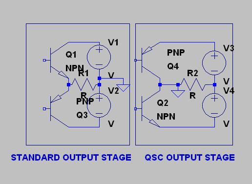

Another two important advantages of this "grounded output" topology is the absence of the classic VAS (voltage amplifier stage) and its non-linearities, and the fact that the differential input amplifier is powered with +/-15V regulated rails thus allowing to achieve better performance.

EP1500 Circuit - grounded topology
Now had a look at the QSC circuit - the main voltage gain is just in the last stage (the combined driver transistor and 'upside down' emitter follower quads). One still has a VAS, it's just handling a bit more power and presumably working in class AB ??. I'm not too keen on the design - but I bought my EP1500 before I knew and it works fine and sounds alright.

More QSC Info
Someone asked what the "QSC configuration" was called. They call it a "grounded collector" configuration and it is true as stated that it allows the transistor's heat spreader to be tightly coupled to the heatsink for better thermal performance.
There's also another design feature that is subtle but important: The speakers are effective AC coupled to the amplifier via the filter capacitors. This is the part that blew my mind when I first started working on QSC amps. The importance of this design feature is that in the unlikely case that you short an output transistor, it is not possible to pass DC to the connected speaker which usually roasts the voice coil quickly or causes mechanical damage.
