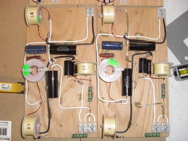

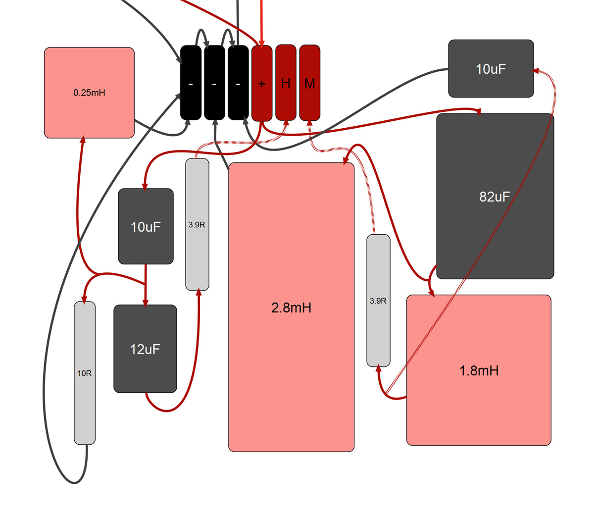

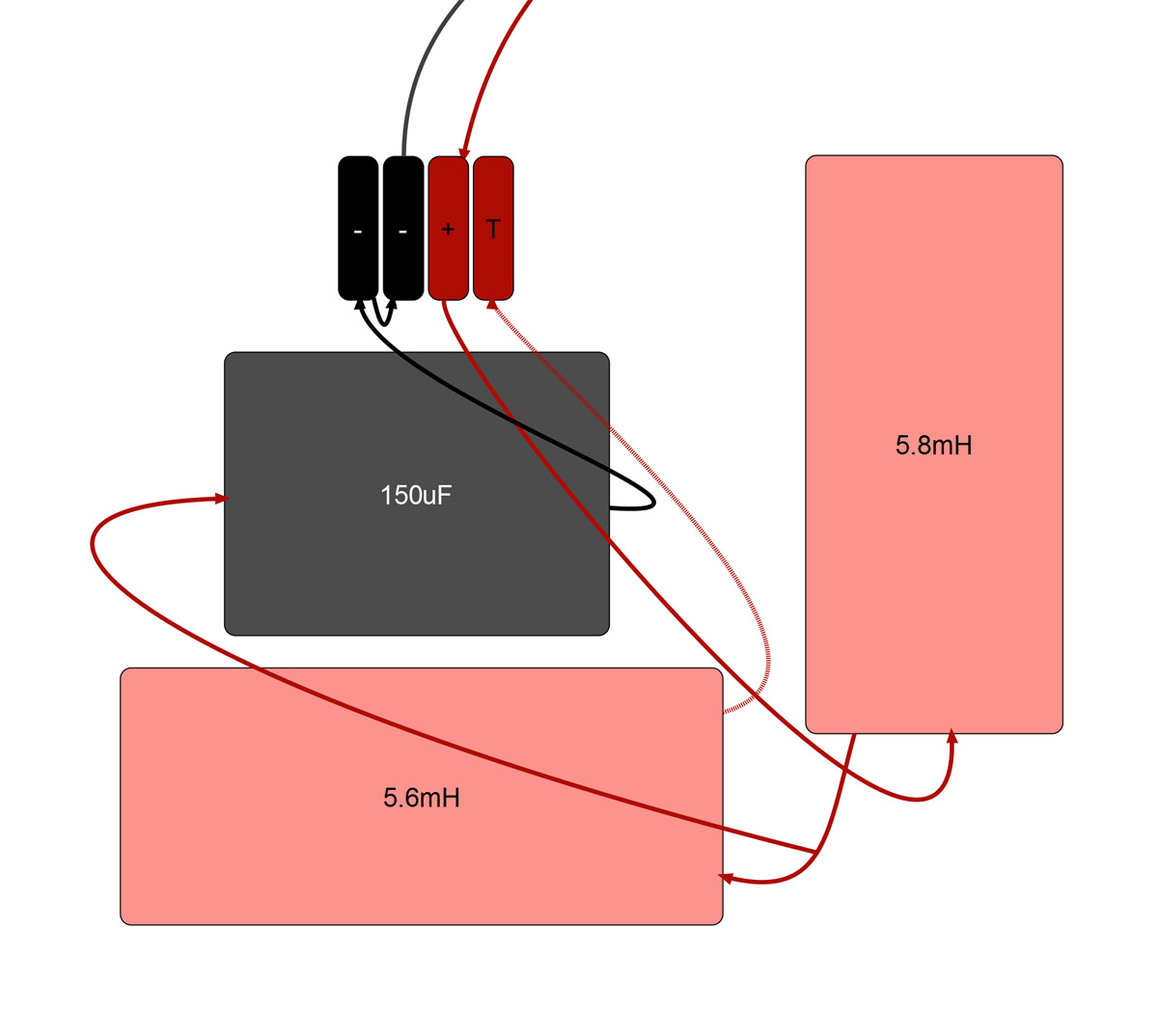

Nice job. Wiring all looks correct.

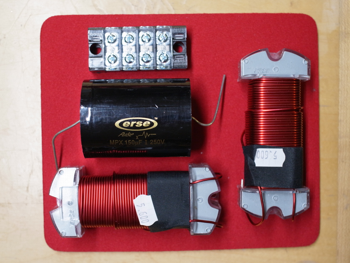

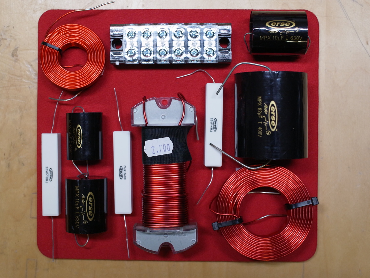

Yes, some values are rather large. Be thankful you didn't go for an air-cored 5.8mH inductor. 😱 Think about glueing the bigger ones down to the board as well as using zip-ties. The big inductors can be screwed down. Inductors btw are coated so you have to sand the ends down to bare wire before soldering them.
There are no +/- on any of the components. I know, I was surprised initially as well.
Solder connections where they fit well/easily/logically. Snip of any extra length for neatness. No reason jumper wires can't simply be the same wire connecting the speakers to the amp.
For placement, I might slightly change the 2.8mH inductor in your 1st xo so that it sits perpendicular to both the other inductors on that board, like below. I'm nitpicking though. Think also about inductor placement between the 2 different xo boards. I don't know how close together they might end up inside the speaker.

Thank you for the approval; I am excited to get started on this now!

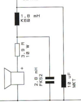

Regarding the positioning, I was referring to this drawing, and thought that my inductors are layed out like in figure 6:
The space inside the cabinet is a rectangular box, with four large sides being about 7" x 9", and the two shorter ones about 7" x 7". I will probably position the two boards so that they sit on a 90 degree angle to another (this would make the internal wiring easier). The sides of the crossovers that would be at the angle, e.g. closest to another, would be the left side of the first board (H, M) and the right side of the second board (T). It's probably best to post a picture before I mount them permanently. Again, it would be "good" according to the drawing posted above, assuming that I can consider my large inductors to be like the right one in figure 6, or am I seeing that wrong?

Like I said, I was nitpicking. Picture #6 with another red inductor on the right. That's what I was suggesting. Right now the bottom 2 look good but the top left one is in a sort of odd 45 degree position. Nitpicking.
Obviously, I read the cored inductors the same as you.
The 2 boards' in-cabinet placement sounds like #6 again. Looks like you've got this figured out.

I see what you mean now. Whether that's possible, I don't know, since I don't have a lot of space on the board.

Here's a tip: don't restrict yourself to thinking in just 2 dimensions. You can stack a cap and/or resistors on top of a coil if you have to.
