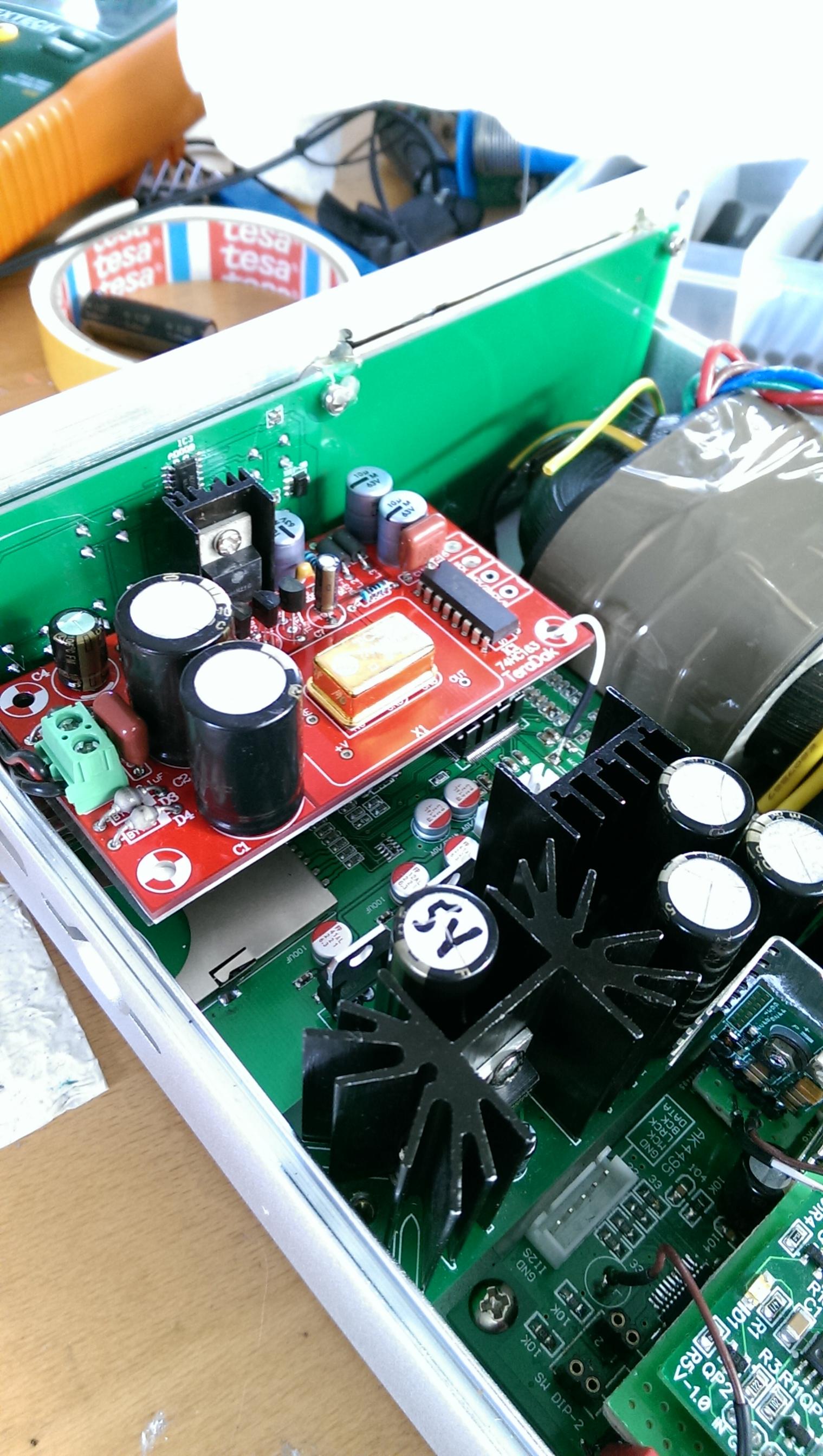

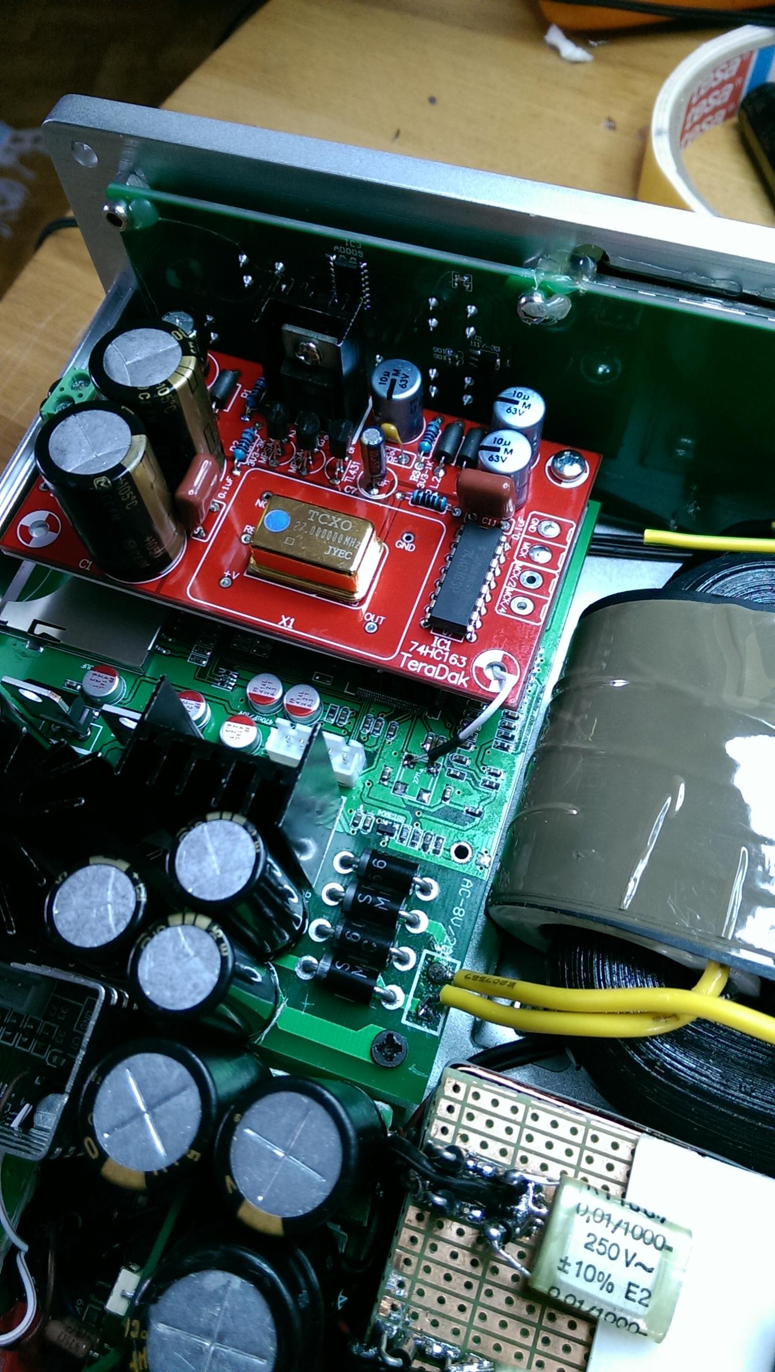

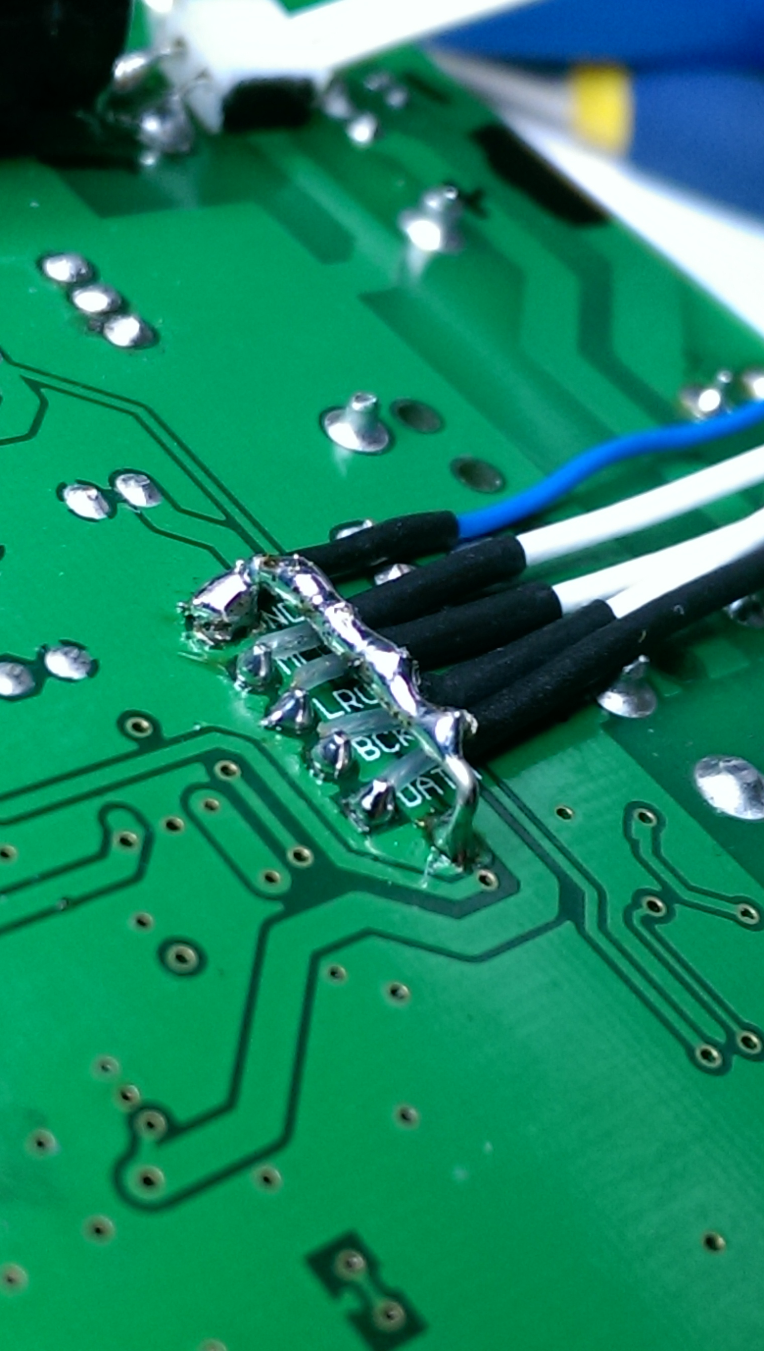

I leave the DAC board at peace for now 🙂 I ordered a new TCXO oscillator after identifying the 27mHz oscillator on the I/O board. It's one i used before and it has it's own powersupply.
I used coax cable from a wireless antenna to connect it to the board. Removing the old one was easy, just heat up the the whole oscillator.
Almost always a nice upgrade ! Even the LCD creen looks sharper(?) and the ghosting in the TFT got less.

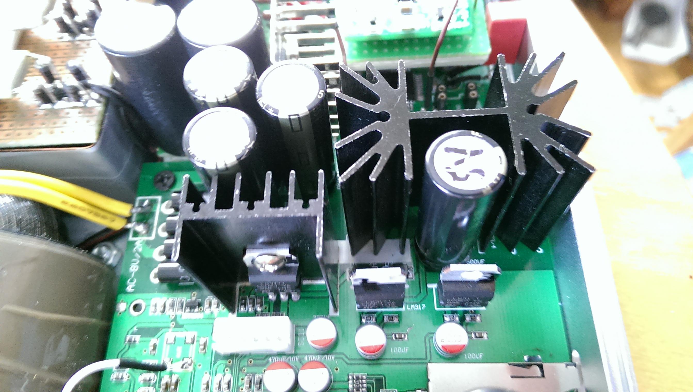

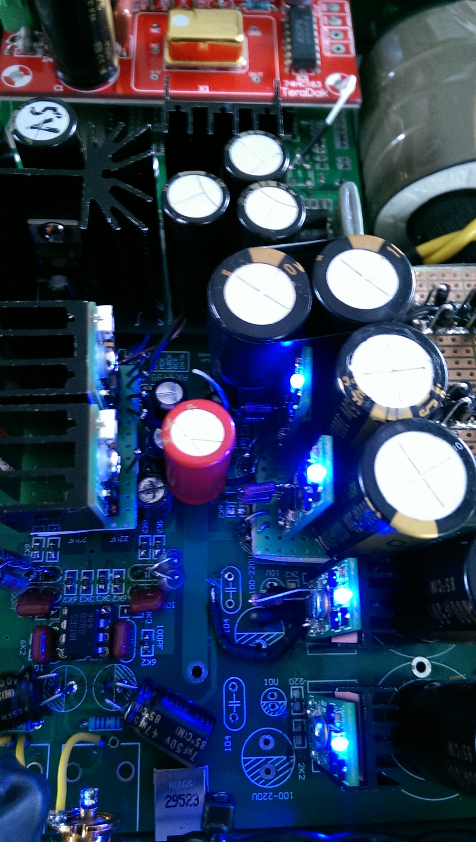

Now i'm going to try to tune up the powersupply from the I/O board.
Too bad that there is no real information about the main chip, the ESS Crescendo 2.
The rectifier is made of Schottky SB850 diodes, The 3x1500uF elco's are Panasonic FL ?
I can only find them on ebay, old stock perhaps. Changed them for FM types.
First regulator is a heatsinked LM350 which provides the current of almost 1A.
After that the 5V output goes to 3 LM317's and to the front display.
At that junction is again one 1500uF FL cap, changed it for 2 1500uF FM types.
The only thing that i can do is change the LM350 for a TPS7A4701 reg, it should provide the needed current.
On of the 3 LM317's is heatsinked and get's an input of 3.5 V, the 5V main voltage is lowered using 2 diodes in serie. Is it helpful to use caps over the diodes to bring down the noise ?

The series diodes works well to keep the noise down, it’s when you only have one that it could be an issue.

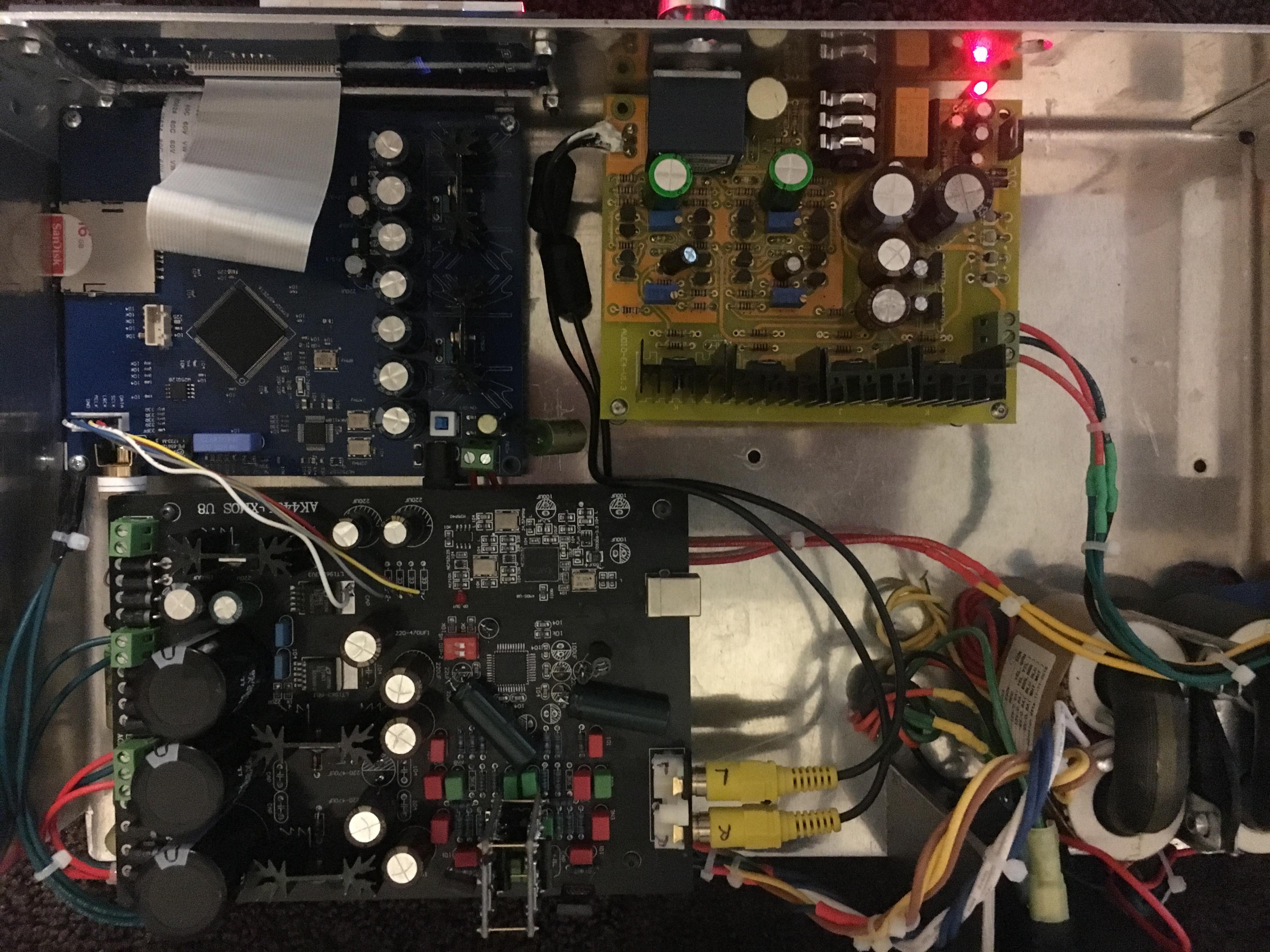

I have a somewhat similar project that uses an ak4495 dac board, a “lossless turntable” SD card player, and a headphone amp all in one case. Am going through making improvements where possible much as you are.

I don’t want to muddy up this thread with too many particular details regarding my Frankenstein apparatus, but will comment on common features or modifications that are shared.
As far as power supplies go, one that I wanted to use for the sd player portion was a lt3042 board from ebay that was pretty reasonable, mine never functioned and I haven’t gotten another. Others have had them work successfully, there’s both single and dual versions.

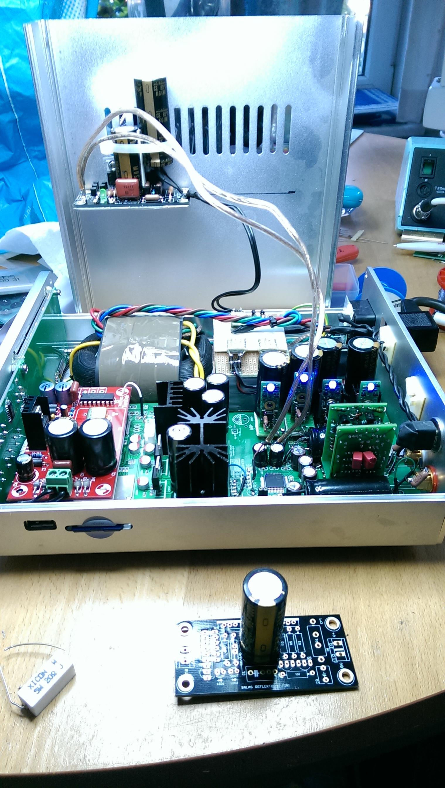

Last mods i did make was to change the I2S flatcable into 7cm long coax.
Isolated the chassis from the powersupply ground.
I got rid of the TP regulator and use only 2 TPS7A4701 for AVDD /DVDD.
Now i'm just waiting impatiently for those opamps from China.

I just received the Muses02, indeed a good sounding upgrade over the stock 8820 type.
Those are Hans his posts and yes they are for zeroing the offset, my DAc has only about 15mV output, so i'm not going to change that.
Funny that you asked about the clock upgrade, i've just finished a positive Ebay review to rate the product. It does what a good clock upgrade has to do : a more refined, stable sounding dac. Easy to implement.
Did it before with a cd chassis 🙂
p.s. i don't know if the seller likes my added pictures because i replaced almost all the stock caps.

The reason I asked about the clock board was because I had a similar board that made no difference in the sound of a dac I was working on. The usb receiver that it was supplying, died just a few days afterwards, so I abandoned the clock board the next time around...

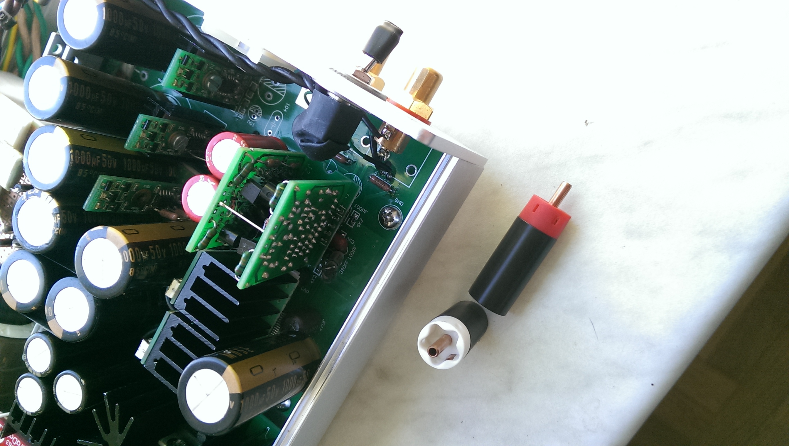

The Muses02 is better than the 8820, but the discrete opamp beats them both. I'm almost satisfied with the sound performance.
The music can still be a bit too bright, i've changed some of the filtercaps into polystyrene caps and replaced the neighbouring smd resistors to Dale-Vishay rn55d.
Those resistors are hard to find in Europe if you want hem for a fair price, here's one 🙂
40x Dale Resistor (RN60C/RN60D) 1% Customerized Values | eBay
Bought 2 Amtrans AMCH capacitors for the filter to see if that helps.
Amtrans AMCH | Hifi Collective
I use ETI rca connectors but these are very expensive, i found a "copycat"on Ebay that looks really well. Should have known that earlier.

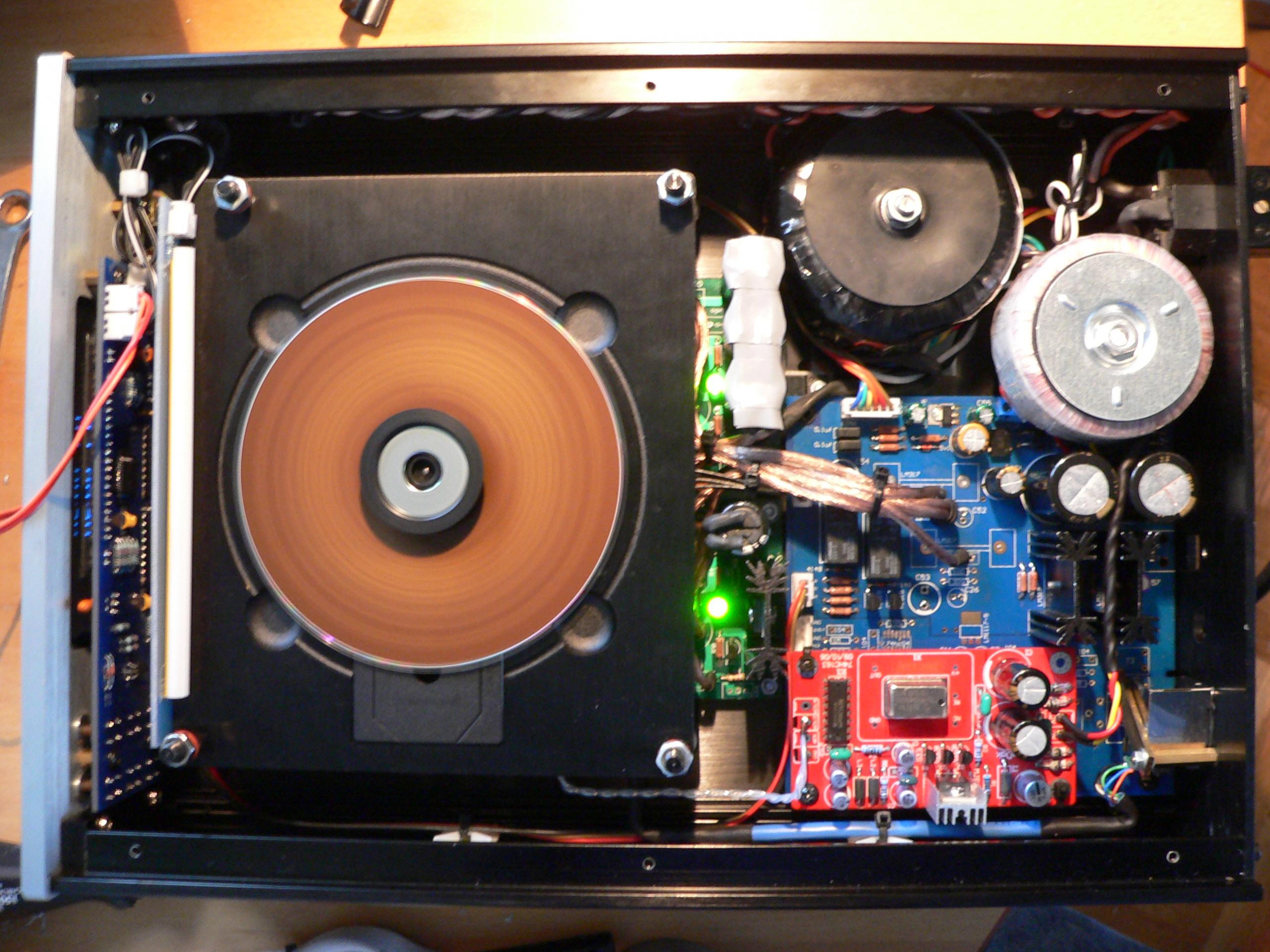

At first i thought that this dac would be a funny sidekick for my TP dac, which is filled with shunt regulators. Slowly that idea changed, i now like this Chinese dac to be almost as good as the other one. I installed a Salas Reflektor-d mini for DVDD /AVDD at 3.3V, what a huge positive difference over the other low-drop regulators. Good !:worship:
I 'm trying to squeeze one more in this tiny chassis.
Other things i changed : removed the brass 8 pin holder for the opamp, on the motherboard and the discrete opamp. Removed all smd resistors for leaded Dale/Vishay rn55 and all filter caps are now Amtrans AMCH type.

Hmm, i changed too many things at once, so i don't know what the influence might be.
It's just soldering gives the best connection and brass (8 pin socket) does sound harsh.
Tomorrow i ill find out where to use the second Reflektor reg, split up the supply for AVDD/DVDD into 2 Reflektors, or just use one there and the other one for VREF/VDD.
1 Reflektor sounds much better on AVDD/DVDD than 2 TPS7A4701 reg's. FINALE 🙂
