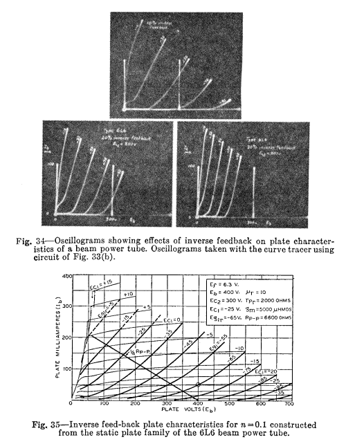

I am ready to accept/test schade feedback problem is I have no measuring equipment here that's why I need your help. Like the following: 2e24 DHT – Bartola(R) Valves
My understanding is that H3 component is higher in schade feedback. By the way how you measure 10% or 20% feedback? Please enlighten me.
I am very interested to try hy69 or 865 in triode or schade feedback mode.
