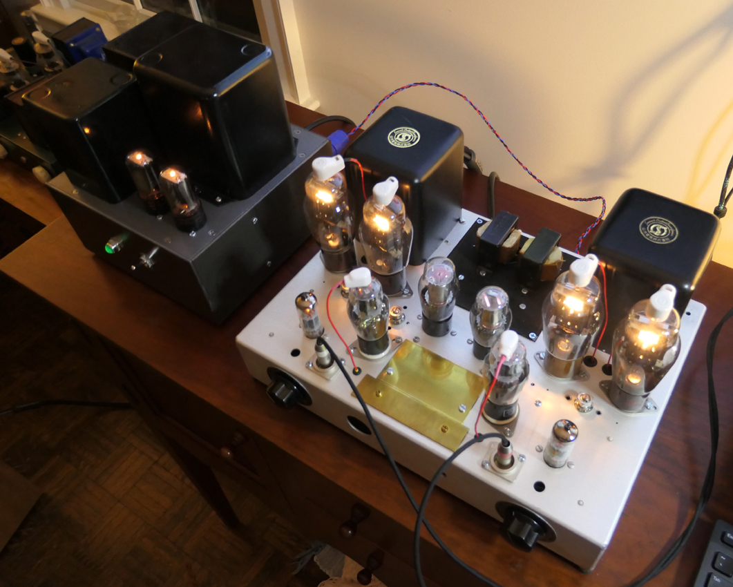

When I first saw a photo of an HY69 tube, I decided I needed to make an amplifier using it. So last Spring during lock down I decided to make an amp out of parts I had on hand that I had been collecting for years and had always intended to use "some day."
The HY69 is a bit challenging to use because it is a directly heated pentode. I decided that separate filament transformers for each tube could achieve the lowest hum, so I treated them just like a 2A3 with individual hum pots and individual cathode resistors. As it turned out the amp is very quiet.
The rest of the amp is pretty conventional with the Mullard 5-20 as the inspiration using a 12BY7 voltage amp into a LTP of 6F8G with a CCS tail. The screen grid of the 12BY7 is regulated by a couple of zeners and the screen grids of the HY69 are regulated by a couple of 0D3 VR tubes. It employs conventional GNFB of about -16dB. The power supply is 475V @ 300mA.
I had a pair of Sansui H30-6 output transformers I had scrounged on eBay in separate auctions a few years apart that I was very anxious to put to use. I figured the 6.6k impedance was a bit low from the data-sheet linked above, but when I put my 16r speakers on the 8r tap it sucked the life out of the music. Apparently, the 6.6k impedance works well in since I truly love the sound of this amp. It can achieve a clean 12W per channel in the current setup.
I know that there are some refinements I could make in the implementation of the 5-20 circuit, but right now I am afraid to fiddle with it since I don't want to mess up whatever is working so well.
Note: the amplifier chassis was "recycled" but the power supply chassis was made by Landfall Systems during August.

The HY69 are run at 450V and 60mA with a grid bias of -18V and screen grids at 300V. From the data-sheet I was expecting a bias closer to -20V.
Finding enough tubes to give a good stock of spares took a while. I have a couple of quartets of NOS military stock from 1945 and and a couple of quartets of the later tubes from the 1950s with the ceramic base. I haven't tried the ceramic base tubes yet, but hope to hear them this weekend.
Since this push pull HY69 gamble was so successful, I am going to build another one on a new Landfall Systems chassis and re-use the Sansui H30-6 since I believe these transformers are one reason the amp sounds so good.

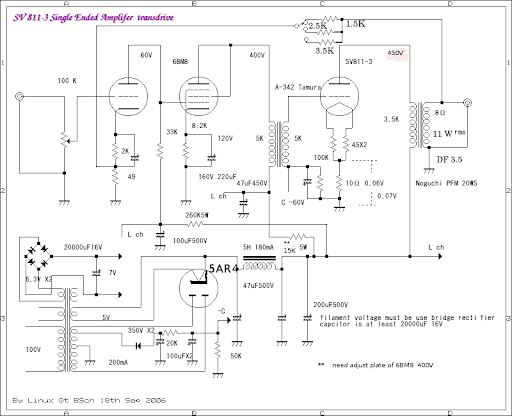

Svetlana SV811 or even 845
you can use such tubes in many ways, trading off max power for lower voltages.

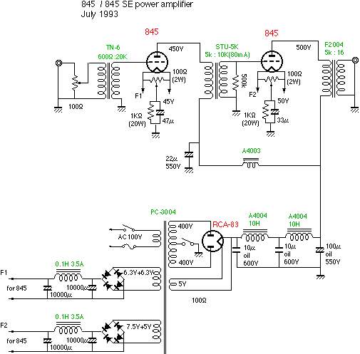

I've been running a Low Voltage 845 amp for 18 years now. This design got auditioned by bunches of people about 10 years ago at various meets and people loved it, to the point that two people built their own.
845 with 430V on the plate, Class A1 fixed biased at -50V from a -160V Supply. The 845 wants a 5K - 6K Load and runs about 62 mA at this operating point. So, this lets you pretty much choose any number of Power Transformers out there in the ever so common 430-450V regime. About 6W that is very lovely. I am using AC filaments too. To do that, I am using a 5W wirewound resistor as a balancing network in the filament circuit. This is enough to null hum on 98dB efficient Klipsch.
Your driver needs to swing 100V. I've tried a number of drivers over the years. The very first one in 2003 turned out to be a head-turner! People loved it. It was an 8532WA triode (mu 50, Rp 4.8K) driving a Lundahl 1660/10 wired in 1:2.25 stepup.
Negative fixes bias was applied on the secondary winding. There are many, many variations for the driver... IT, RC coupled, CCS loaded, Choke Loaded. Single tube w/ high gain (i.e. 8532, 5842, 6C45) to Two Tube to get you your gain of 50 or less.
In the original iteration, with the 8532W driving the IT, I was able to use an 0A2 gas tube to regulate the driver stage, and an OB2 gas tube for a -105VDC reference to build the -50V fixes bias voltage.... The negative bias supply is nothing special just a 6.3V transformer in reverse to give a few mA of 120VAC rectified to -160 VDC.

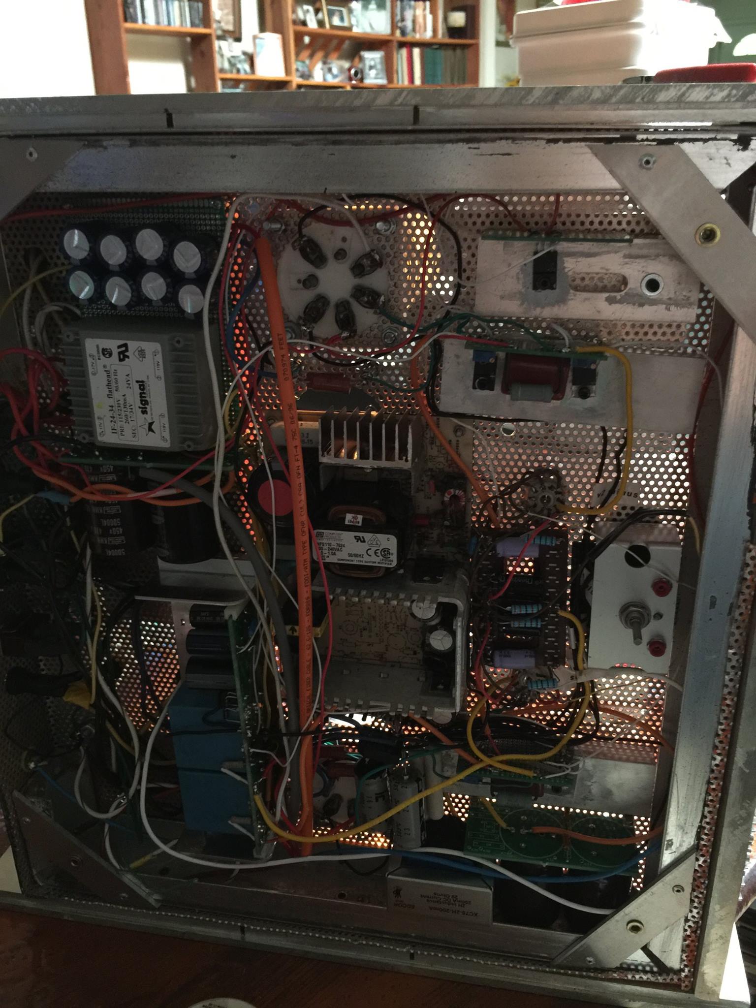

Gubernator-71, 45W / Ch from GK71, 850V only on anode. Class A2. MOSFET source follower loaded on CCS driving the control grid.

2x425, nothing special. 470 uF/450V caps are permitted. 425V was regulated to get 360V for G2, +/- 60V regulated for G3 and MOSFET driver. 20V SMPS for filaments. To start it, a bridge from 12V to filaments heats up them.

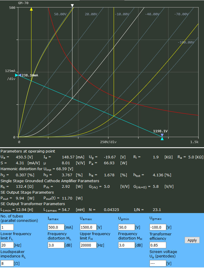

If you have appropriate 5k OPT (at least 150mA), at 450V possible reach 10W with GM70.
Triode / Pentode Loadline Simulator v.1.0 (20161216 www.trioda.com)
