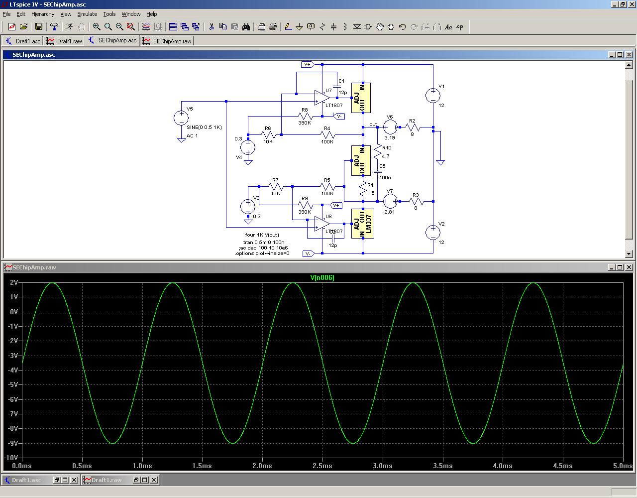

Unfortunately I ran into some troubles with my build of Elvee's amplifier... I made a set-up a few days ago in order to ***** the behavior at different frequencies.
I made some ~8ohm rezistive loads, connected them to the board and powered it up... Previous tests with this amp, where I used a pair of 4 ohm speakers went well, although at some point I had the feeling that the sound is a little bit distorted. I blamed it, at that time, on the low impedance speakers...
Now, with the set-up I made, I saw that the output was oscillating 🙁. I could measure a 1.24MHz distorted sine wave with a pk2pk amplitude of 0.8V. This amplitude was higher before the output cap and the sine less distorted. I also noticed that the opamp was getting a little hot (rough measurement with my finger).

I just rechecked my prototype, and it is perfectly stable, with or without load, with or without signal.
Is the Zobel in place? Does it have the right values? Do you see an oscillation on the power rails? Did you build it exactly as shown in the second post, or did you "improve" something?

I used the LME49722 for this build and maybe this could also be the cause.
Look no further: you have replaced a 4MHz part (LF353) by 55MHz one, more than 12x faster. Did you really expect it would go unnoticed?
First thing to do, replace your LME by a LF353, TLO82 or similar, to make sure there are no other problems, and then if it works properly you can begin tackle the grafting of the LME into the circuit.
I guess you will need to slow it down to the level of the LF353: place 4.7pF to 47pF capacitors directly between the output and the (-) input of each opamp.
I cannot guarantee it will do the trick, you may need to revert permanently to a more reasonable amplifier, or adopt other compensation strategies.
That's an unmapped territory.

Seems like a single compensation cap could solve your problem: in sim, when the LT1807 325MHz is used, it oscillates like mad, no surprise there. But with just a 12p feedforward cap, everything calms down:

Simply increasing Cdom until the stability margins are high enough that the amp can properly drive reactive loads seems not to result in good sound reproduction.
When the bandwidth of the main gain element is grossly excessive, there are few options left.
The capacitor can be viewed as a feedforward or TMC compensation bypassing the output stage at higher frequencies
