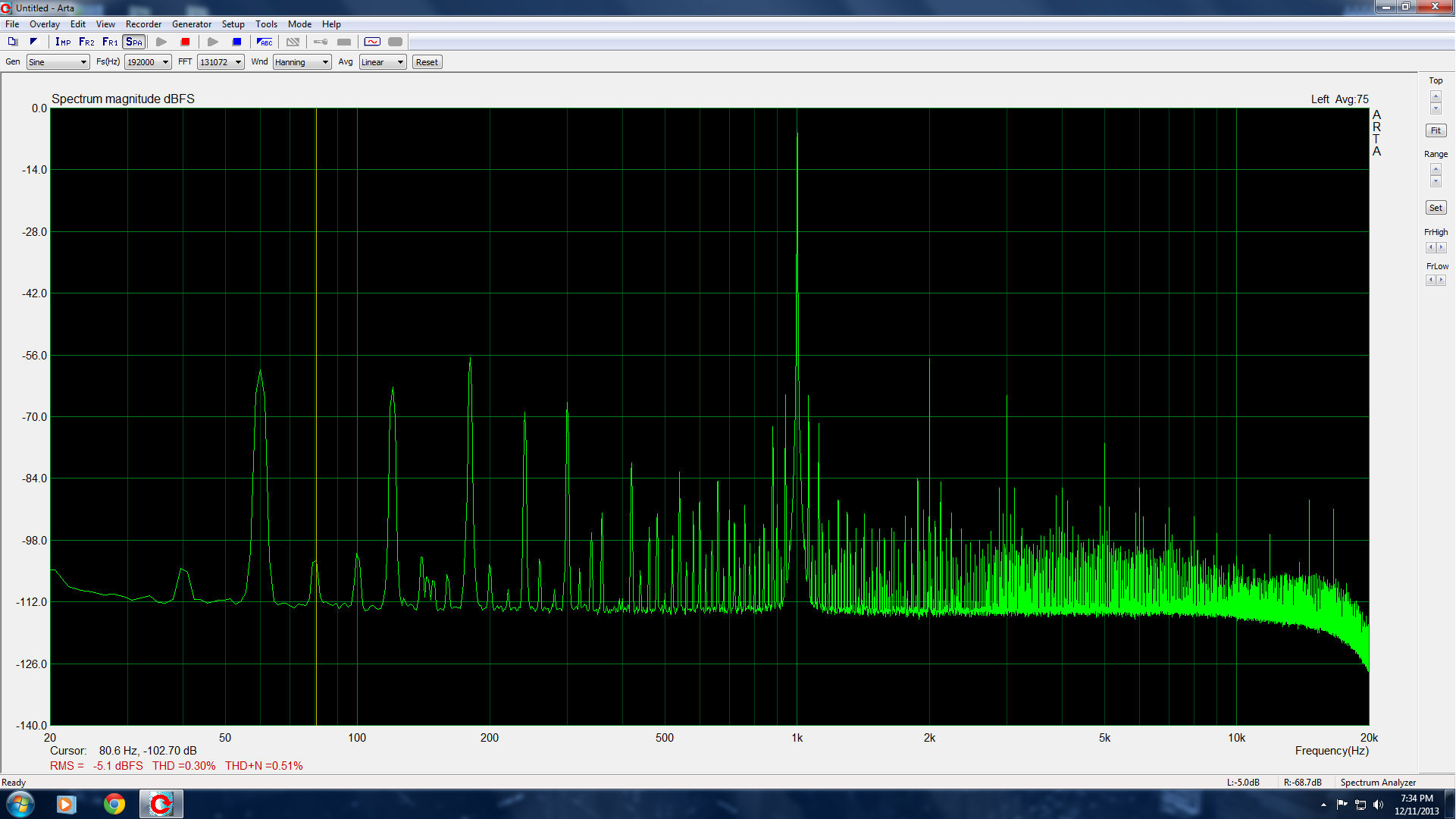

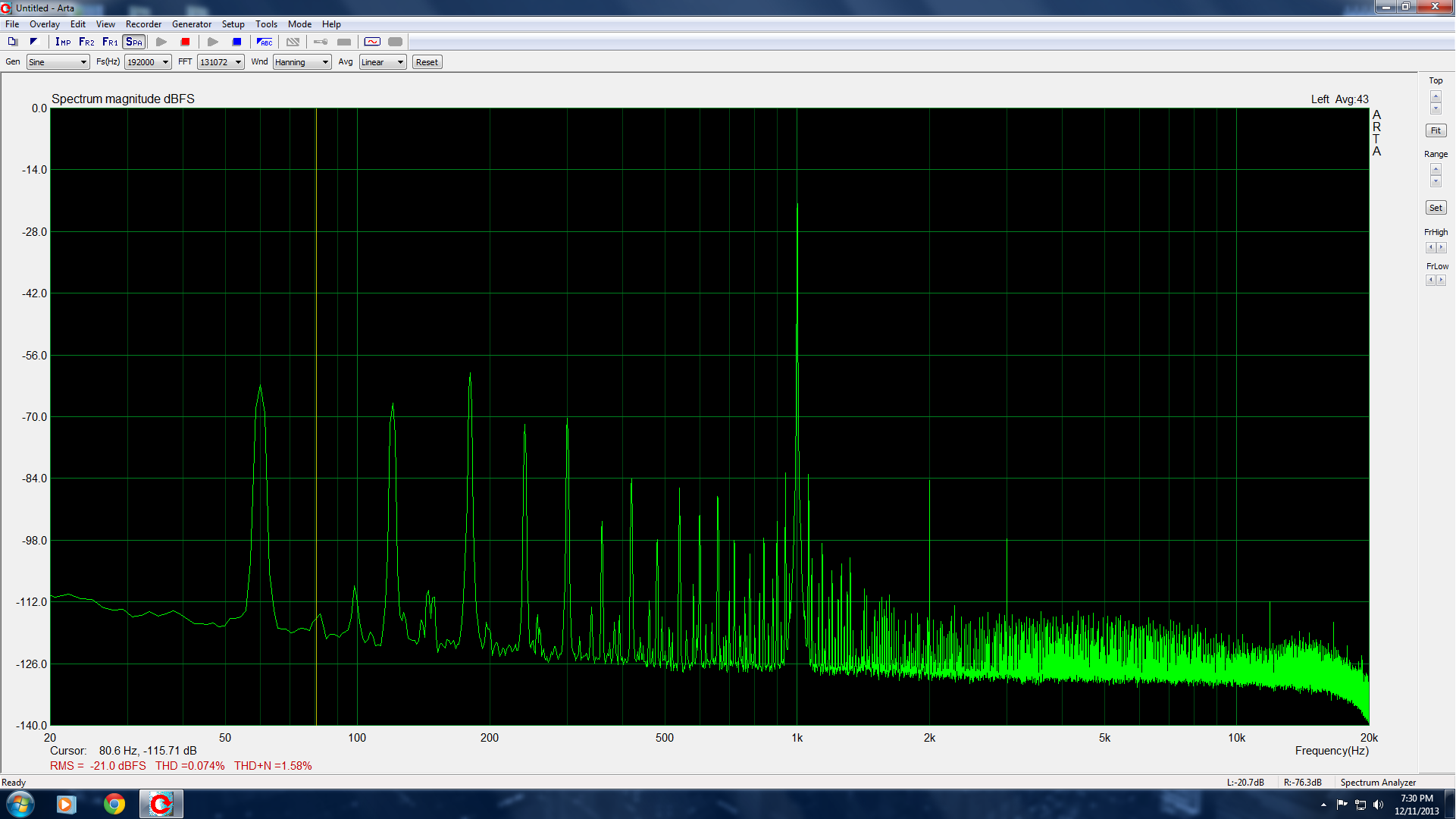

My primary complaint about the simulation is the clearly low distortion of even harmonics; the Karna does not show that in practice, but looks like SE to a great degree. Perhaps that is due to real world tube mismatch, but that is part of the benefit to the design, you are less restricted by tube matching.
So my take based on ears and measurements is that since my PP has sufficient power to drive my speakers without overload, I get the pleasant FFT with low order terms, but at significantly lower overall levels. I don't deal with high order terms, as I don't play PA level audio in my house.
Just to comment on your point, I just finished my first amp that I was able to do FFTs on the output, which was a push-pull KT88 amp with local feedback on the output tubes and no global loop. I built in a trimpot on the anode loads of the input LTP, so that I could adjust in/out the even harmonics. Even with that adjustment, I couldn't get the 2nd harmonic to be lower than the 3rd. I was surprised as I always thought that p-p amps would be odd harmonic dominated. Attached are distortion spectra taken at 1W and at 10W. My test setup is noisy, but it gets the point across.
What I take from your measurements is you have built a PP amp that doesn't properly sum the even order distortions in the output stage. No correction on the input to that circuit will change that.
In a perfect world the second should disappear on the FFT and I hope we all agree the math shows that. I guess you need to really think about where your measurements deviated from the ideal before you make claims that might be challenged.
dave
Dave,
Huh? I fail to see where I made any claim that could be challenged. I just claimed I built a p-p amp that has distortion that is 2nd dominated. Obviously I agree that in an ideal p-p amp there would be no 2nd in the output.
In the case of my amp, the imbalance occurs in the driver stage, and I knew it was going to be a problem in the design phase, which is why I attempted to put an adjustment in the input to help knock it down some. The only surprise to me was that after knocking it down a few dB, the second is still quite a bit higher than the third. It's not a problem, the amp sounds quite nice and I'm happy with it. It wasn't a critical requirement that my amp have less 2nd than 3rd. I was testing out unique circuits with the goal of learning.
My only observation is that real world amps differ from theory. This shouldn't be a surprise or controversial to anyone, since we use ideal components in theory and we can only approximate those in real life.
