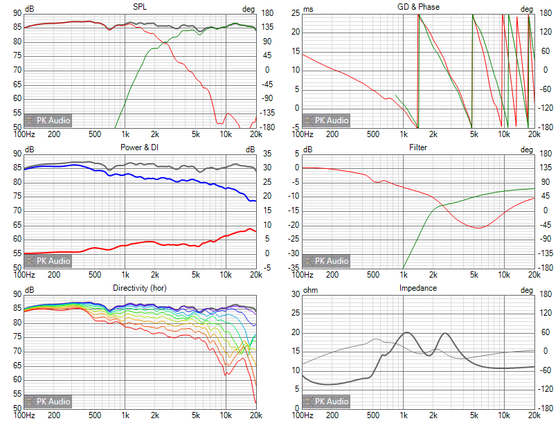

The U22 seems to be a "fast" driver in this configuration, not goes low 50Hz and low displacement of the cone below 100Hz due to the helmholtz resonator. It should a very balanced speaker, not too much bass, to keep the midrange clear.It is H2 peak 600-800Hz. It did not worry me before, and worries me even less after 3days of listening to them. No driver is ideal, I always try not to chase and be worried by every tiny detail, but rather to see overall picture and most importantly to judge how the things sound.
Not saying details don't matter, it is just that in audio we swap one bad with another bad. Nothing is ideal. My view on this H2 peak is following...there is not associated distortion peaks of H3-H4-H5. Frequency response is reasonably linear. There is not much one can do to get rid off this peak except cone edge treatment. I assume general consensus is that H2 adds some softness, veils the things. So far I did not detect any softness or anything negative that I could attribute to this H2 peak, and actually I did not detect anything I would not like when listening to this driver. Bass is well defined, no slow and muddy sound, midrange has clarity. Its sound is open. For example, compared to 18W revelators or classics, they all have elevated H2 in the midrange and yes they have more softer midrange, less clear open and articulate.
Of course these are all impressions after 3days listening, it always take some time to get familiar with the sound of the new drivers, let them burn in, do more listening sessions and recognize the issues and or just make fine tuning of the crossover.

jerome69: yes, the listening impressions confirm what you described. Unfortunately I do not have any experience with Excell drivers. I simmed the bass alignment with W22NX003, you have previous version of this driver. It has ~1dB lower sensitivity and same volume it goes little lower. Sound character could be quite similar.

Qms also includes damping losses of eddy currents in the voice coil former. E.g. Seas and Dayton use Aluminum formers, and and as Aluminum is a very good conductor the losses are high and correspondingly Qms is low.
In comparison to "pure" mechanical losses (e.g. of the surround or suspension, that are highly nonlinear) the voice coil eddy current losses are pretty linear and give neglectable contribution to distortions. On the one hand there is better cooling of the voice coil as Aluminum is also a very good heat conductor, on the other hand you lose 1-2 dB around the resonance frequency in comparison to a non-conductive material voice coil former.
No.
There is no equivalent in the TSPs for the eddy current losses, but they act like mechanical damping and cannot be distinguished from it with the usual added mass or added volume TSP measurement techniques.
Qes = 2pi*Fs*Mmms * Rdc/Bl^2 only consideres the force factor and Rdc on the electrical side. Both are not affected by eddy current losses.
