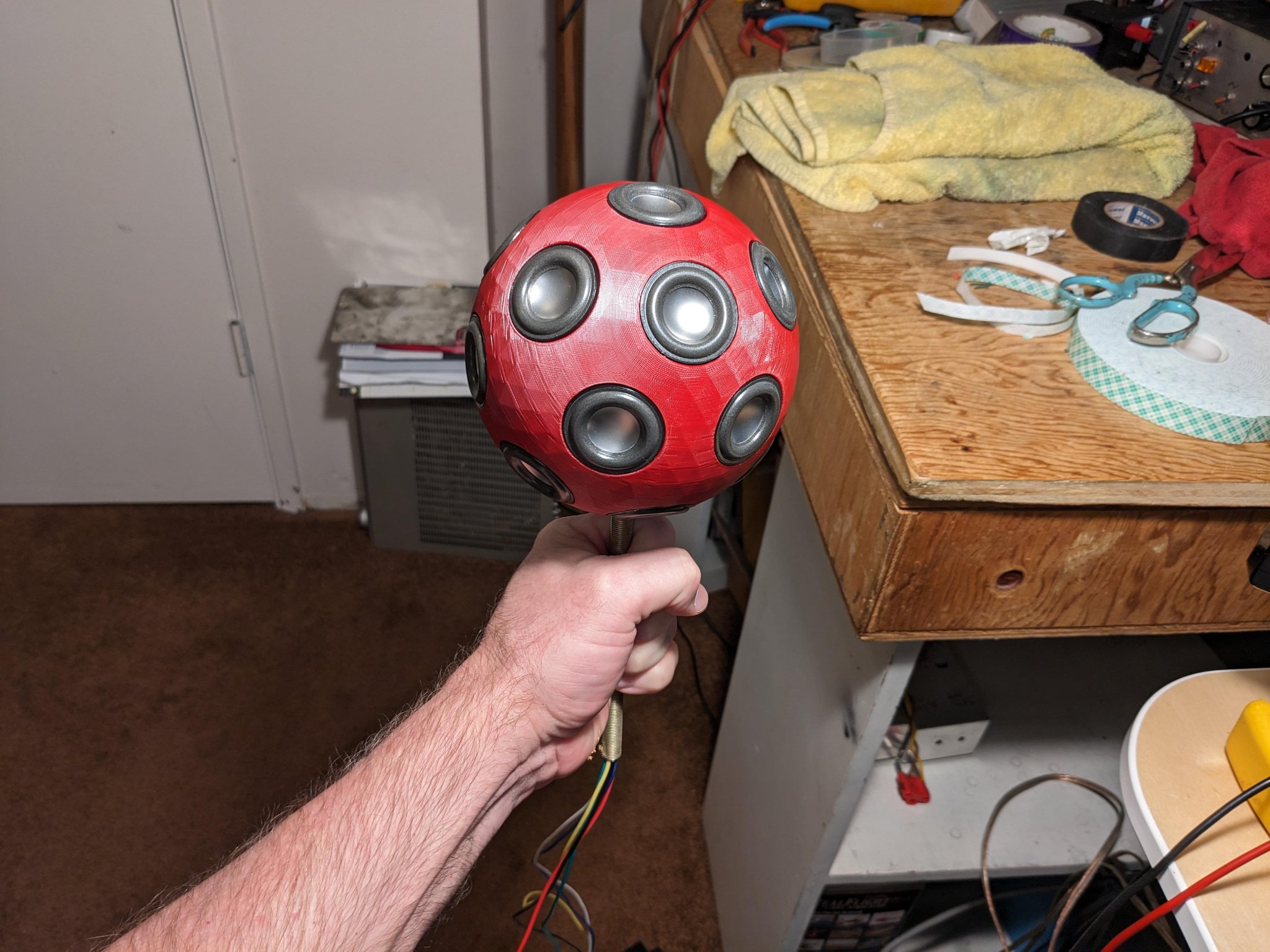

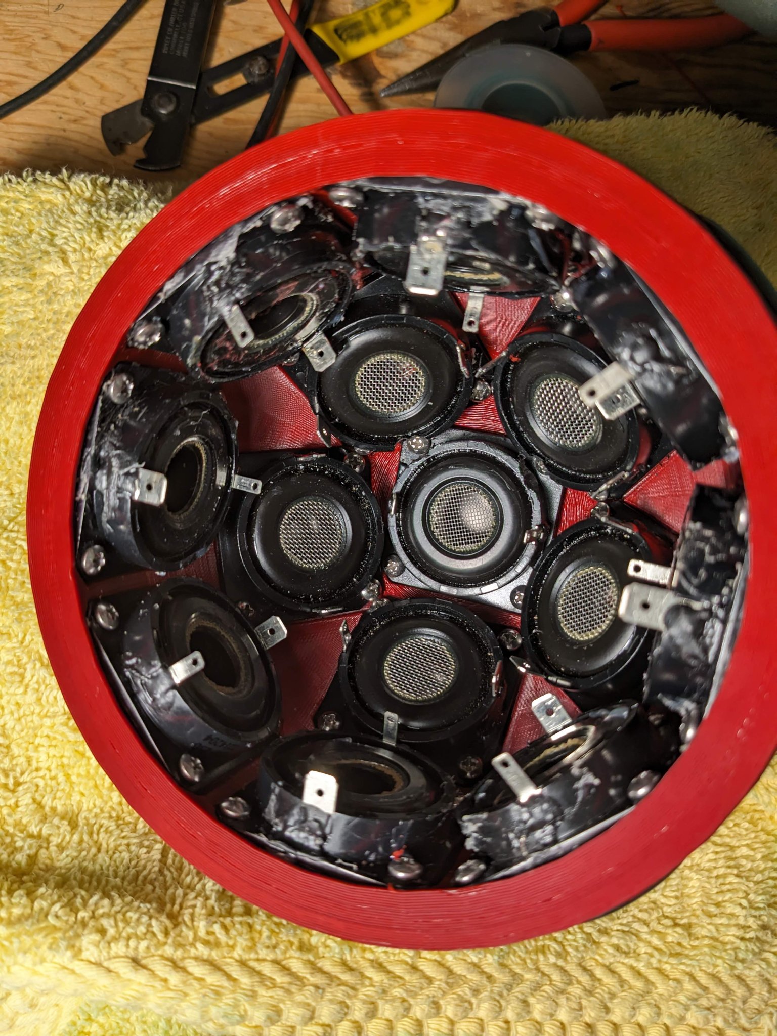

Nice!If you don't have Trypophobia, you might enjoy seeing and hearing the new spheres I'm building for this show. The sound of twenty Aurasound Cougar 1" drivers on a 6 inch sphere.

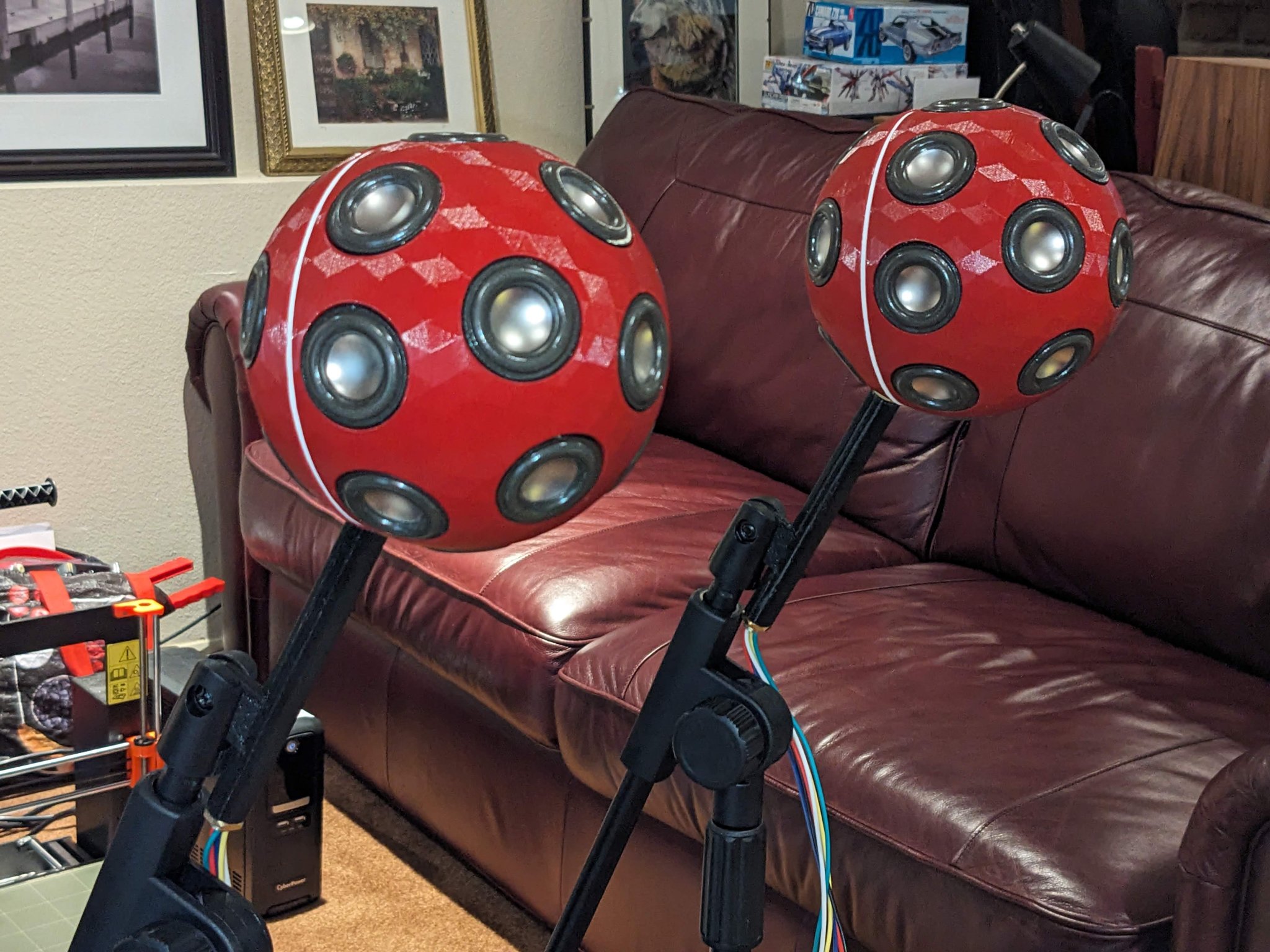

Nice!Two spheres are now in orbit.

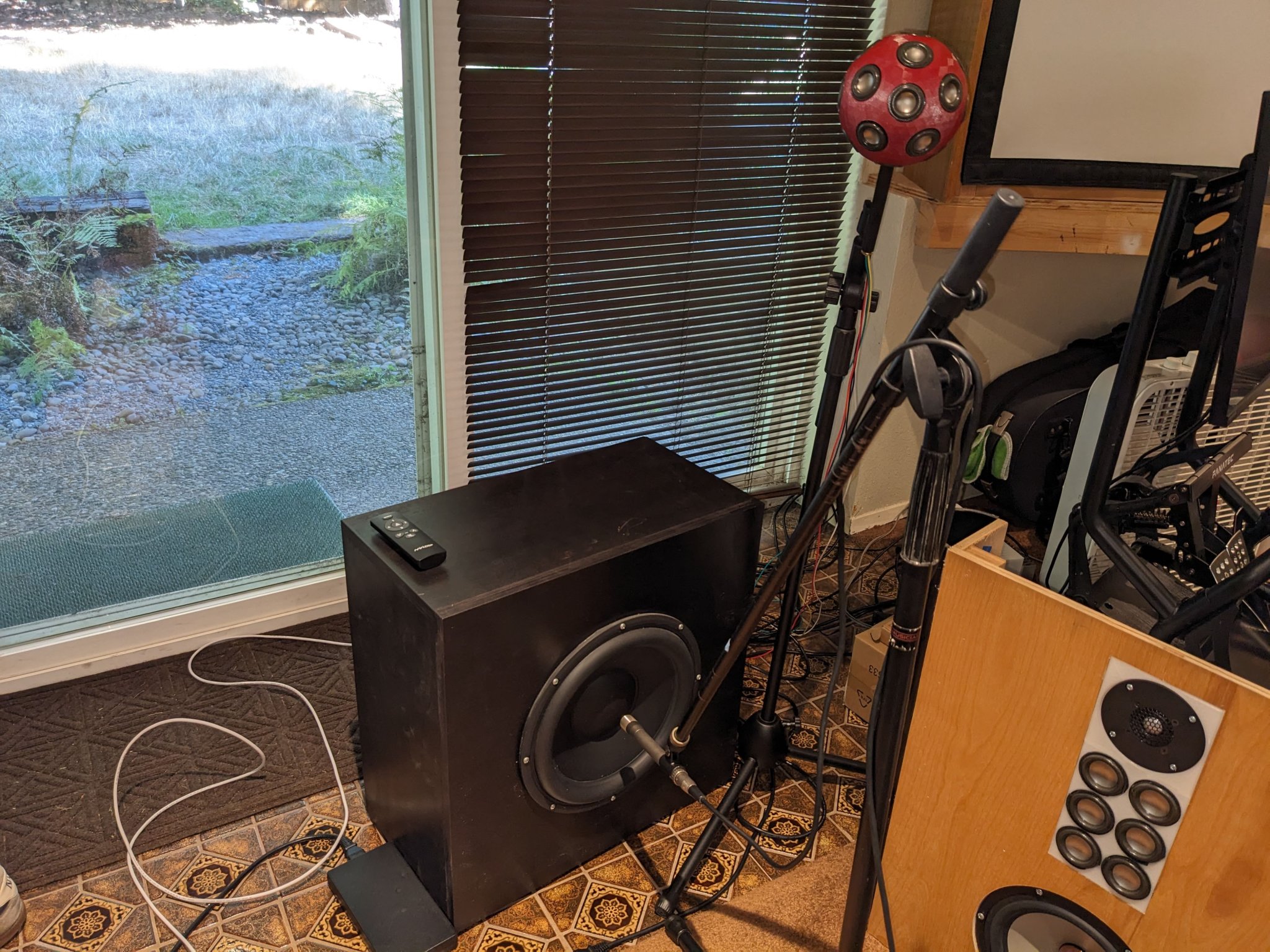

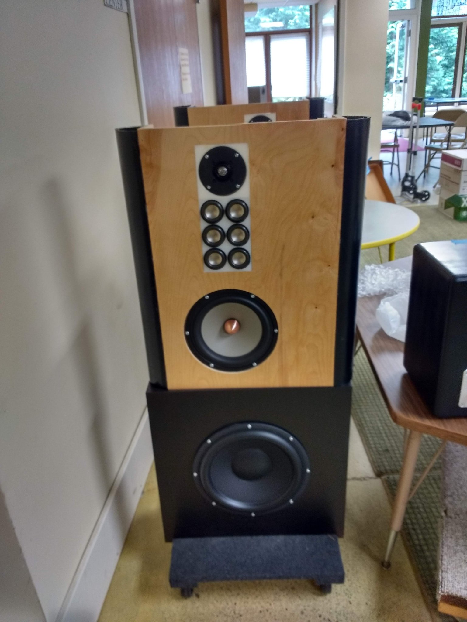

tonyEE: "Hey... what's that open baffle speaker in the picture?"
Those are my four way wide baffle, wide dispersion speakers I assembled in 2018. They are actually minimum volume sealed enclosures on a wide baffle. I didn't have room to haul those to the meeting today. They have custom transconductance amplifiers, four way digital crossovers and play with 0.1% distortion at typical listening levels. They have 90 degree dispersion up to 15 kHz. I was riffing on the Grimm Audio monitors but with wider dispersion. So 19 mm seas tweeter, six 2" Aurasound midrange, 8" Seas magnesium upper woofer and 12" Scan speak woofer.

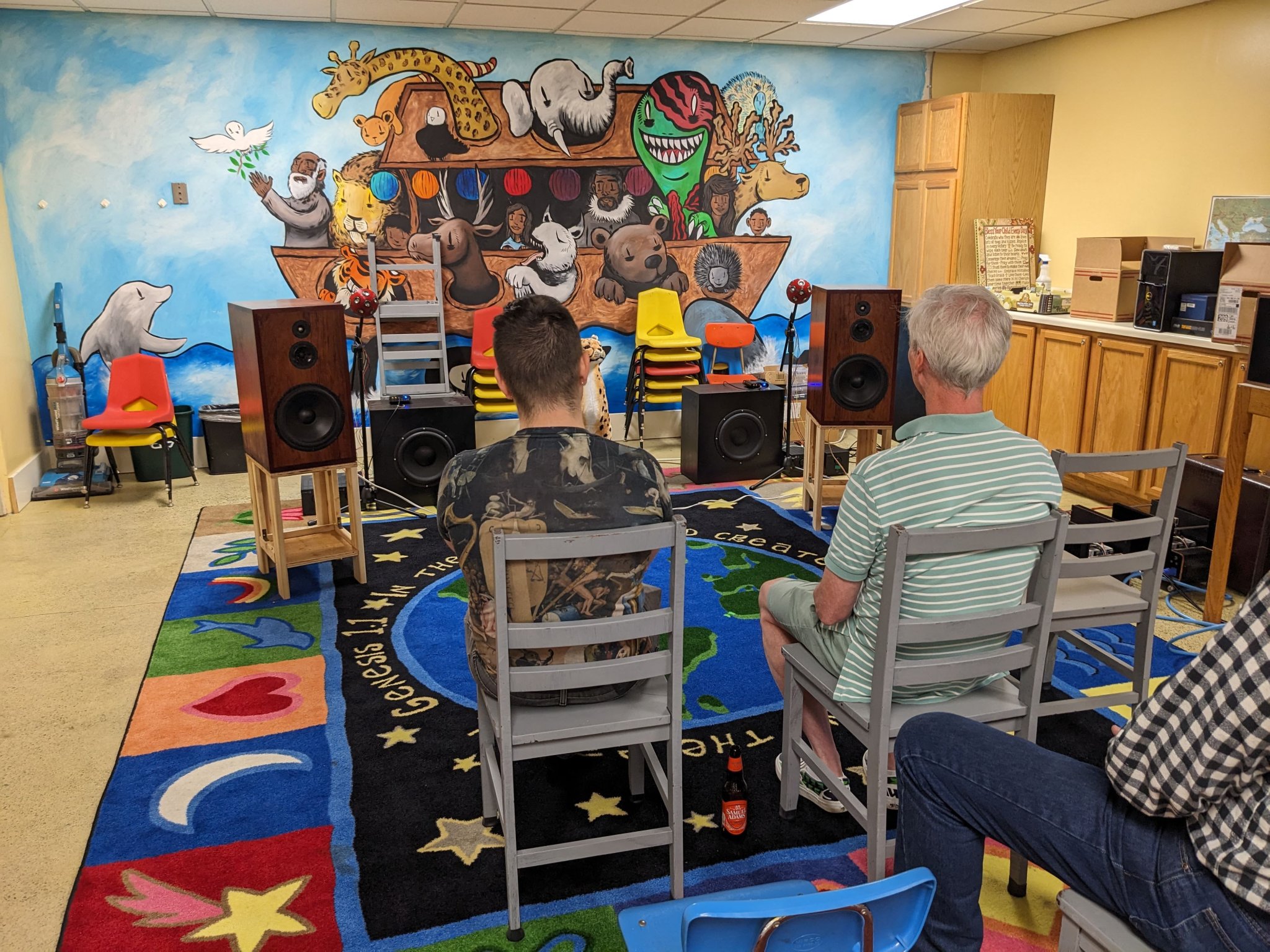

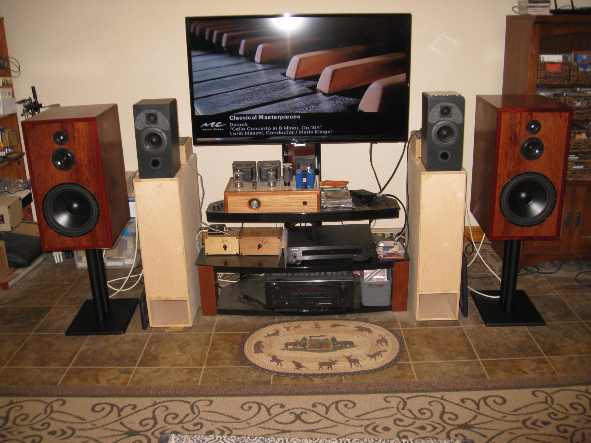

Dave explaining the construction of his three way box speakers.

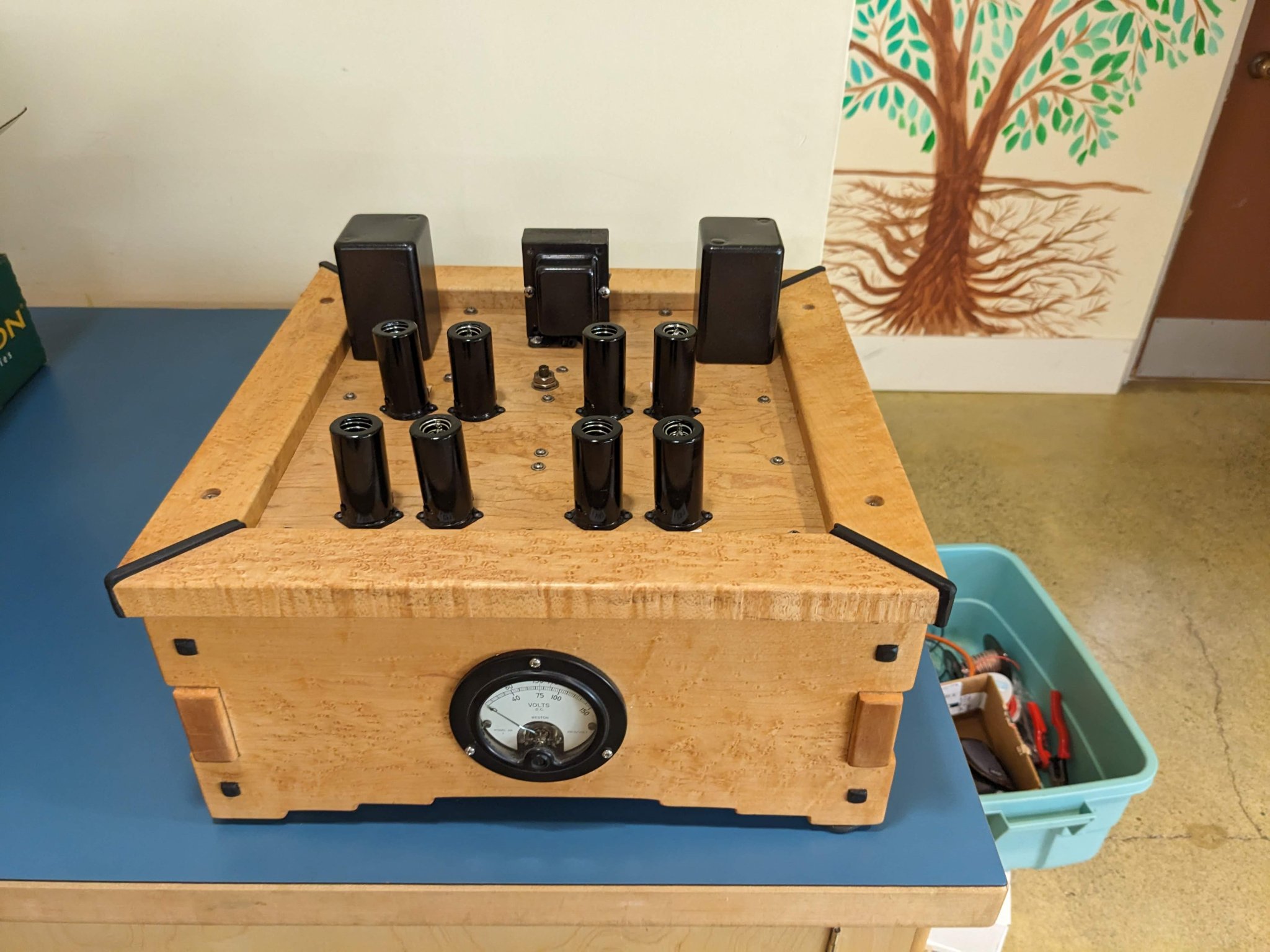

A phono preamp

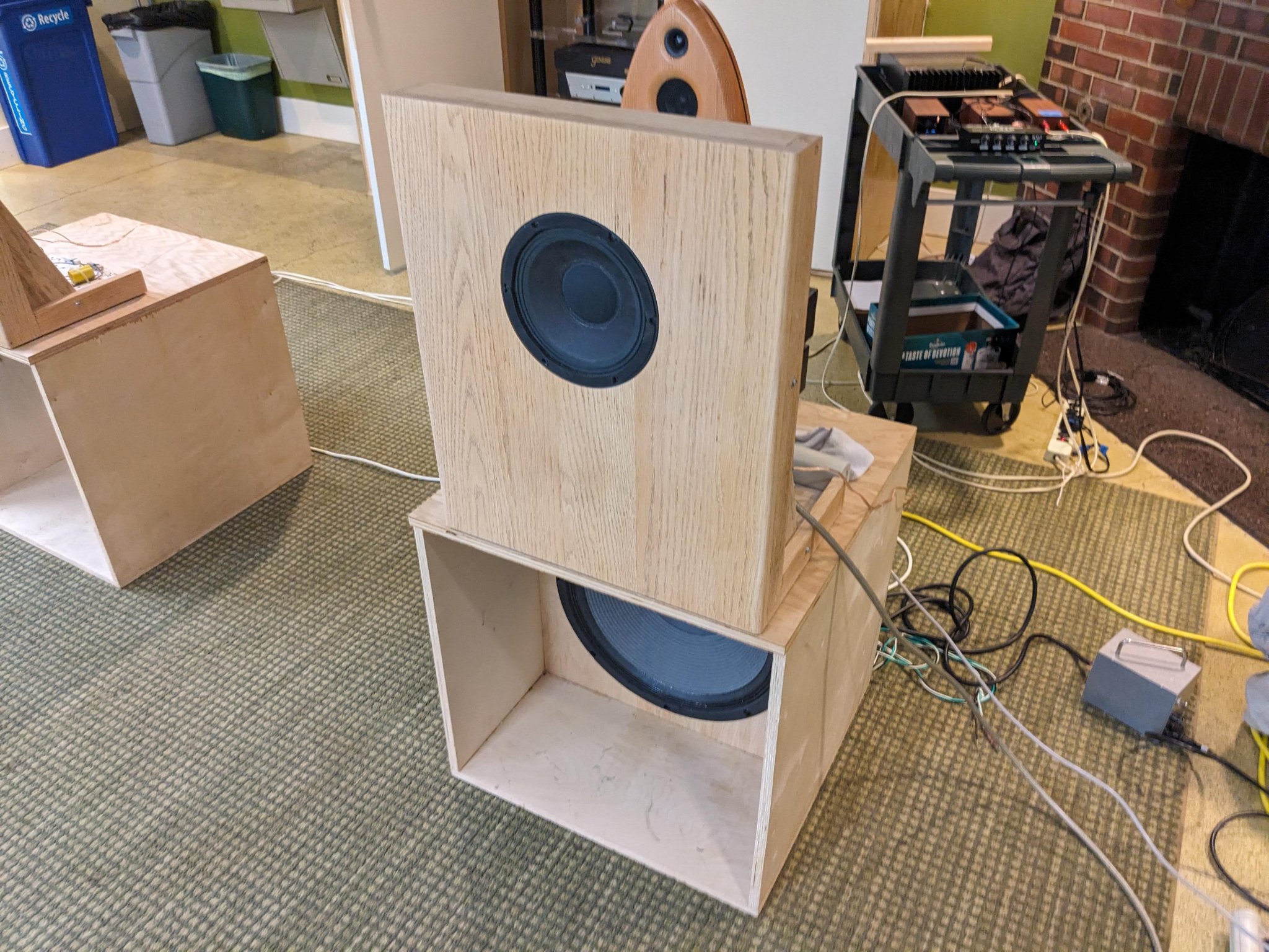

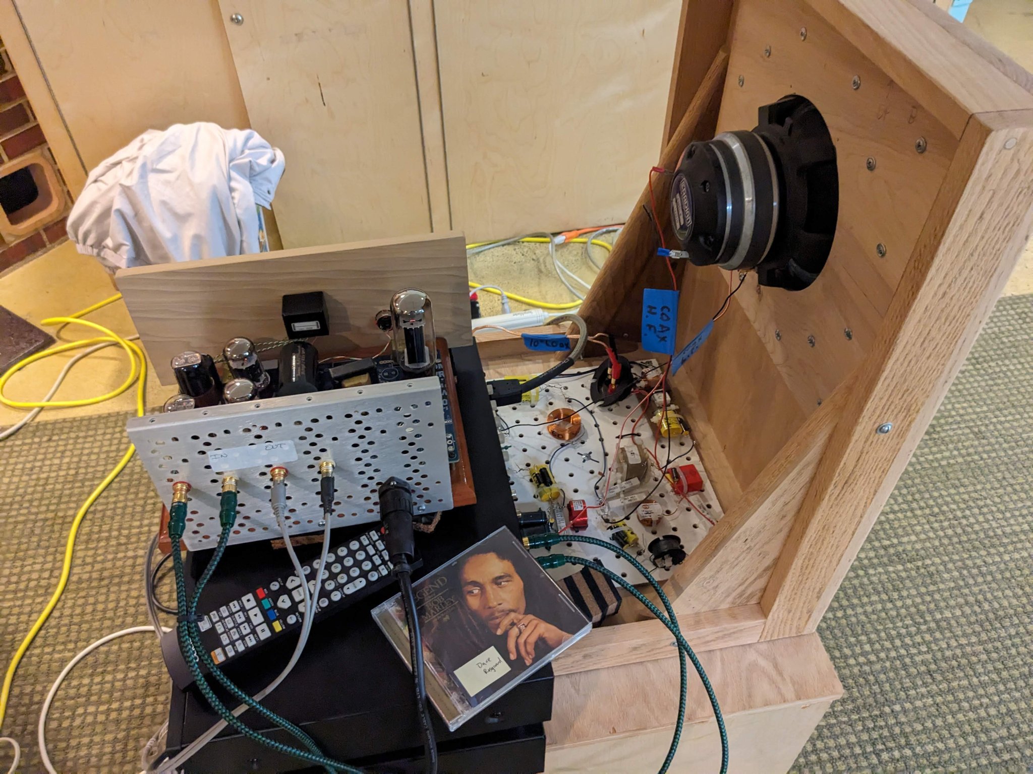

Open baffle with coaxial driver, Terry

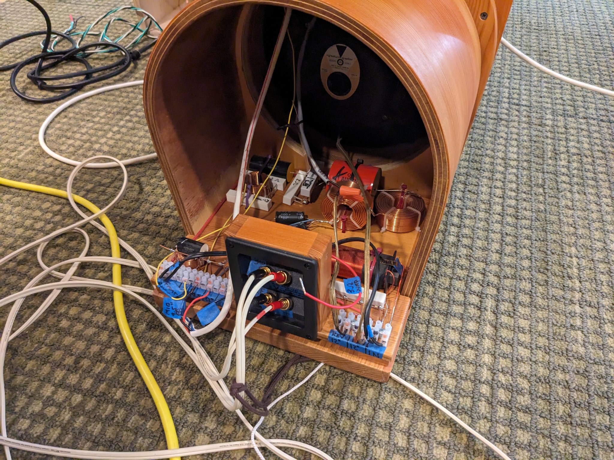

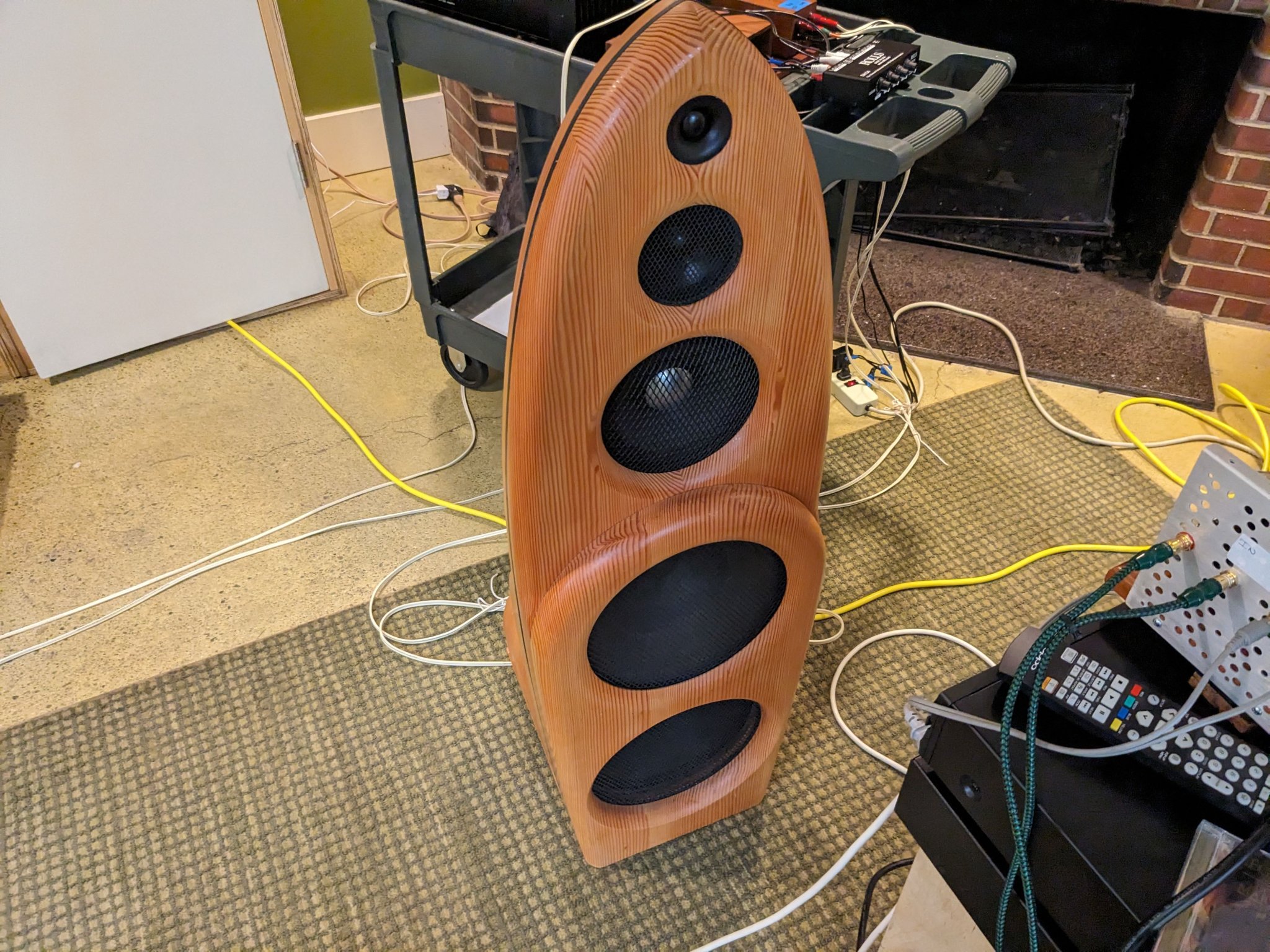

Howard's beautiful Surfboard open baffle
A phono preamp

Dave's 3 ways look like Harbeth M40s.
Your spheres look like... mushrooms. ;-)

Bring your speakers to Petaluma... Your four ways... awesome. What is the amp like?

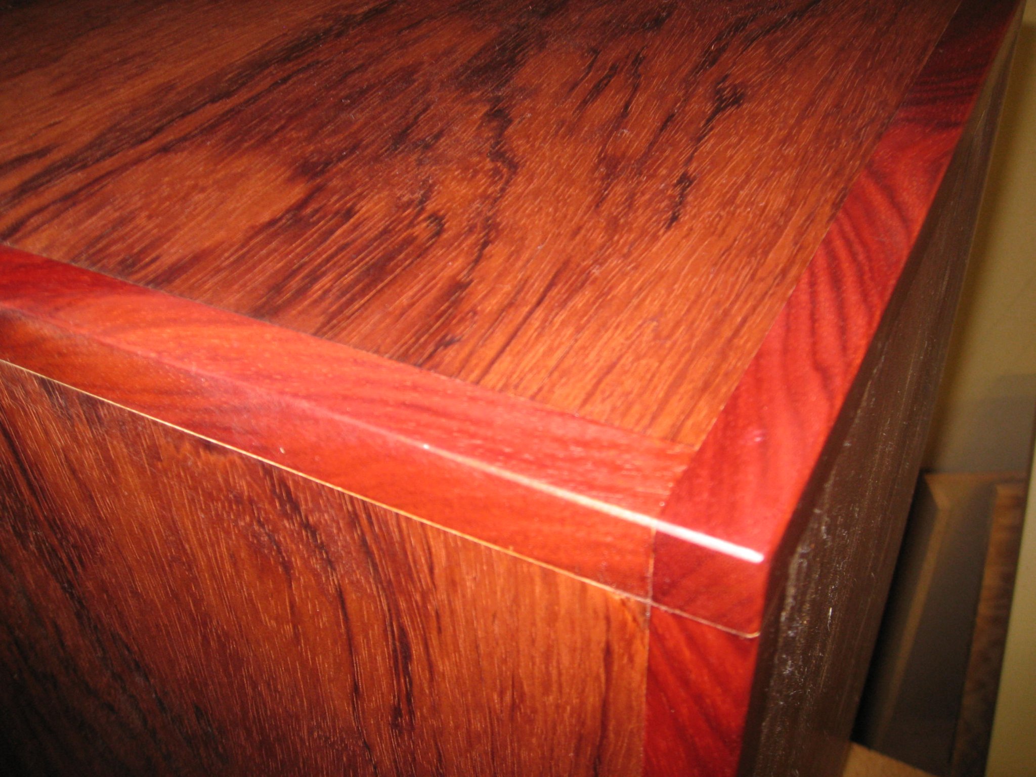

My 3 ways are ~60 liters, made with bubinga ply and cocobolo edges. Woofer: Seas P25REX/DD, Mid: Seas 10-FM, Tweeter: Audax TM020J5.Dave's 3 ways look like Harbeth M40s.
Box has rear-mounted resistive vent, and mid has separate (internal) enclosure with stuffing. The crossover is full 3-way series, low Fx: 600 Hz, hi Fx: 6 kHz. Impedance is about 5 ohms above 200 Hz. Acoustic phase alignment is less than 10 deg through most of the crossover regions. Really like the wood grain.
