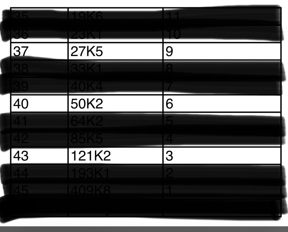

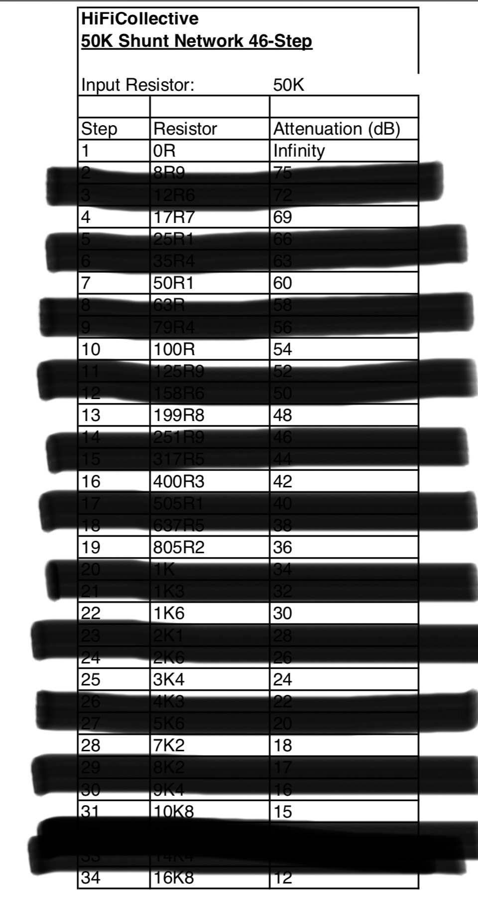

I just got hold of a 15 steps Plessey make before break rotary switch and intend to use it as a stepped potentiometer for volume control of my passive pre-amp.
I am seeking advice on the resistor value required.
Using the HiFi Collective 50K Shunt 46 steps as a guide, I decided to skip every 2 steps on their 46 steps, and used the remaining for mine. Is this the correct way?
(Number rounded)
1 - 0R
2 - 18R
3 - 50R
4 - 100R
5 - 200R
6 - 400R
7 - 800R
8 - 1K5
9 - 3K
10 - 7K
11 - 11K
12 - 17K
13 - 27K
14 - 50K
15 - 121K
Thanks!

1) What is the series resistance?
Do not understand your question, I am trying to build a 50K (or there about) shunt stepped potentiometer if that was your question. It starts at about 9 dB step attenuation and gradually reduced to 3 dB attenuation per step.
2) what circuitry and components are before the volume control?
CD/DAC output, it connects to power amp. Intend to use it as passive preamp initially and may use it for volume control of active preamp later.
3) Is this a make-before-break switch? Yes
If this is a 50k shunt volume control, that means there is a fixed value series resistor just before the control.
Probably that resistor is 50k in value.
In fact, the HiFiCollective info in post #3 does indeed say that there is a 50k input series resistor.
Thank you!

Actually, you can do this with a shunt type attenuator, which was described in the original post. That type has one large series resistor (50k in this case), and an arbitrary number of additional resistors that form the other resistor of the voltage divider. So the OP could take the design he has and use every other resistor value if he wants, and that will work as I think he intends.You can't just delete steps that way.

Thank you, I was going with a shunt initially but decided to change to a series…You can't just delete steps that way. You can select the steps you want and add all the resistors between them. That is a very substantial switch. It looks like its for high current. Hopefully those are silver contacts.
My understandings is that with the shunt I could just jump and omit those between, but with series I will have to add the value of the omitted resistors, as confirmed by another contributor.
The switch is a NOS Plessey Type 72
Thank you for the clarification.Actually, you can do this with a shunt type attenuator, which was described in the original post. That type has one large series resistor (50k in this case), and an arbitrary number of additional resistors that form the other resistor of the voltage divider. So the OP could take the design he has and use every other resistor value if he wants, and that will work as I think he intends.
