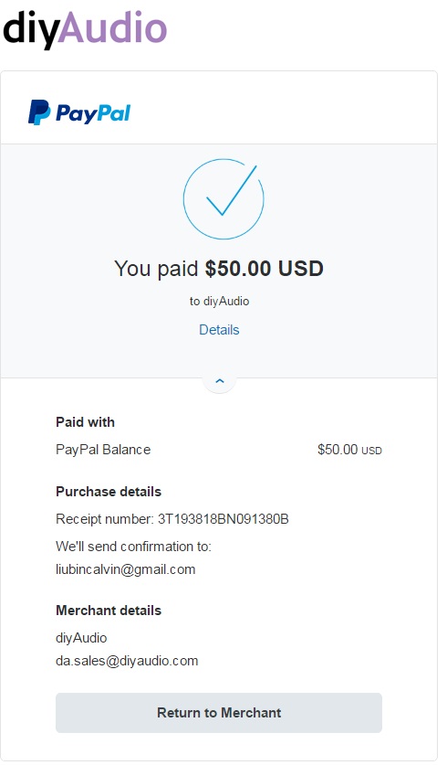

Hi Bob,
Thx for the suggestion. I was thinking of donating towards the year end. Looks like now it is a good time
$50 is just donated to the forum. Will donate more in the near future.
