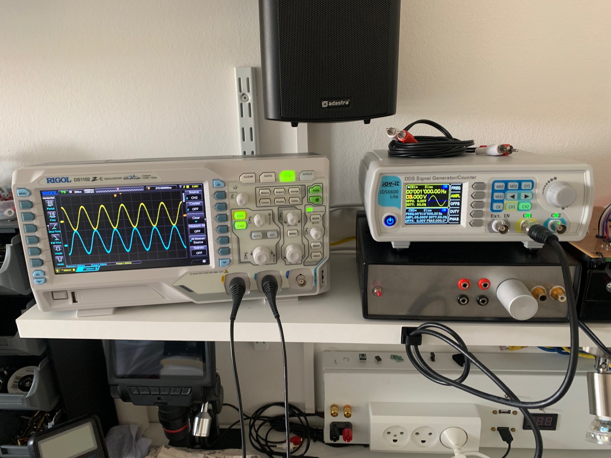

So waiting for some part's (like Xmas everytime) 🙄
I realised that I need some sort of balanced source to test with.
I don't have any of that so I mocked up a board I had spare (MagicBus's Behringer balanced board) with an OPA1632 so to have a SE to Bal. output.
It seem's to be working as expected... ( As it does in my hacked Behringer too MagicBus's balanced board )
Have a nice sunday out there!
Jesper.

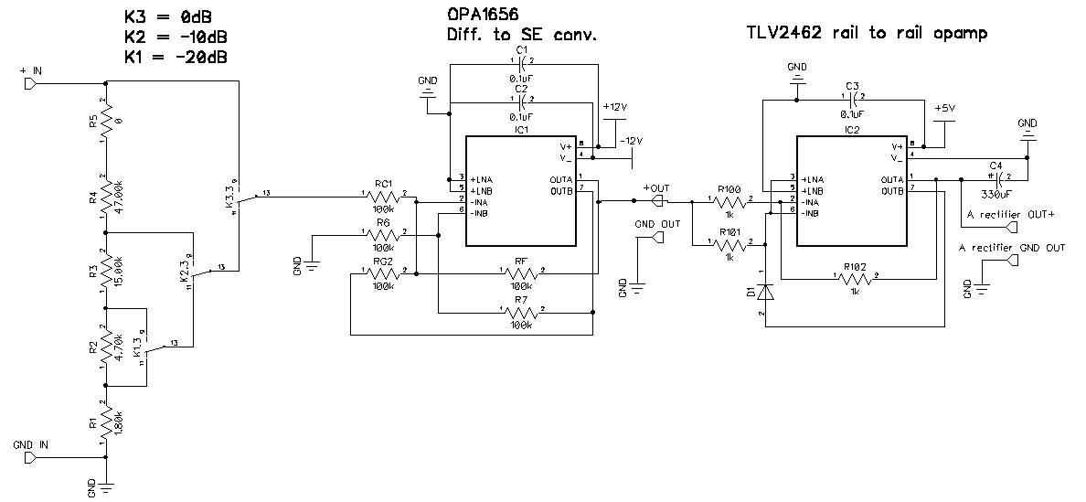

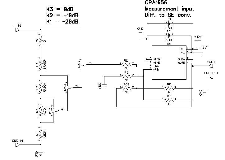

Hello folk's...
I'am doing some testing, but I'am having some problems when using the voltage-divider circuit I have on my protoboard.
When measuring with a sine input into the relay voltage divider's it's working as expected.
I can choose between 0, -10 and -20dB with K3, K2, K1. -So the circuit is working correctly. (I tested both when measuring voltage or resistance and engaging the relay's)
When I afterwards try to feed the OPA1656 from the divider circuit, it's working fine when relay K3 is engaged, sending the sine directly into the opamp. (0dB)
But when I engage K2 or K1, the signal is "dragged" down to near zero, or at least to something unusefull.
I'am sure this is something impedancewise, but I need some help figuring out what I'am doing wrong.
Any help appreciated here 🙂
This is my testcircuit
Hey , you probably missed one thing. Circuit with opamp have some input impedance, which acts as additional load to your input resistive divider. When you calculate divider, that input resistance must be known and enteted into formula too, to get proper bottom resistor of voltage divider.
In your case , 1k resistor values are very low and probably needed for frequencies like 1Mhz or so. Try simply to increase them all lets say 100 times , because opamp itself have very high input resistance, it should not make worse .
Also there is another possibility, to create adjustable sensitivity circuit. In differential opamp circuit (as i remember, you need with differential input) , you can increase input resistor to value higher than feedback resistor , and have gain less than one. Divider would be not needed at all. You can switch input resistor with double relay .Try to simulate that .100k /10k resistor ratio would give you output 0,1 of input amplitude.

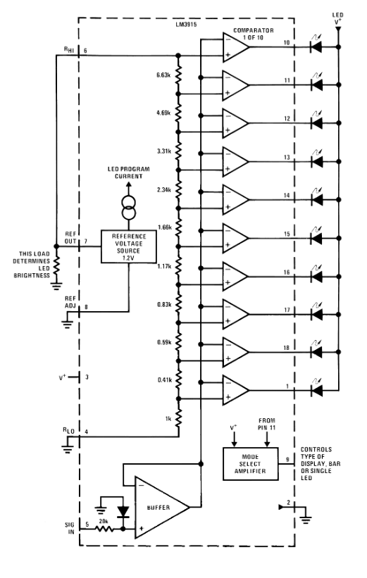

Yesterday I learned about the Lm3915 and I ordered a few for a test. Less worrying about managing the input voltage in my case and we could measure the output directly without worrying about amp gain. Leaving aside dividing the voltage, datasheet says "Input Withstands ±35V without Damage or False Outputs".
We can use the reference (0dB) for a hard limit interrupting the signal and use 10 resistances to read discrete values with 3dB resolution from the output with an ADC.
Not sure if it's elegant, but I find it interesting. And we can get the LEDs for free.
Related post.
Related post.
Interesting and possible solution. You can replace led's with optocouplers and get voltage levels info safe way to mcu . Or you can try pullup mcu inputs with 10K and pass through diodes to lm3915 outputs , place resistors in place of leds ( don't remember now if lm is pulling down leds cathode to ground ).
Yes, I missed this.
If led supply voltage can differ from main lm3915 voltage , probably just pull-up outputs with resistor and no diodes needed. Inverted logic in code .

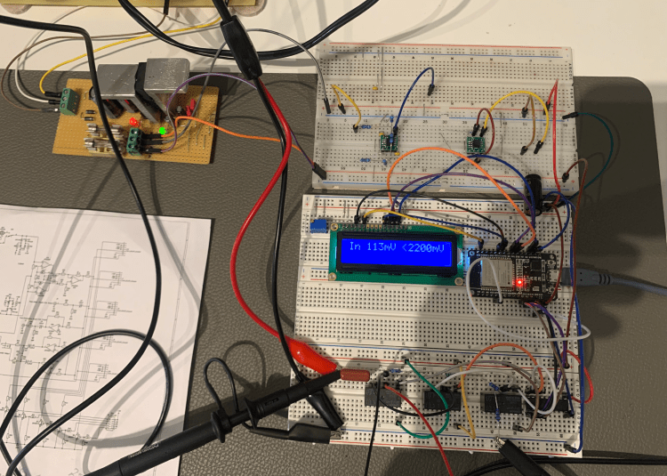

I really like all the suggestion's and idea's & tip's comming here!

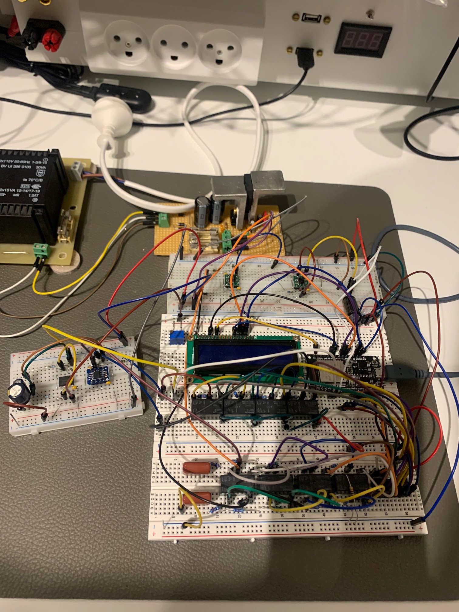

I did some programming, and I got some pre. autoranging working on my protoboard 🙂
I took a video of the stuff...
SuperRanger
Only some simple code for now, but needed to see if I could figure it out from scratch.
Idea is to levelshift from 300/800mV and then amplify to desired voltage afterwards.
Jesper.
SuperRanger
Jesper.

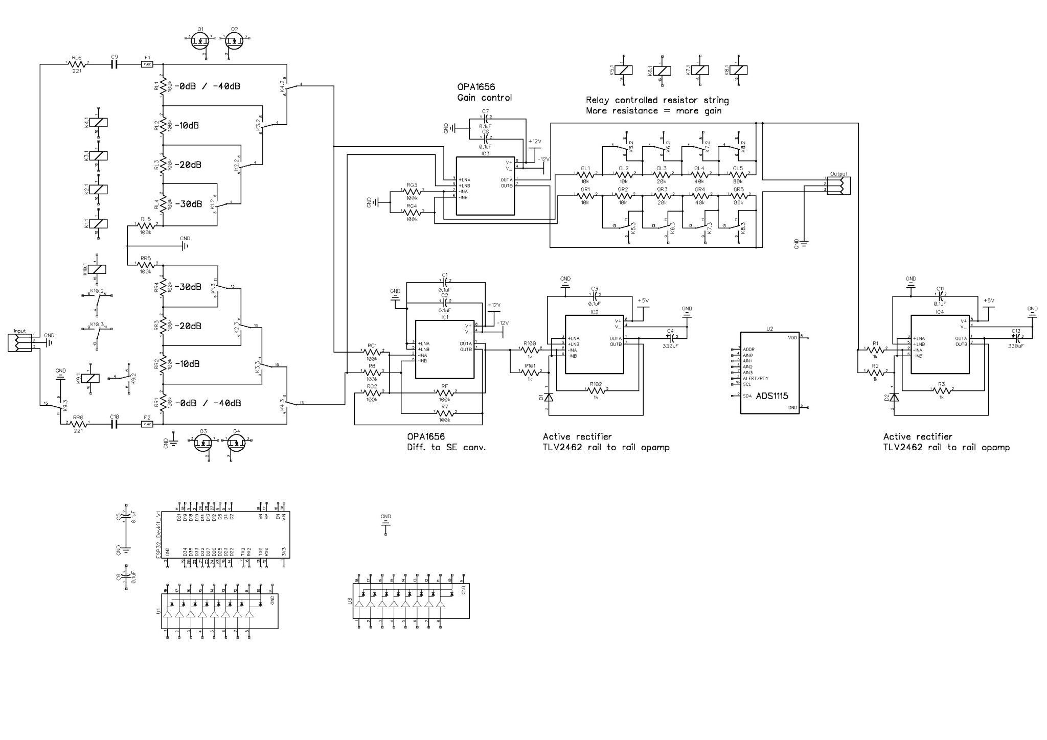

Hi...
I think I need some advice.
I have setup the attached schematic on some protoboards, and it's working as expected more or less.
I also tried connecting my Behringer soundcard at the output to see if it would send a sine through it, it's working fine, allthrough it's not pretty noisewise ofcause. - But it's working.
I have the code with hysteresis working partly also, the ESP32 is sooo fast, it's nice to deal with. (I attached a video in previous post)
Looking at the schematic, please don't mind the extra part's and the wrong resistor values in the input -0dB -> -40dB attenuator part.
Also note that I use the ESP32 internal ADC now for my code, but I decided to buy an external one as suggested at first page of this thread.
So right now I'am waiting for a protoboard with 16bit ADS1115 ADC. -Reason is, that allthrough it's working fairly well, I need big hysteresis and so, for dealing with the noisy and a bit flickery non linear ESP32 ADC input's.
Schematic short explanation :
Input through -0dB to -40dB attenuator depending on the amplitude of the signal.
Diff. to SE conversion with an OPA1656, and next into an active rectifier feeding the 1. ADC.
At the same time the signal is feed into another OPA1656 witch amplifies the signal through the resistor string to give disired output amplitude.
This is feed into another active rectifier and into 2. ADC.
The input on the 1. ADC and the 2. ADC is used in the code to control the relay's ofcause.
So, what I need advices for is the following quistions...
1. Is it enough to short the lower input to GND to choose between SE or Balanced input, or do I need additional stuff to deal with this?
2. Do I need a dedicated balanced to SE conversion at the output also?
3. Do i miss some decoubling at the opamp's beside the decoubling i have at theyr'e powersupply pins.?
All advise is gladly taken ofcause...
I really hope for some good hint's 🙂
Jesper.
