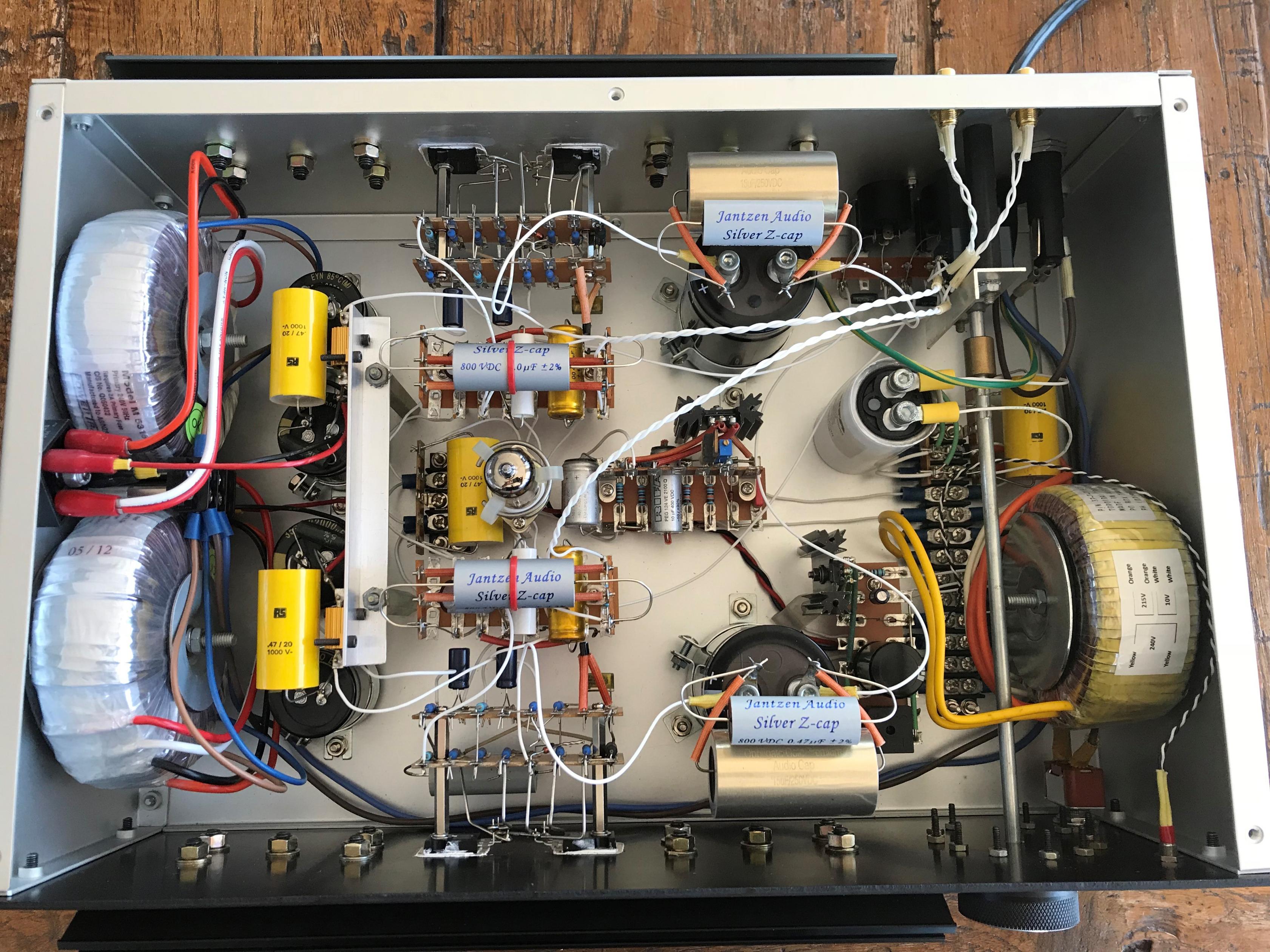

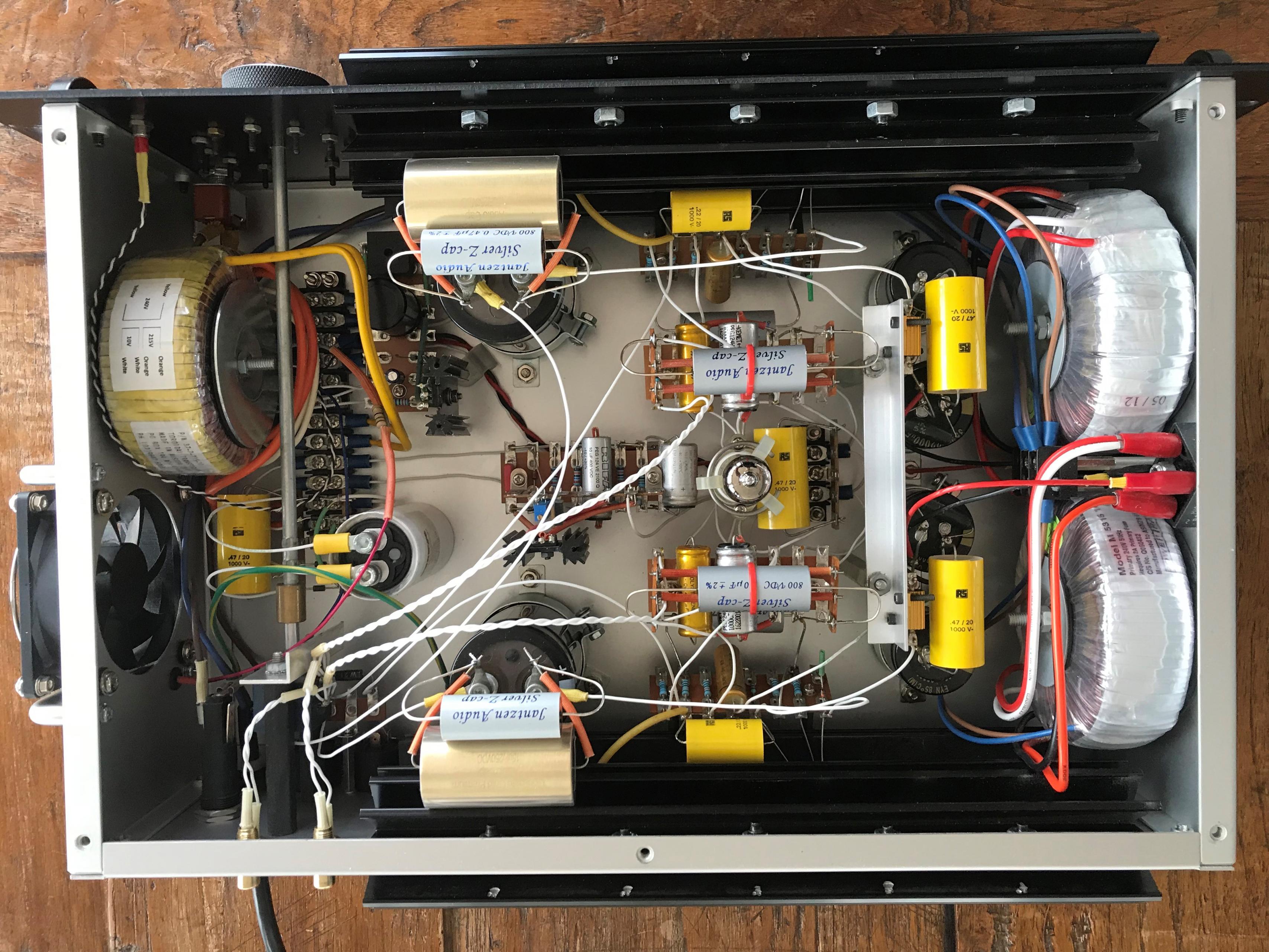

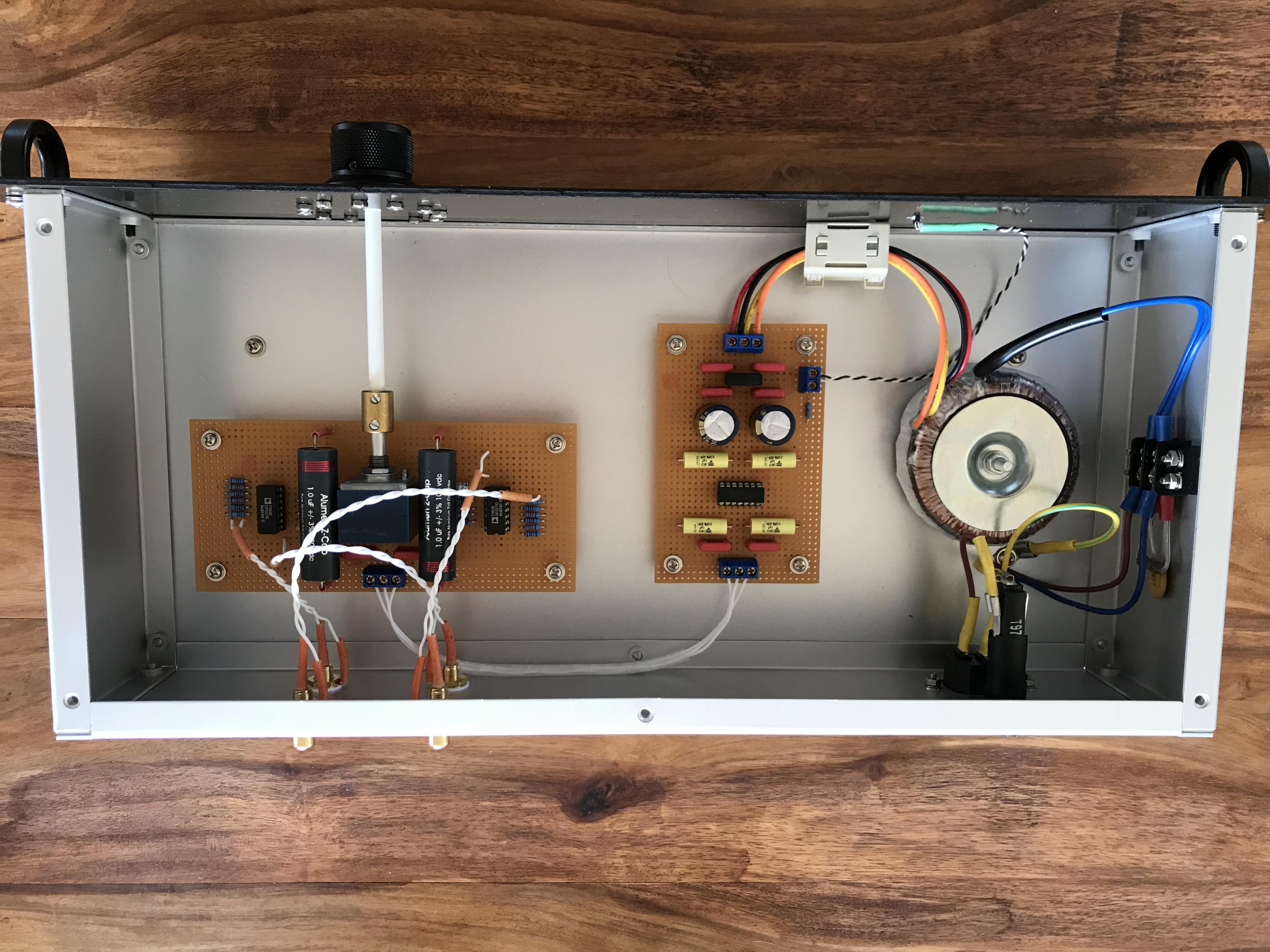

Hey all, I've built this design a couple of times now and the pictures below are of my latest build. I used an Elektor op-amp design with "high-end" caps and the set-up is magical. I typically drive the SEWA with valves (Class A or SRPP), but oddly enough this op-amp design is the best I've heard.

Chris - I really like what you've done there. The pre-amp looks great, nice high quality parts, very clean construction. It's one of those secrets that many won't admit - a good opamp is a great solution.
I like the construction method for your SEWA too; a little off-the-wall but I can see your 'valves' heritage in there.

Class-A or tube lovers prefer opamp with second order distortion, monotonic distortion spectrum or simply opamp with very good mid. OP27 is known for its vocal superiority, and OP227 is an improved version of OP27. The only issue is probably the 2.8 V/us slew rate which is low but probably not too critical for most music.
Other opamps that might be preferred by tube lovers are AD795 (slew rate below 2 V/us), AD823 and LT13xx (LT1358 for low current, LT1364 for high current drive).

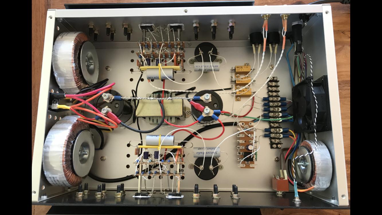

Hi again all,
I recently upgraded my OTA (2.5-Watts) to SEWA (3.3-Watts). This has a valve based Class A pre as the driver. Attached you'll see I dispensed with half of the heatsinks and fan - runs only warm. Very pleased with my upgrade.
