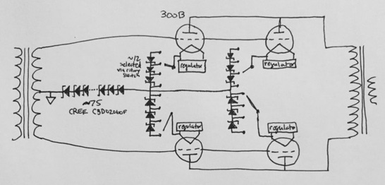

At least separate bias means you can get the bias right.
And minimize DC in the output transformer.
I just posted this in another thread, but how about this schematic for output stages designed to always remain in class A?
The dynamic impedance of the shared diode series is ~75Ohms, which should minimize distortion from imperfect cancellation of push-pull cathode current. The rotary switch selectable diode series in each cathode allows for matching of quiescent current, also with minimal dynamic impedance in the cathode.
