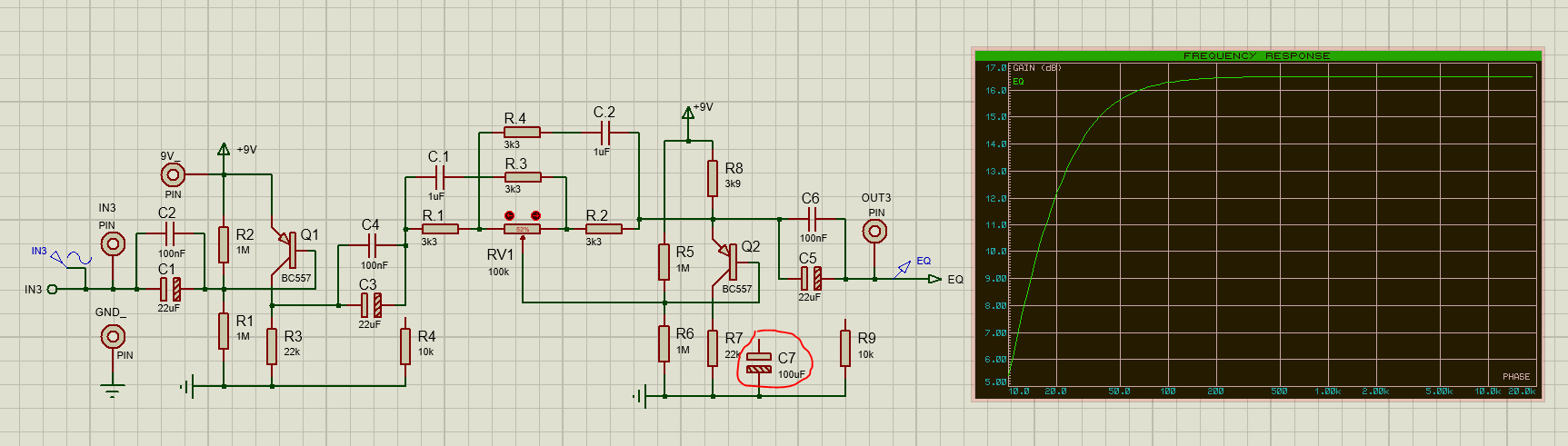

Can I rise the base resistor from 10k to 100k (and the 82k resistor I guess).
Try 47k.
Your schematic shows 3k3 😕There is a Jfet buffer just before the bass boost.
With a ..33k source resistor, for minimal consumption.
So, the output Z is low.

Seems the input impedance of Ketje's circuit is not a problem for the preceding buffer.
And it NAILS it on the simulation (with small values adjustment) !!!!

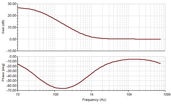

R20 - 50k is the volume pot, as it is connected now. 33k source resistor and 50k load.... It sounds ok as well.
Just wondering, it the consumption could be reduced.
The simulator shows 0.8-1mA.
The double jfet buffer consumes 0.2-0.3mA
p.s. Aiming at gain of 2-3, max 4 (12db).
The need for the bass boost is because it is thin from the source (handmade bass guitar pickups).
Very good mids and trebble, lacking bass...

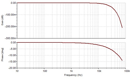

The low consumption version works on 6v (the other not working), and seems to work better... (simulated)
Simulation: 9v supply, input signal 50hz, 2.5v peak
(for both graphics)
(for both graphics)
@Ketje
Adding output buffer (your second schematic) is a good idea.
The output signal clips at 2,5v p-p when I add load.
P.s. the Jfet input buffer is with 33k source resistor and it works with 50k load (the volume pot). The simulator does not show clipping as well. It is allready installed.
But the bjt gain stage (the second transistor) clips. It deforms the previous stage signal as well (the red graph).
I am trying to make it with quite large collector resistors and seems it works ok without the output load

To get both sides clip at the same level, play with the value off R16 (now 150k).With that the voltage on the collector Q6 can be adjusted.
Mona
RV2 reduces the gain - I dont know how much boost I need (mby 6 db).
Indeed, playing with R16 results in symetric clip (2,5 v p-p input)
But, simulating with no load shows no clip at almost 3,5 v p-p input.
So, adding output buffer (under fed, 33k collector resistor) might solve the issue, still with a low current draw?
I will try with your extended schematic.
p.p. I have hard time to follow the BJT design procedure - mby the simulator does not take into account the transistor load line, current saturation and so on?
Not sure if the results are real, otherwise looks good 😀.

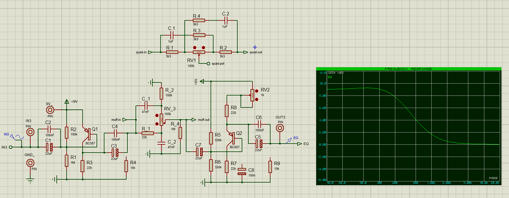

Is the above a Sziklai pair with some feedback (around the cap)?
Cant figure out the value of R17 (the collector resisor of the PNP transistor)
R17 is between the emitter and base of Q6.There is a voltoge on that resistor to make Q6 awake, ~0,6V.Is the above a Sziklai pair with some feedback (around the cap)?
Cant figure out the value of R17 (the collector resistor of the PNP transistor)
So the current for R17 and hence Q5 is 0,6/R17.

Gain is 1 + R19/R18 for the low shelf, 1 for the high shelf.
The -3db point is R19, C15 (high pass, negative feedback).
But R17... the simulator shows the same response in a quite wide range. F.ex 22k - 470k and more.
Dont know what to put there 😀
Max current draw is: (Vcc/2) / ((R18+R19) || R load)
If we have Vcc 9v, R18 3k3, R19 10k, R load 50k
Boost gain: 1 + 10/3k3 = 4; +12 db. Simulator shows ~11db.
Current draw: 4,5 / ((10+3,3) || 50) = 4,5 / 13,3 || 50 = 4,5 / 10,5 = 0,428 mA. Pretty close to the simulator.
R17 determines base current for the output transistor, but cant figure it from specs.
Simulation shows u can put almost anything
