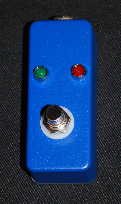

Beyond the pliers, side-cutters, wire strippers, and maybe crimpers that Jean-paul mentioned, there is the whole issue of housing your electronics projects, which needs yet more tools. Enclosures may need to be measured, marked, drilled, punched, cut, and so on.
For this purpose, my set of tools include a centre-punch, set of drill bits, electric drill, a couple of hole-saws and step drill bits, a countersink bit for cleaning up drilled holes, digital calipers (for measuring hole locations and thread diameters), a set of screwdrivers, and a set of small wrenches (spanners to our British friends).
Then there's the matter of finishing. I keep it simple, rattle-can spray paint and primer, sandpaper, steel wool, Scotchbrite scouring pads.
The attached image is a recent simple but useful project, a foot-switch which will be part of a larger guitar-related project I've designed, and am in the process of building. Even this very simple project involved drilling four properly placed holes, and prepping and painting the rather unattractive die-cast Hammond aluminium enclosure.
-Gnobuddy
