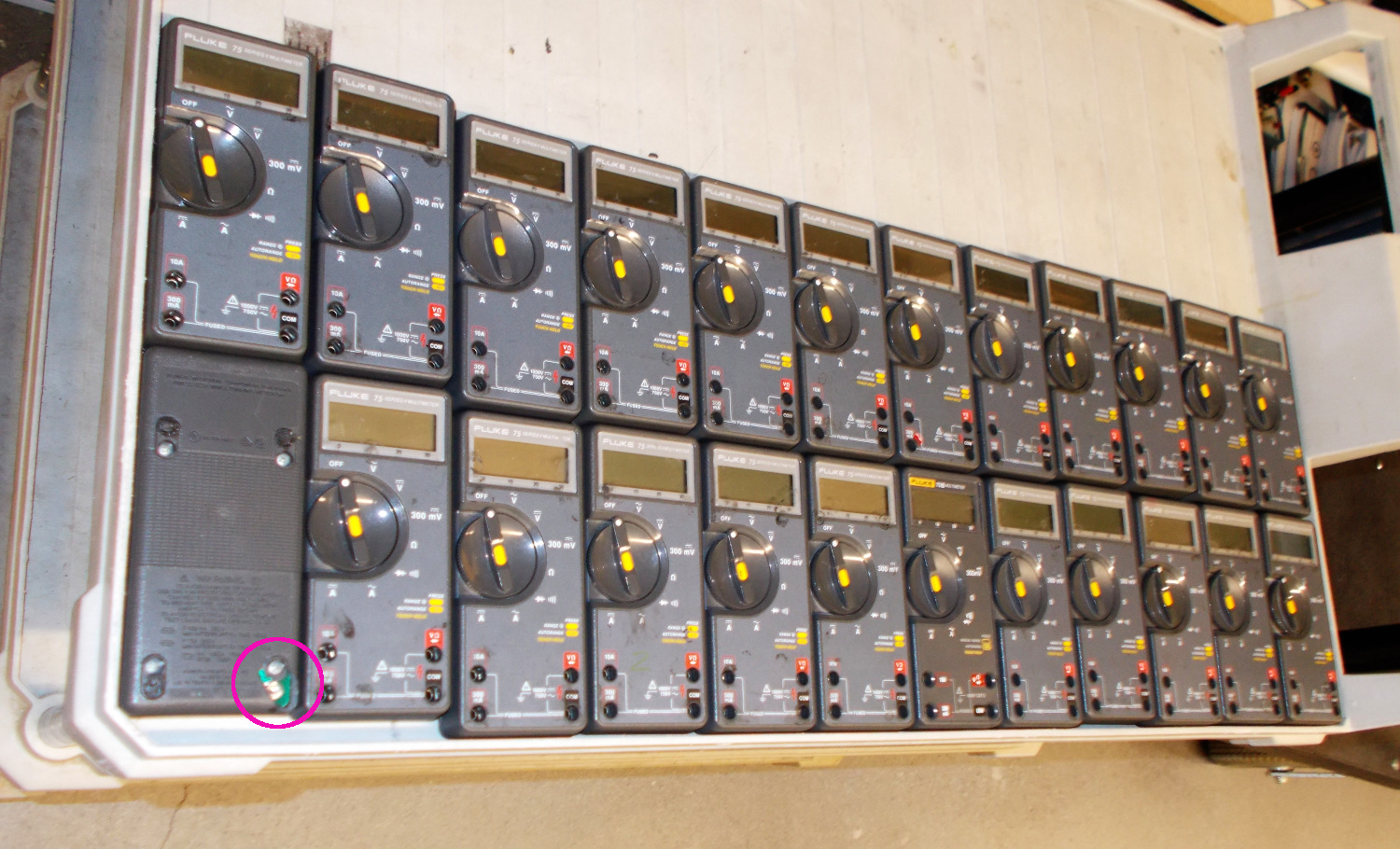

Here are a few pictures, taken a few minutes ago, for your entertainment, of my remaining collection of Fluke 75 meters .
One picture shows all the remaining survivors from the pool of about 40 Fluke meters that came into my care a few years ago.
Many meters broke along the way, and I took those to electronics recycling. This is why there are a lot fewer than forty meters in the photo. The rest broke, became unusable, and got recycled.

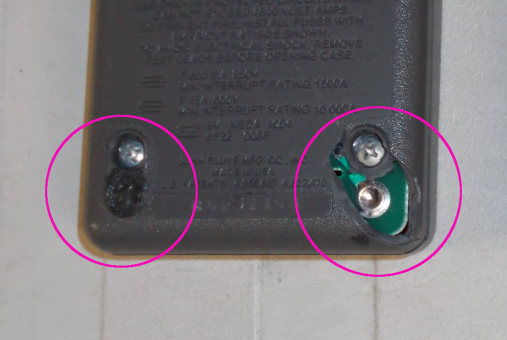

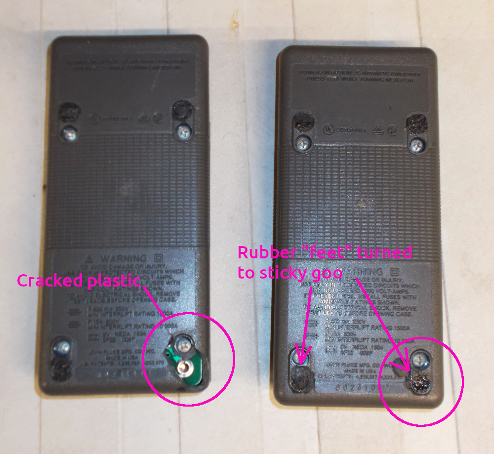

One of the attached photos shows one Fluke 75 which is functional, but the brittle plastic of the case shattered on the bottom of the meter. You can see the hole, and the PCB inside. The case shattered when the meter was simply set down on a wooden lab table. The plastic becomes extremely brittle in these old Fluke 75s.
The black "feet" on the underside of these Fluke meters has turned to a disgusting sticky goo on many of the meters. I've taken a close-up of one for you to admire.

The large number of now-brittle grey Fluke 75 meters I inherited have lived their entire lives here in the Fraser Valley region of British Columbia. It is the most temperate part of Canada, and I doubt the meters were ever exposed to temperatures below zero Celsius, or above, say, 35 C.

Now those are VERY old Fluke meters. I think these were already around in 1991. That makes them 30 years old. That is an age other brands rarely reach Complaining about brittle plastic after 30 years of use seems a bit off.
We got our share of Philips measurement gear that had brittle plastic cases but these were less than 15 years old when that happened.

Now, it's certainly possible that one Fluke meter lasted 40 years, and another one lasted 30 years. However, as my photos show, those extraordinarily long lives are not typical, and very old Flukes are indeed subject to various forms of failure.
In fact, out of the 40 meters in that batch, there are now only 24 ones left. Sixteen of them failed completely (not just cosmetically), to the point of becoming unusable, and were recycled in consequence.
So: I'm not complaining that 30 year old meters are failing. I'm simply addressing the myth that Flukes never fail, even after 30 or 40 years. That simply isn't true.
